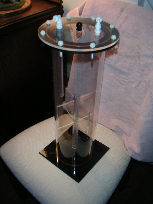

                        I thought of using a V groove bit (for the same reason, strength), just not sure it would work.
                        What I'm building is attached (from one of my other hobbies - reef tanks). You can see the piece in question, the black top. The o-ring (orange) rides in this groove & provides a water tight seal with the top. I'm not sure if a V groove would work - not even sure how I would test it, that would require building a unit & that ain't cheap (acrylic tube goes for over $20/ft) - lol.
                        I think that water would leak under the o-ring with a V groove (at the tip of the V). The material is silicone & gets squished by the top plate....some....but I don't think it will squish into a V?
                        The o-ring is 1/8" thick & the real trick is to get the slot cut just deep enough so that it will sit in without popping out (if it pops out you'll never get the screws in the top lined up).
                        And to further complicate matters the pieces are only .236 thick = I don't have a lot of material to play with (the next thicknes up - .354 - more than doubles the price tag)
