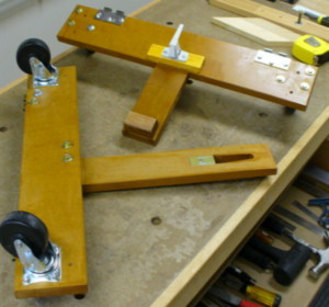

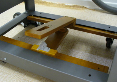

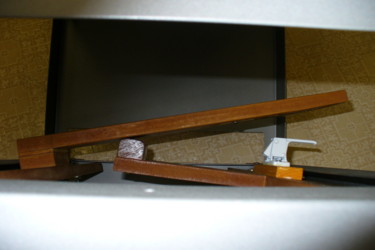

    My version of the "herc-u-lift". After HD in my area quoted me $194Can. for the herc-u-lift, I decide to make my own version for my BT3000. I used MDF, 4, 3" swivel casters from Lee Valley(4.20 each, HD wanted 8.48 for 2.5" casters) 1/4 x 20 nuts, bolts, washers etc, and a screen door catch.
