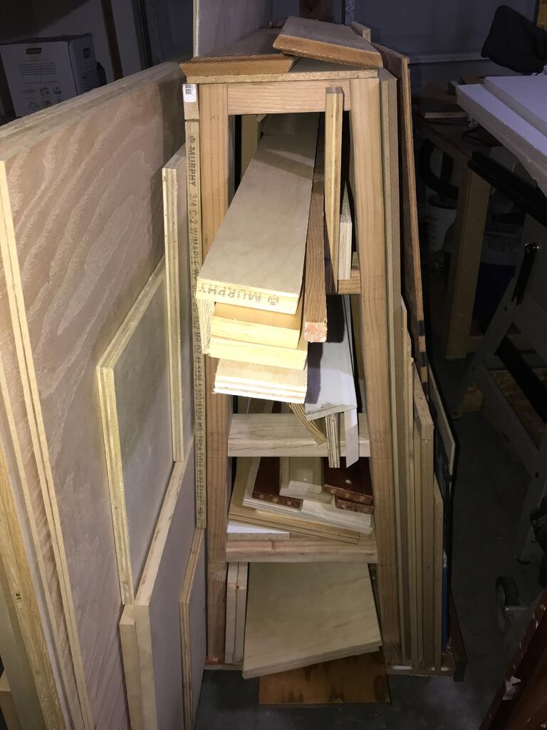

    Starting back slowly in the workshop after the back injury last fall. The shop had been in a very bad state since the injury abruptly forced me into disabled state. SWMBO has been accommodative but not happy of the state of shop which is actually our two-car garage. So, as I start moving around and able to start working, first couple of projects have been trying to build some storage for all the lumber. It has been accumulating and has been leaning on shelves and other objects making it impossible to reach some things.
    So here are two projects completed over last few weekends -
    #1 - A cutoff storage bin
    #2 - A lumber storage cart (Should have taken photos before loading): Our son came to help over the weekend to build this. It was a great father - son project. Really happy to spend time together especially these days when we miss him so much.
    PS - Derived from ideas seen on Pintrest.
