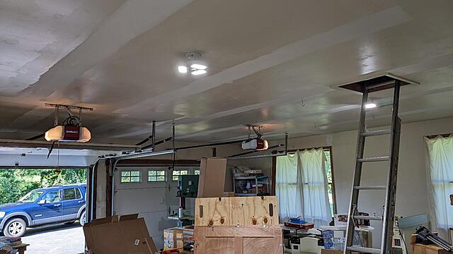

    I know everything is more expensive these days, but I was kind of surprised that the 4' LED shop lights have not gone down in price, but up from 5 years ago.
    I picked up these two screw-in LED lights, and while the picture doesn't show it, they throw out quite a bit of light (8000 lumens). The two pack also costs less than a single 4' shop light.
    I am thinking about adding another 4 lights using just these screw in lights.
    Do you see any downside to these lights versus the standard, plug-in 4' shop light?
    Thanks

    I call them wing lights beause they have three fold down aimable panels.
    I think they work pretty well. I have two of them augmenting my 4' shoplights. They are in the original edison base sockets that are controlled by the wifi wall switch so I can go wing lights only, shop lights only or both if I need a lot of light.
    The wing lites are on the wifi wallswitch, and the shop lights on a circuit I added also on wifi.
    So I can command wing lites, shop lights, garage lights (both) and garage (both lights plus air compressor). But can also turn the wing lites on or off from the wall switch manually. For my wife.
    At night, when I go to bed I often say turn off the garage to shut down anything I left on.
    As for 4' light prices, I buy them when I see a good price. they don't match, but that's OK ( I do match the color temperature - about 4000 K.) The last one I bought was a HF unit. The one before was a bypass tube, I modified a failed unit I took out of service. So I have two spares ready to replace any failing T8 unit. That alone makes the T8s last much longer (Murphy's law). The last T12 unit went out a couple of years ago. I think there are 7 total.

      Hi Loring, My first impression and from many other reviewers is that these wing lights do get hot. I'm wondering how that affects their lifespan. How long have you had your wing lights?
        LCHIEN commented
        You said yours was 8000 lumens which is pretty bright. And in a comment further down you said draws 80 W which is also a lot. But matches the light output.
        Mine are The Beyond bright which claim 3500 lumens and 40 W. So yeah, yours are going to get hotter than mine, IIRC, mine got a little warm but not to where you couldn't touch it. The power was spread out over the three wings so 13 W each which had a metal heat sink base for each wing, IIRC. See post #5 in this thread for a pic.
        I don't see mine as a reliability problem level of heat.

      I have had one wing light for about 18 months but don't use it often. Another one about a year and use it regularly in my shop. Because it is in the ceiling I don't know how hot it gets, but It does not get hot in my shop while I am in it as I have the AC on.

        The specs say each light uses 80W. The LEDs are more condensed than a shop light so it makes sense they are hotter feeling. I adjusted one of the wings after installation and it felt almost as hot as touching an incandescent bulb.

      Heat sinks on Beyond Bright wing lights
      Click image for larger version  Name:	image.png Views:	21 Size:	259.6 KB ID:	852177
      These claim 3500 lumens and 40 W. So its about 13 watt per wing panel. THey get warm to the touch but not uncomfortable, about the same as a 12 Watt 60-watt-equivalent LED bulb.
      ATCGPaul, if your light claims to be 8000 Lumens and 80 W that is about twice as bright as mine and twice as much power. If it has 3 panels or wings, they will be dissipating twice the heat per panel than mine so uncomfortable warm might be reasonable.
      Heat always decreases the life of electronic components.
      Its said that every 10°C or 18°F rise in temperature cuts the life in half. 20C/36F rise would cut the life in 1/4 and so on.
