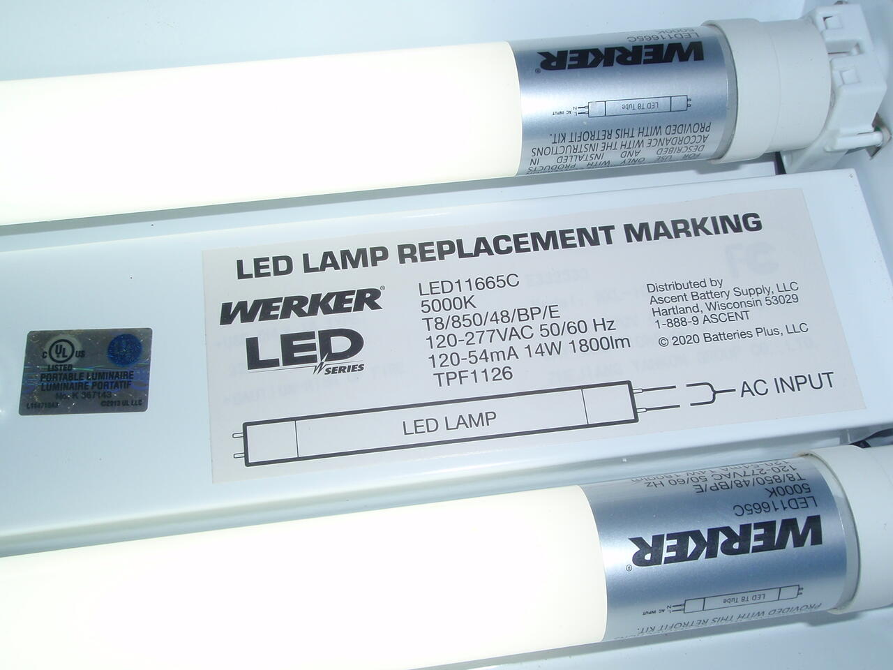

      That HD unit is Feit. Costs $16 and has an output of 2000 lumens per tube.
      The one I got today from Batteries Plus Bulbs is a "Werker", costs $8 and has an output of only 1800 Lumens per tube.

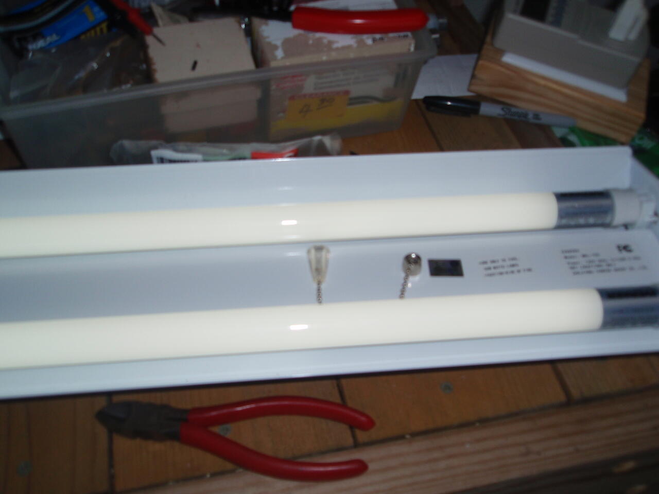

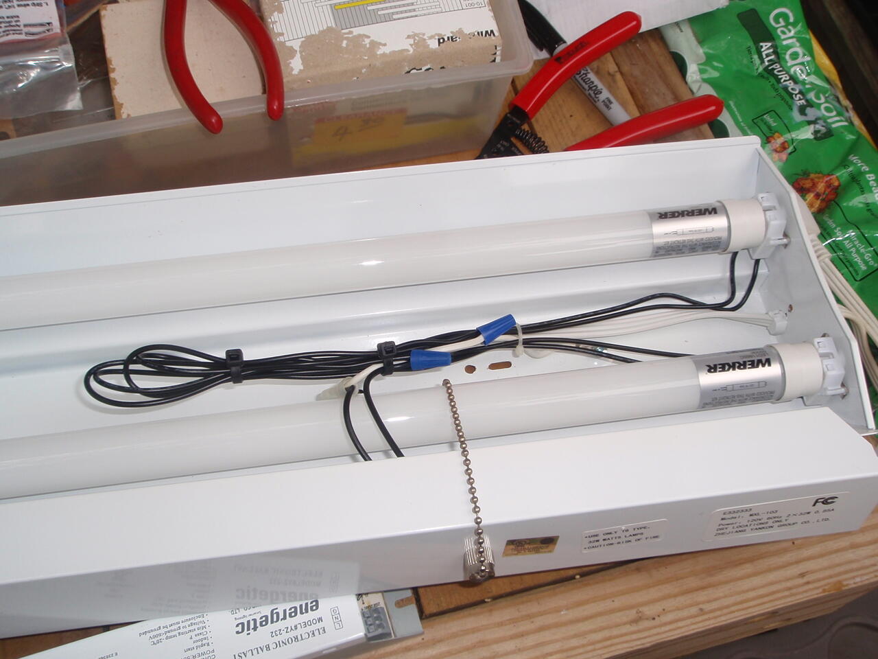

    So I decided if I could make a conversion cheaply I would keep the unit for a backup. The top came off with three screws and showed it would be easy to rewire. The LED fixture I bought cost $34. So when I found I could get bypass conversion tubes 2 for $16 I was go.

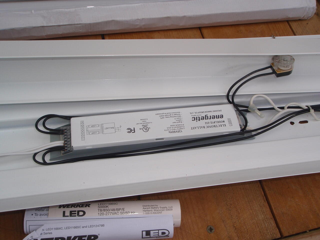

    So today I have the new tubes, take the cover off, remove all the wires and wire the tombstones from one end to the power switch and Neutral wires with two blue wire nuts, all in about 5 or ten minutes. Ready to turn on.... dead.
    Get some tools - KAW power monitor and DMM. We have voltage and the unit is not drawing power. The tombstones openings are too small and can't get the probes in to check for voltage so I literally have to disassemble everything to get places to check.

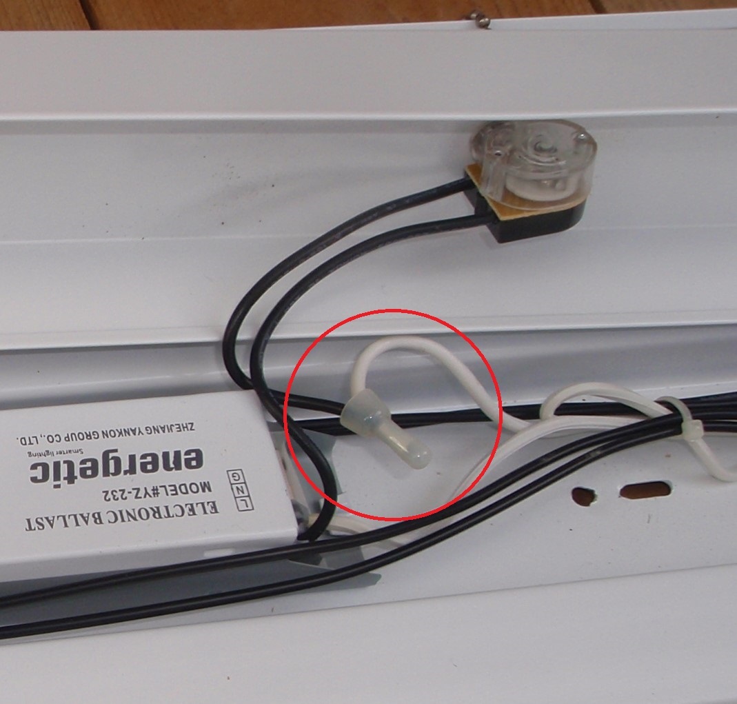

    Long story short, I had to check every point in the thing and cut some wires and open all the connections to the individual parts to eliminate the cord, the switch, the tombstone connectors. Here's what it was:
    Click image for larger version  Name:	P1110634.JPG Views:	0 Size:	169.5 KB ID:	847362
    Yes a stupid crimped wire splice from the factory. became intermittent after years of use then simply went completely open in the span of 2 weeks. From here:
    Click image for larger version  Name:	switchP1110627crop.jpg Views:	0 Size:	161.3 KB ID:	847357
    It was in series with the switch connecting the line in with the switch. If I had to bet on all the parts being bad the crimp would have been the last lowest likelihood with maybe the exception of a piece of wire going open. And this crimp had worked for 5-10 years and just decided to become intermittent.
    Anyway It took me another half hour to an hour of puzzlement to sort that all out what should have been a 5 minute job.. And I think but did not confirm that the ballast is probably OK. I didn't feel like putting it all back together to original state to check. They even gave me a new label.
