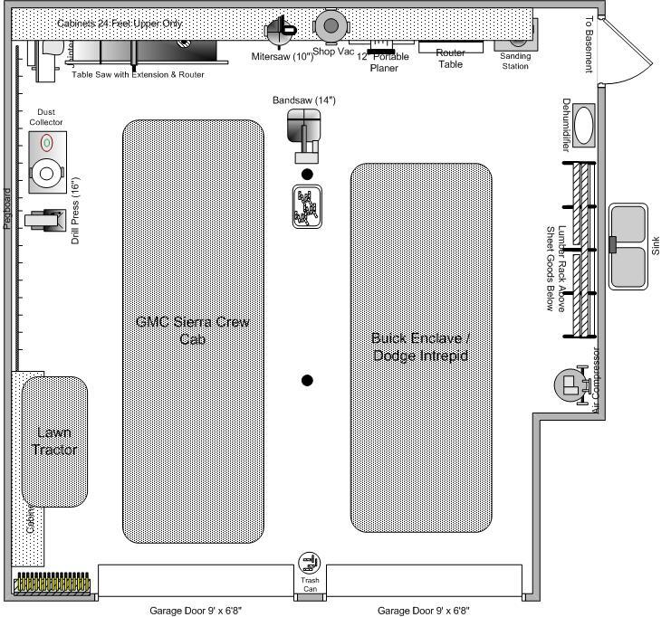

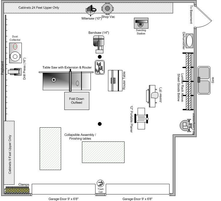

      I used to have to deal with getting cars into the shop, using the garage as a shop depending on whether you talked to me or my wife. I kept most of my tools stationary and had them along the outside wall. My table saw were on wheels along with some of the other stationary tools so those were the things that got rolled out to the center of the garage when in shop mode. For me it was just a matter of finding storage positions and working positions for each tool.
      I used old banquet tables as a work benches because the collapsed and could be stored in very little space. I later found space for an ultimate tool stand as well.
      It used to take me about 15 minutes to set up the shop, and half an hour to 45 minutes to tear it down.

        atgcpaul commented
        What kind of mobile base do you have under your TS? I think I have a Shop Fox under my Grizzly, but it's not very mobile. My TS also has the wide table to the right. I always had the feet extended so it wouldn't slide during use and to level everything out. That wasn't an issue for your base?
        My garage is supposed to fit an extended cab truck, too, but I haven't seen it in a year so I forget how things look in there. I do have a lot of nice windows on the left which is where I planned to locate the "shop" and keep the right side of the garage for parking.
