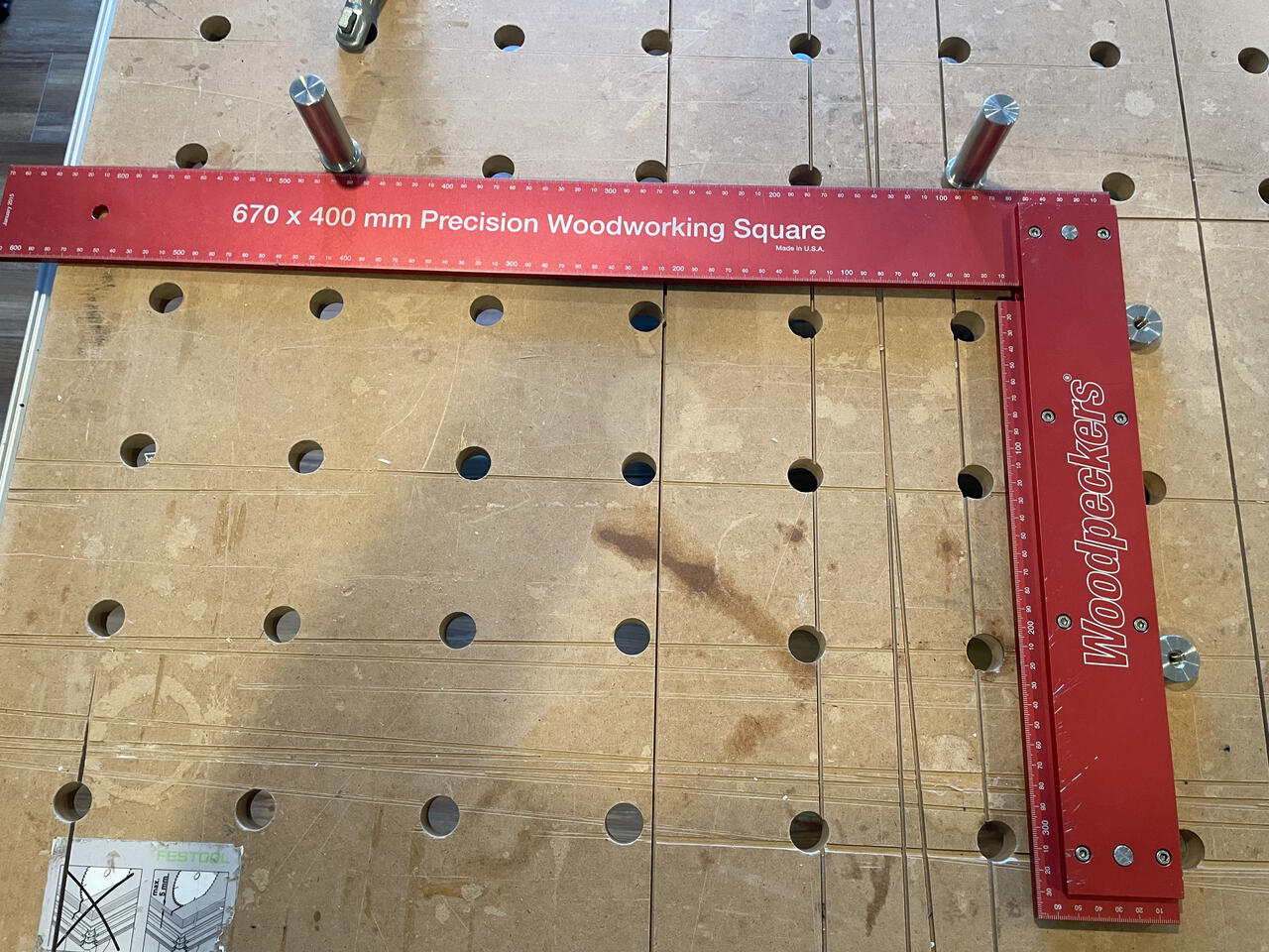

        The first is that the holes are on a perfectly square grid so that with a few bench dogs, I can lay out face frames, drawers, whatever and know without a doubt that if they are against the dogs, they are perfectly square. I also use the squareness to set up the fence and rail for my track saw

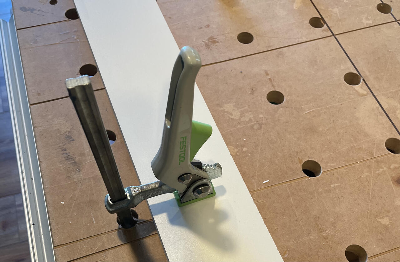

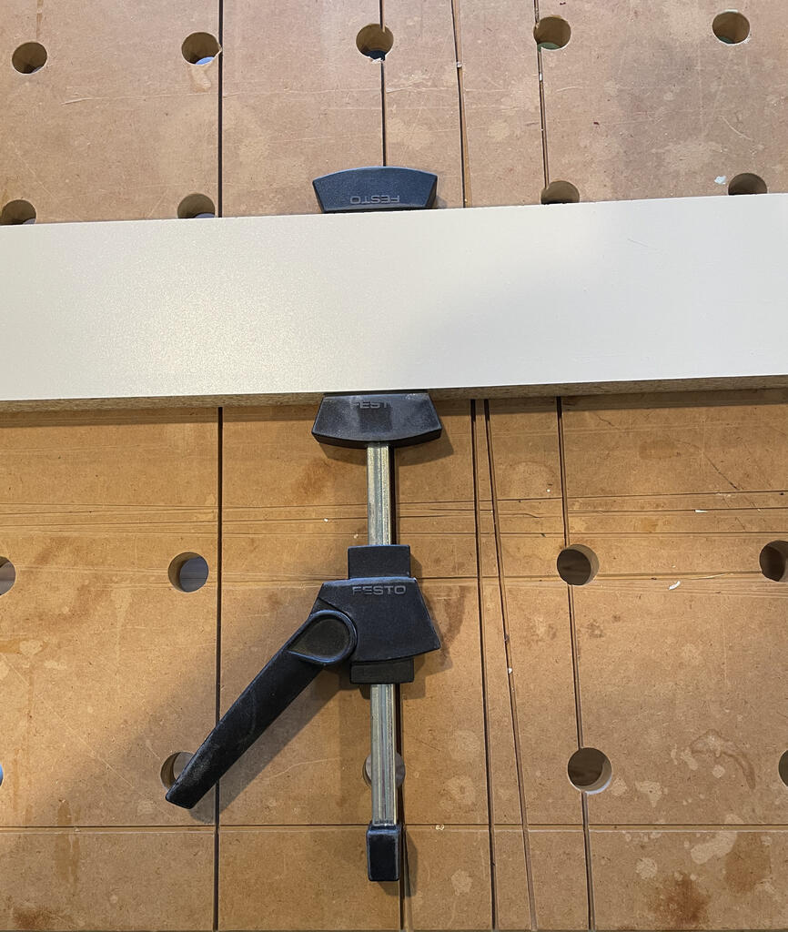

        The second thing is the different clamping elements available. Festool has a bunch of different clamps that work with it, Traditional F clamps that drop through the hole to clamp stuff to the surface, and the ones I use the most are the edge clamps that are < 3/4" high so I can clamp 3/4 stock to the surface and sand the entire piece without moving the clamp. By using a couple of the clamp blocks I can secure odd shaped or round objects to the table as well.

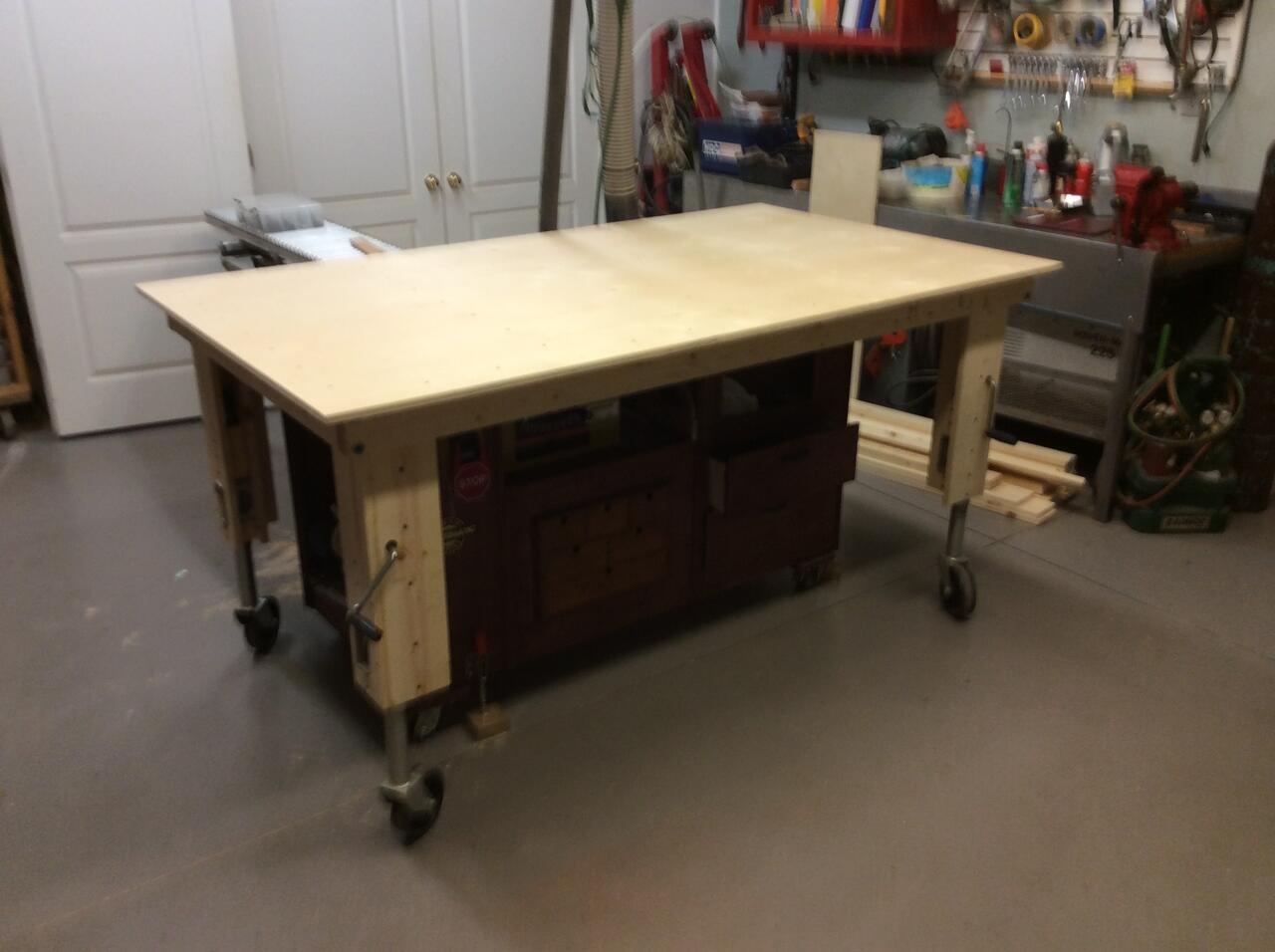

ID:	844189 My outfeed table is built for different needs, but some ideas could be use on your build. (the outfeed table is designed to jack itself up so it can straddle the table saw, allowing both to be rolled into another room in my shop, saving me a lot of floor space in this room. Then I am able to bring in automobiles, boats etc for repairs or do welding and metal fab work.) this is not what you are looking for, but it is definitely mobile, and the height easily adjust to any heights it might be need to use as an outfeed table for. Adding the Festool mft style table top would not be a problem, and building a cabinet base for storage is a given. I like that it’s height capabilities are endless, it seems that even though all of my tools, tables and cabinets are “supposedly” the same height I always have to make some height adjustments for an outfeed table to match up!

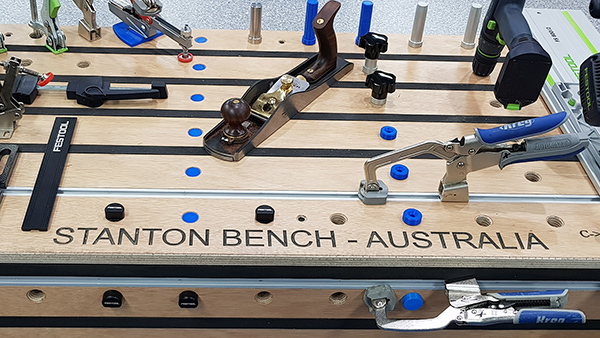

                And yet another option is build a more traditional bench and use the Stanton bench on top with it when you need a mft style top.
                https://www.youtube.com/watch?v=bHHfaE0RjOk
                https://www.stantonbench.com.au/prod...nch-plans-mk2/
                Click image for larger version  Name:	stantonbench-web.jpg Views:	0 Size:	159.9 KB ID:	844194
