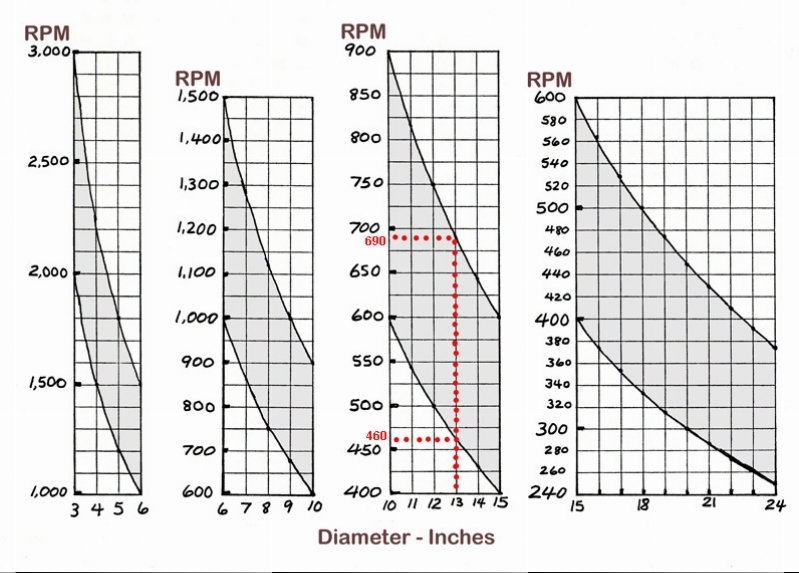

                          • 8807
                          Bill posted this chart some months ago concerning Lathe Speed in accordance to bowl diameter:
                          Click image for larger version  Name:	Bowl lathe speed.jpg Views:	1 Size:	251.7 KB ID:	830398
