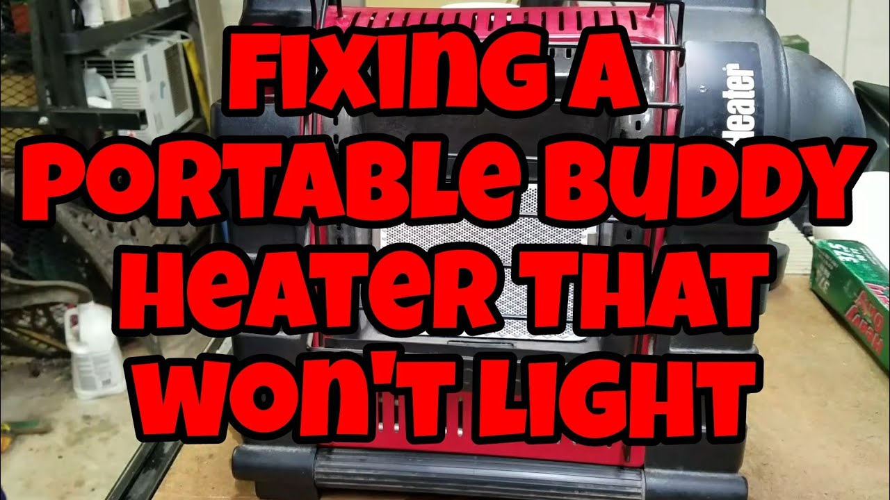

    It's been a warm winter here in Texas, so this really has been not needed, but I was in the mode of fixing, cleaning and testing equipment, including all my propane and white gas fired appliances, and I found the pilot on the Portable Buddy heater wouldn't work. I did some research on the Mr. Heater site, and found the recommendations from Mr. Heater on how to fix it... For what it's worth, I did the video for a specific youtuber that has had problems with several of these over the years and he keeps replacing them. I figured this would help him.
    Anyway, here is my fix video on it. Hopefully it helps somebody here....
    https://youtu.be/8CqW0HT_7VQ
