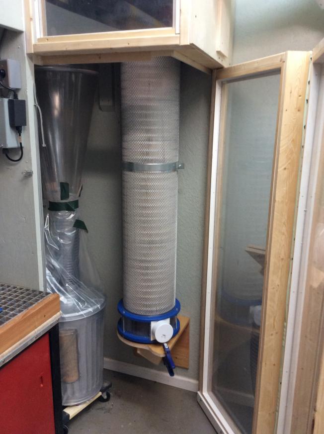

      Any idea why the collection drum is in a trash bag?
      Why is there a clamp in front of the filter clean out port?
        #33
        My guess for the trash bag is to conduct a leak check. If there's leaks below the cyclone the bag will get sucked in.
        I've got no guess on the clean out port.

            Leak Check?.......Exactly. I questioned the debris that continuously spun around inside fhe cyclone. All the forum research i read discussing this the "experts" said was caused by vacuum leaks below fhe cyclone in fhe trash drum. Mine always has debris spinning around and to see if it was caused by a trash can leak i bagged the whole thing. No leaks, and stuff still spins, so the experts need fo find another reason for fhis.
            Now, why is the clamp on fhe dust filter clean out?

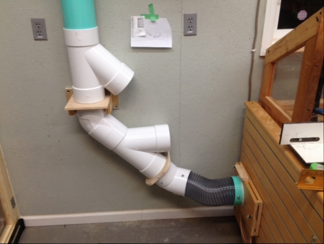

              Something that I just noticed on your setup is that you have an immediate branch from your cyclone to your band saw. One of the principles that I am using in my setup is:
              For maximum efficiency, particularly with a cyclone, provide a straight run at least 4' long at the entrance into the dust collector inlet. This keeps the incoming air very smooth making for far better material separation and improved efficiency as turbulence kills efficiency.
              When the "dust settles" (pardon the pun), you may want to consider a modification in your routing, somehow returning to the band saw from duct work further away from the bandsaw.

                Perhaps you have turbulence because of the immediate branch to the bandsaw??? See my previous post. The "wye" near to the cyclone intake may be creating the turbulence.

                  Slik, I agree, the turbulence may be caused by the close proxemity of fhe first wye. My table saw is in an adjoining room about 30 pipe feet away, with connections for my drum sander, planer and jointer, and when they are operating I can see no difference in the turbulnce. It may be caused by the wye actually being that close and not having enough straight in feed. I suspect it is just the characteristic of the machine pulling that many cfm, it is not possible to see what other cyclones are doing made of steel or plastic, they may all be this way! Most all of the online photos of others Clearview installations have all kinds of quirky piping close to the inlet, few actually have a long straight pipe feeding the cyclone, so it must not be a big deal. Another reason for the turbulence may be the filters are still fresh and clean, unseasoned as they say, allowing the blower to pump a lot more cfm than the design cfm. and the turbulence may be reduced as they season. I have noticed that when I open several blast gates the turbulencd lessens, but the cfm at the desired tool drops dramatically as well, so whats the point. I bought the machine to suck up fhe dust, not watch the trash spin around inside the cyclone, so as long as it works well im happy with it.
                  I do have plans for 2 more branches on my duct piping and will possibly move the band saw, but sliding miter saw is where it needs to be so it can have plenty of room on both sides. It will require a lot of piping to duct back to the slider if I move this wye to give the necessary straight pipe to the collector, so that probably won't happen. To explain that, The above photo (no mattter what I tried, i couldn't put it in this line, so it stayed at the top where the server wanted it!) shows the piping that is behind the bandsaw and to the sliding miter saw. The top wye is to the 6" belt sander, the 2nd wye is to the band saw. What isn't shown, and is the reason this piping is where it is, just to the right of the down piping is a thru the wall air conditioner, and to the right of the AC is a window. There are obstacles on the ceiling that mandate where the piping can and can not be located, like lights and a pull down attic staircase.
                  A note about the filters....... they have such a large open area and are creating so little back pressure now that if you remove fhe cleanout cap in the dust collection box with the cyclone running, hardly any air comes out! The cleanout cap is a loose fit and it won't even blow the cap off. Thats the reason for the clamp, there is no fastening mecanism on the cap to prevent it from blowing off as the filters clog, and i dont want to have to clean up that mess when it does. The clamp is fastened about 1/2" from the cap so i can see if it has moved. (Thats the asnwer to my second question)
                  I've already emptied my trash can one time, probably 20 gallons of sawdust, chips, pencils, and fine dust, but I have not seen any dust at all in the filter cleanout bin. Maybe the filters are holding it, whatever, it is not making it to the bottom. When I have time I may give it a good blowdown and see what falls out.
