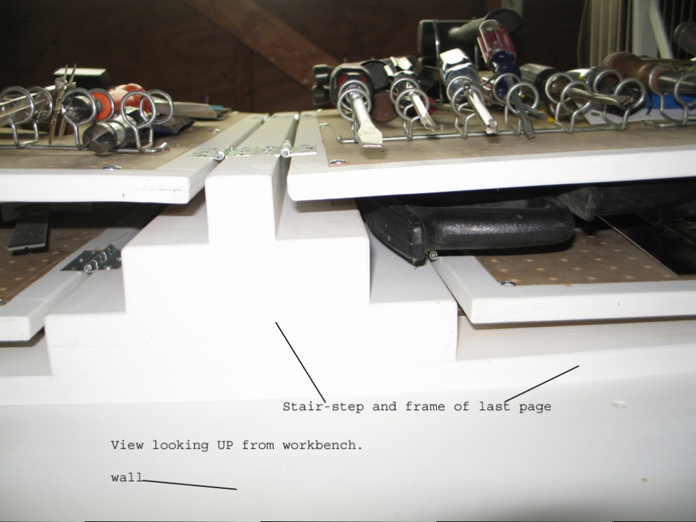

      For small hand tools (chisels, screwdrivers, hand saws, marking gauges, mallets, etc) I do in fact use pegboard and it works well for me. I made a pegboard "book" on the wall above my bench rather than having just a single pegboard panel. Imagine making a frame from hardwood, putting rabbets on both the front and back, and fitting pegboard panels into the rabbets. That's one panel in my setup; I have several mounted to hinges which in turn attach to stacked 2x4s as spacers. Thus I have far more square feet of pegboard area compared to the amount of wall area. I made this thing years ago with the 1/8th pegboard which is now hard to find - most pegboard sold today uses 1/4 inch holes. Many pegboard hook kits claim to be compatible with both 1/8th and 1/4inch pegboard... they'll be stupid loose in 1/4inch pegboard holes without some sort of extra locking hardware.
          I've considered doing something along those lines, but I'm not quite following the stacked 2x4s. Could you post a picture?

              Okay, pics from a year or two ago. I've re-arranged the tools (now that I have some nicer hand saws) but the gist of the book page idea is readily visible. First pic is how the assembly looks on the wall. You'll notice some unpainted hinge mortises visible... I removed a center page to get more space between the remaining pages. That's the big oops of my implementation - I didn't leave enough gap between the individual pages.
              Click image for larger version  Name:	Wall_Storage_2782.jpg Views:	1 Size:	448.6 KB ID:	828729
              The back pages are screwed directly to the wall studs, the stair-step is made from 2-by material attached to the back pages. All other pages hinge from the stair-step. Because of the steps, the pegboard pages get a little wider from back pages to top/outer pages; this way the sides line up.
              Click image for larger version  Name:	Wall_Storage_Stair_Step_view_2785.jpg Views:	1 Size:	383.7 KB ID:	828730
              As I noted in my earlier post, I use pegboard with 1/8th inch holes. Pegboard hooks for 1/8th pegboard use thin enough wire that I can bend the long straight hooks into gentle arcs to support the mallets on the far left. I use two of the medium-sized "J" hooks to hang small hand saws from, supporting the saws by the wood handles so the blades don't contact any metal bits. (e.g. the vertically hanging hand saw below the "Eclipse" branded coping saw) The large hand saws (home center style saws basically) came factory equipped with 1/4inch holes near the tip of the blades to hang from nails or whatever so I use those holes with small pegboard "J" hooks.
              I've totally re-arranged the tool layout since these pics were taken; it's a lot less cluttered/messy now. And I bought another two sets of the Stanley hooks I mentioned earlier so I can hang more tools properly/cleanly. In these pics, some of my tools & saws are stored in the plastic case that came from the stores... the same cases that let them hang from typical store display pegs. (e.g. the saw just to the left of the Eclipse saw... getting it out of this package to use the saw is a pain.) With the new Stanley hooks, that saw no longer lives in the package and is readily usable.
              I've made small blocks with holes drilled part-way through them for things like marking knives that don't fit any normal pegboard hook; chunks of coat hanger wire bent into "L" shapes are stuck into holes in the back of the block to hang the block from the pegboard. One could use coat hanger wire to support almost any wooden tool rack: a thinner board with holes all the way through for chisels and screwdrivers, a long block with a saw kerf sized groove to support hand saw blades, etc.
