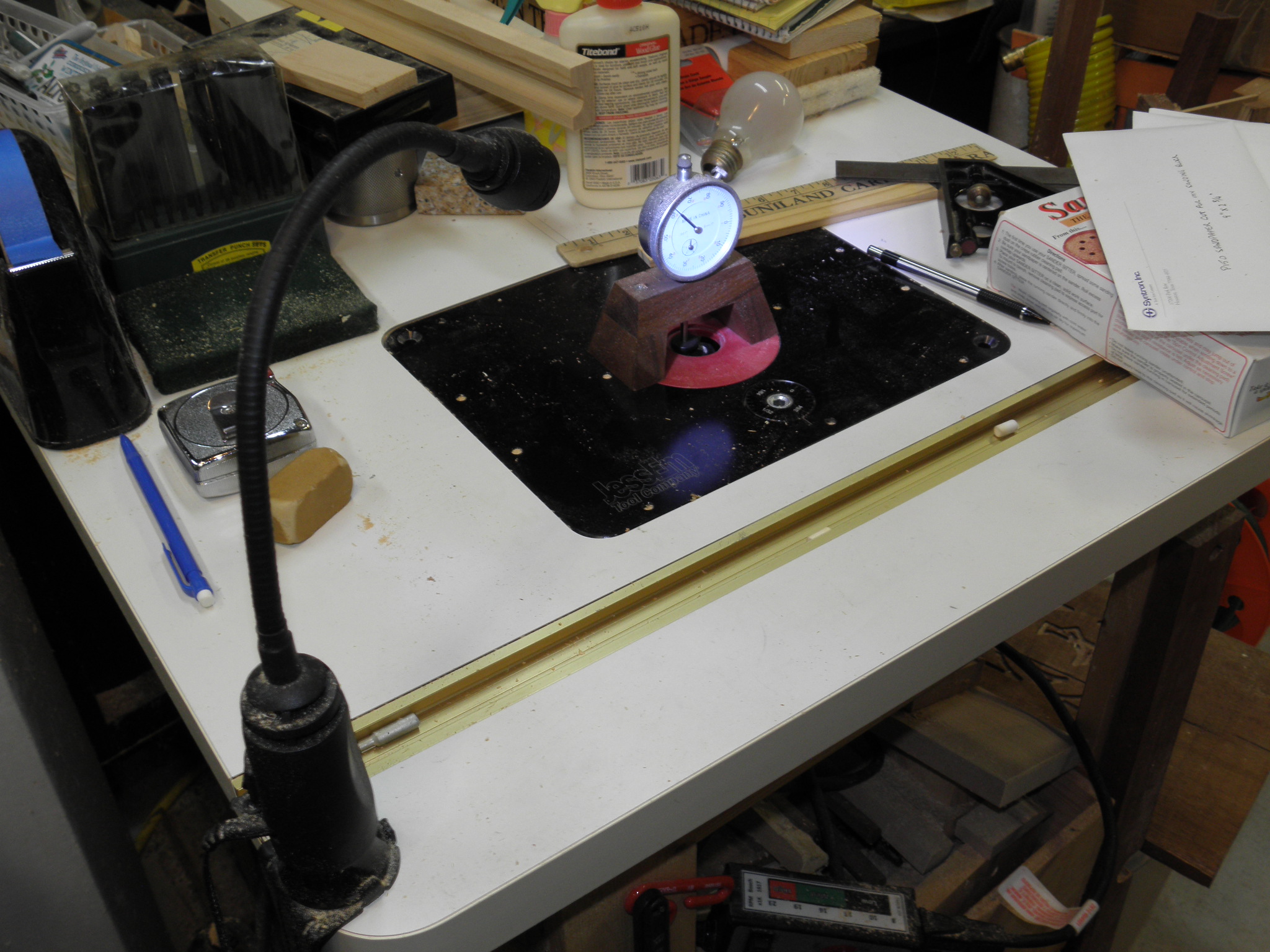

              Originally posted by dbhost
              I am thinking about picking up a couple of the magnetic base goose neck lamps like the one Rockler sells http://www.rockler.com/magtite-base-work-light one for the band saw, one for the lathe. Everything else has excellent light on it...
              Dave, As an alternative You might look at some LED task lighting. I picked up one I think from Peachtree at the woodworking show last year or the year before that I don't see in the catalog, but you can search Amazon for "LED task light gooseneck" and find some AC powered ones. The good thing is that they're cool (frequently close to your head) and the head is very small so that its not in the way, and the new ones are pretty bright and the LEDs are focused in the right direction instead of having to work with the large reflector.
              Mine is AC/battery operated and you can get a variety of C-clamp, magnetic and drilled hole mounting options. Its very light, I keep it on the corner of my router table when doing small projects and remove it when routing bigger objects that need to swing over the entire table area.
