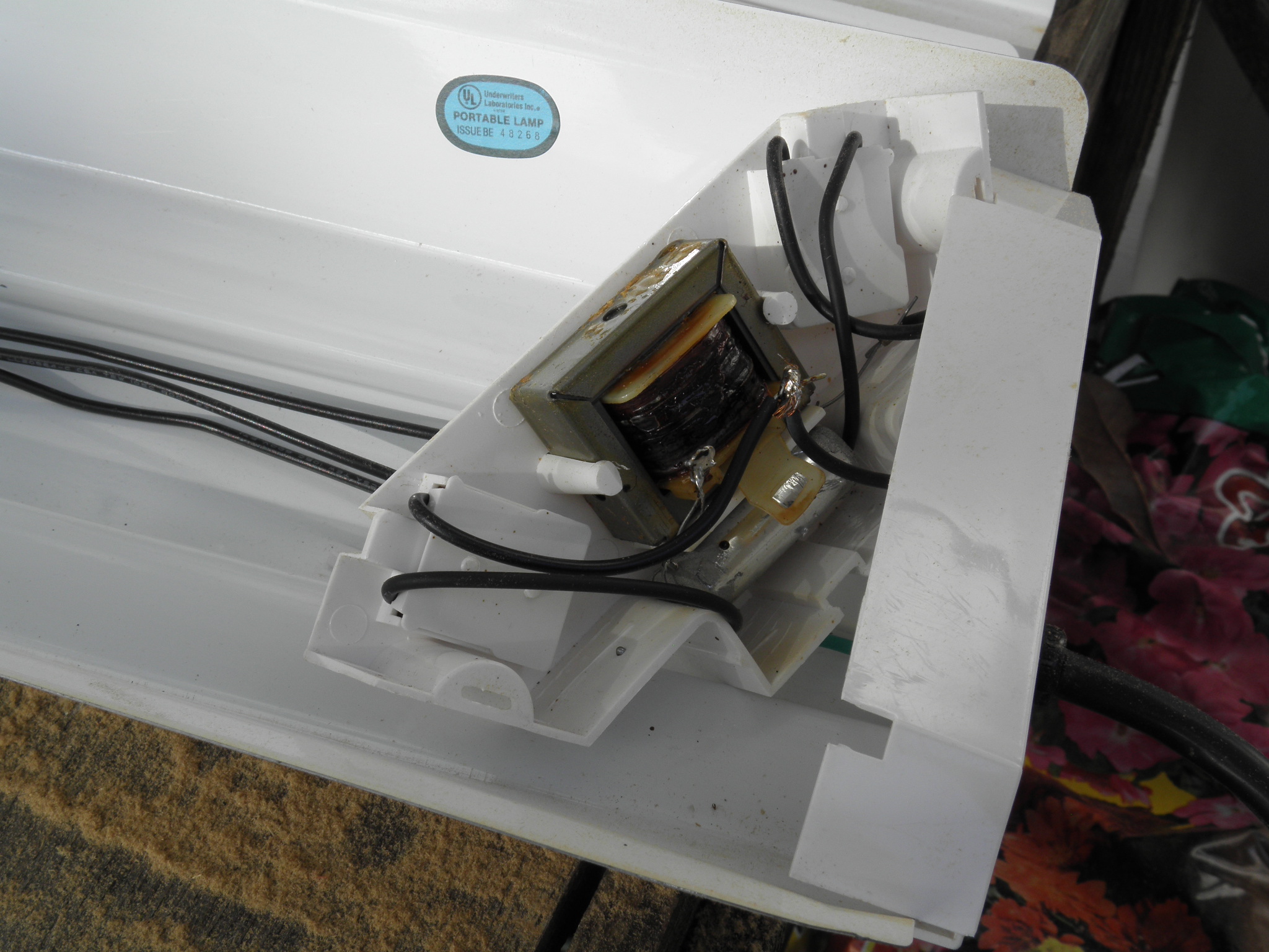

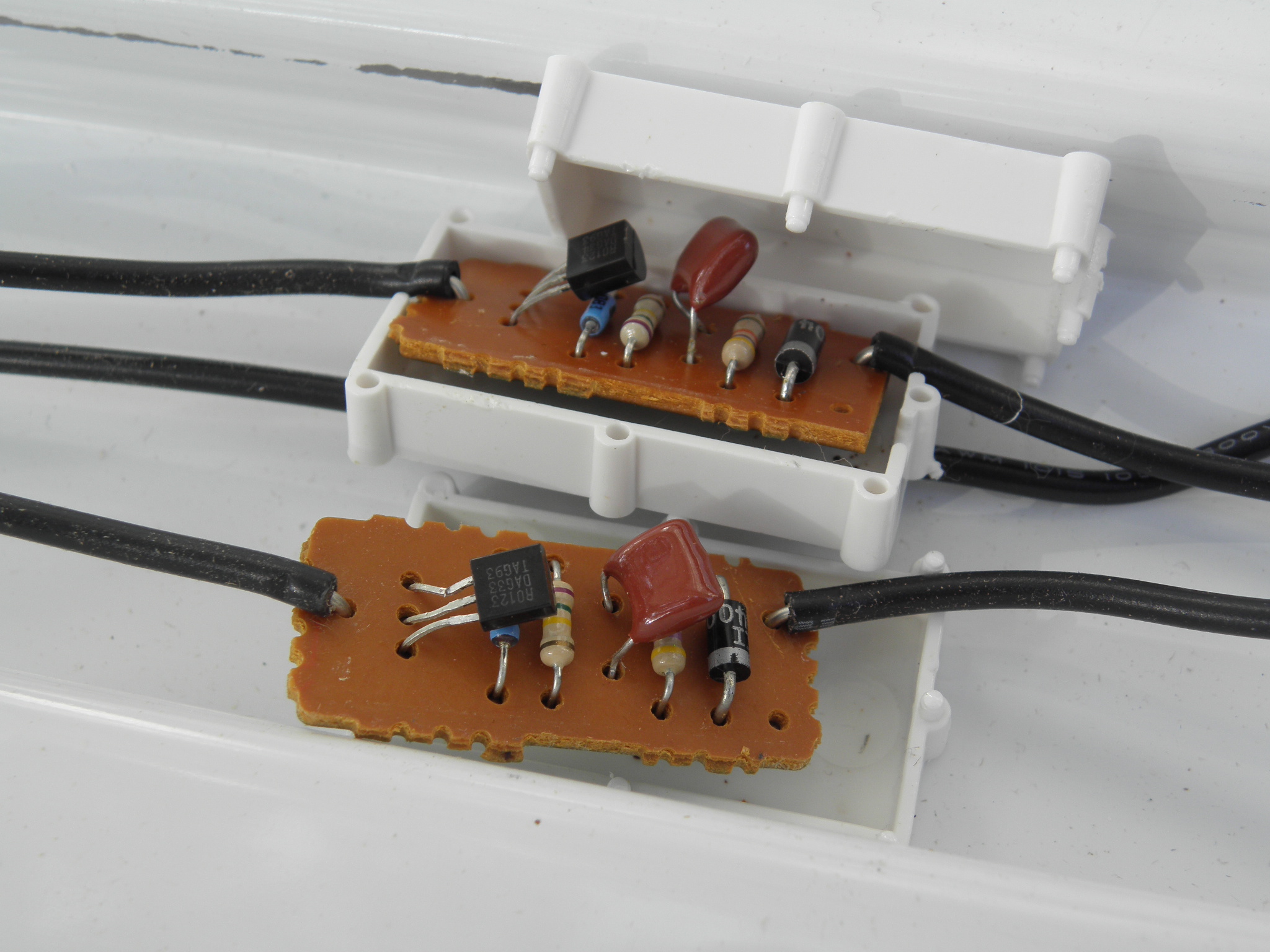

                      they can't be converted, they don't have a normal ballast. They have a shallow wiring channel down the middle and some electronics and transformers in the ends which are about an inch thick integrated behind the "tombstones". They're really cheap fixtures. There's no place to put a ballast like I saw in the U-tube videos.
                      This would be ugly to try and convert.

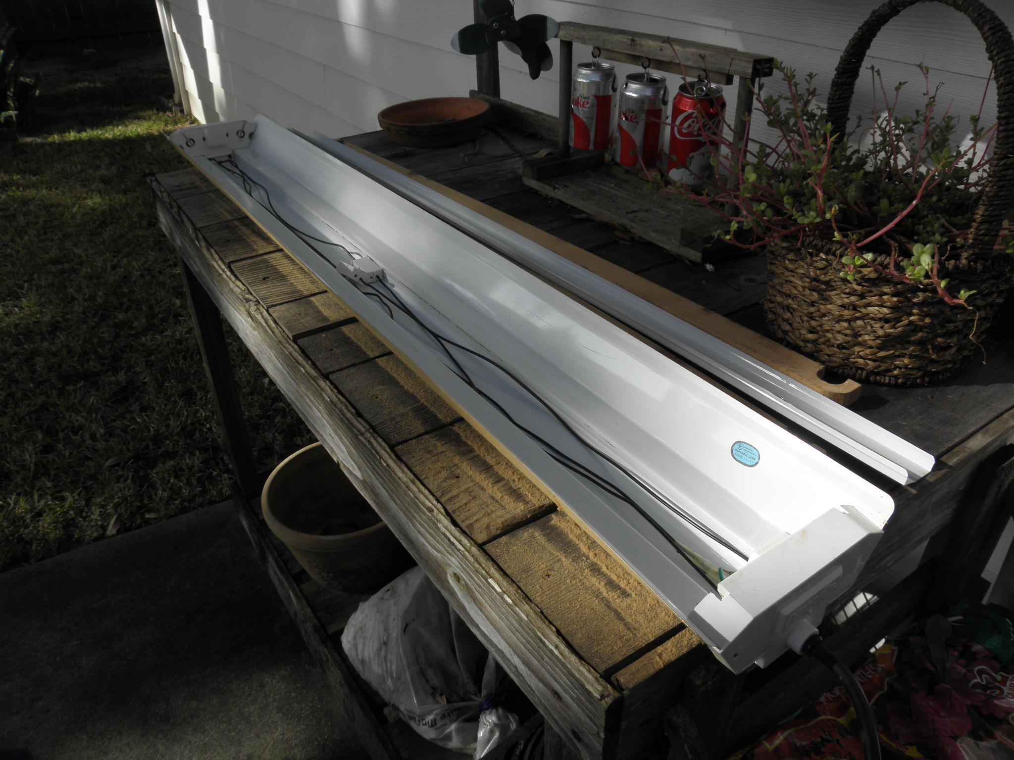

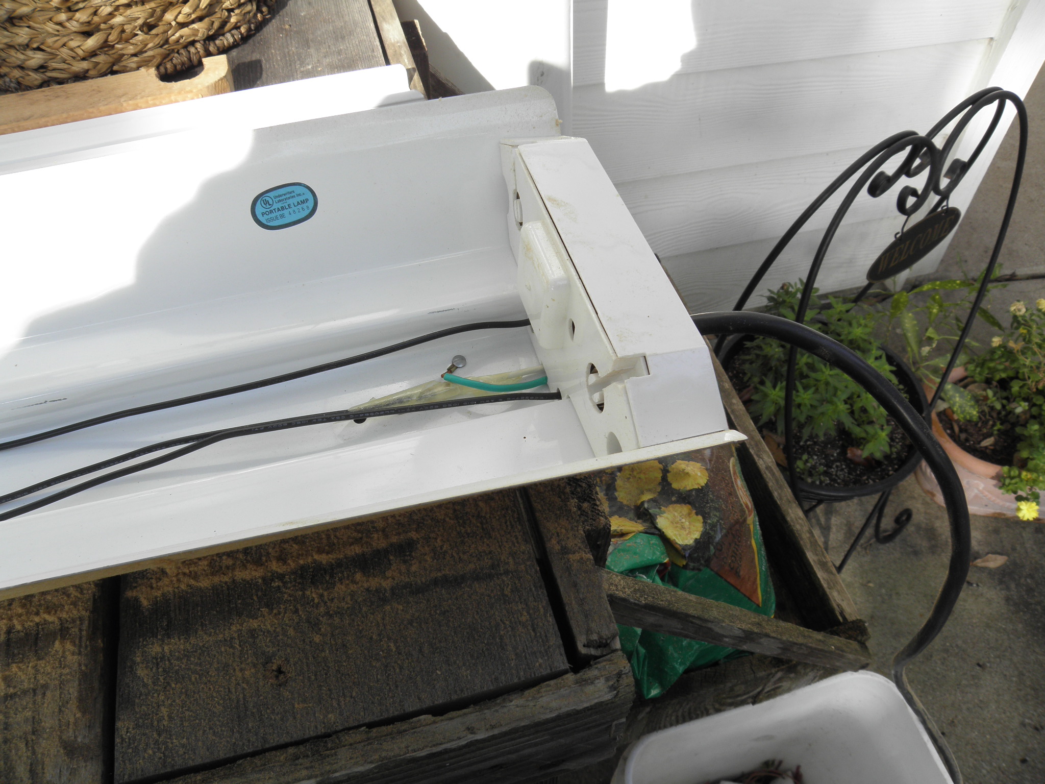

                      The present fixture hang on chains, I can change them in 1 minute after I get the ladder set up. I'd have to take them down either way (swap or convert). Postmortem pictures below (click to view larger). The little electronic modules (3rd pic) are in the dead center of the fixture (first pic). The end caps have a choke and a capacitor (I think). Broke off the locking tabs (no screws) to get it apart so it probably won't stay together real well if I reassemble.
                      Yeah, CW, those are $8 or $10 Lights of America (LOA) fixtures model 8040 from the box stores a few years back. These only take T12 bulbs according to the CSA certificate online. Later versions model 8040xx 8045 and 8055 can take both T8 and T12 bulbs.

                            Looking at the LOA lamp I just dissected, its the cheapest, crappiest type of everything in that lamp bought from the lowest bidder in large quantities, I'm sure. Soldering and crimping is just plain ugly. How they can sell it for $10 (which means they must make it for less than $3) is amazes me.
                            Says something about labor rates, too, when it's cheaper to hand stuff a through-hole board that machine assemble a surface mount board. I can't remember the last time I saw a board like the ones in your photo.
