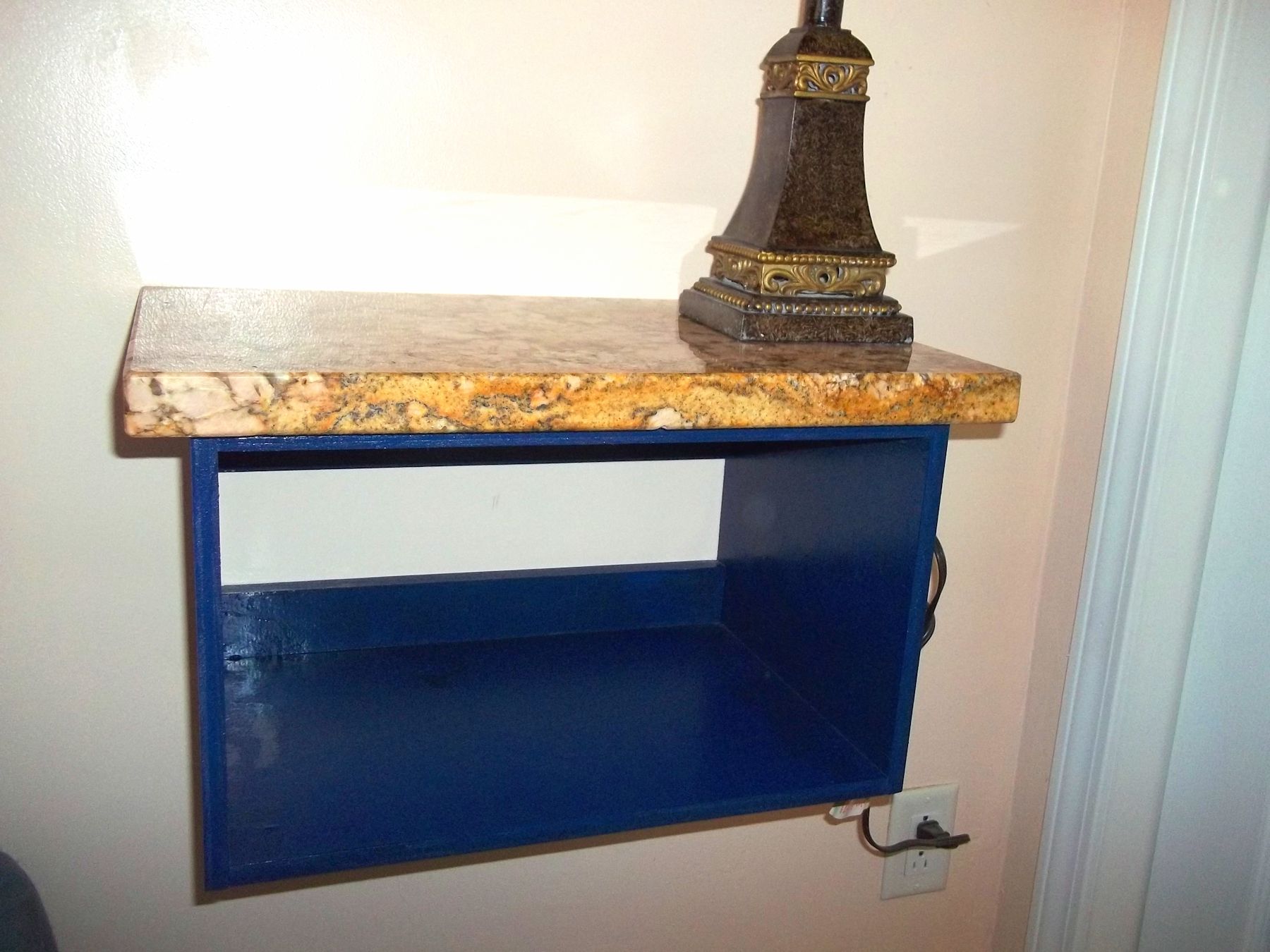

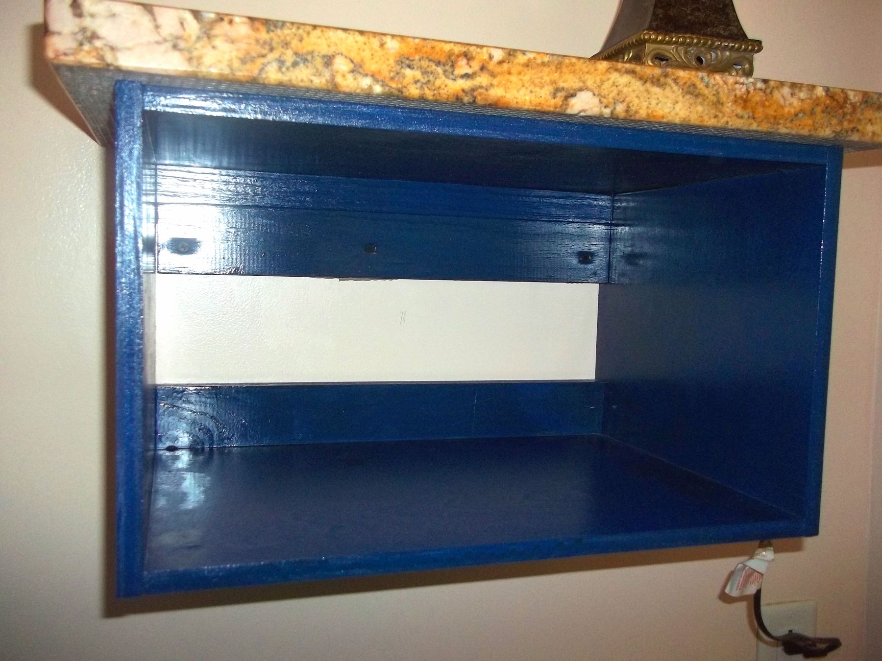

                I did a couple quick and dirty french cleats recently for our floating night stands. Similar to BW's rack. The cleat isn't as wide as the cabinet, but only as wide as the insides of the sides.
                We had some Granite left over, so I sliced it in half, which made the perfect size for our use. I did something similar, but nicer years ago in our guest bedroom. Those are black lacquer with marble tops. Floating stands are very easy to clean under.
                The granite, though small is still pretty heavy.
                I could only hit one stud in the wall on either of these, so used a large screw there into the stud and a couple zip it's on the sides to stabilize. It is plenty strong for this use and the larger you make them, the stronger they become.
                I really like French cleats.
