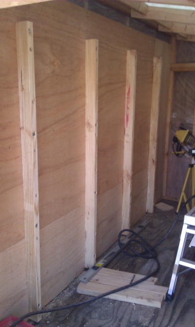

    With the long hours I have been working, weather problems, holiday activities, and having all the contents stacked undeer a tarp on the work deck progress has been slow. I finally got the uprights for the lumber rack cut and drillled. SYP 2x6 cut to 5' and ripped lenghtwise to makk 4 uprights. Holes for the pipe are drilled 2" deep at 5 degrees every 9" starting about 2" from the floor. (Thanks to Loring for the tip on modifying a 3/4" speed bore bit.)
    I picked up some 1/4" lag bolts to attach the uprights to Playpen studs. After breaking 3 of them, even with the holes predrilled, I decided to stop and switch to heavier bolts. I will head over to Tractor Supply in a few to return the remaining bolts and the washers for 3/8 bolts. Going with the heavier bolts I should be able to go shorter and still have plenty of holding power. I was using 5" bolts that gave me about 2 1/4" into the studs. I will switch to 4" bolts and recess them a little more so that I will have 1 1/2" of thread into the studs. I left the fence set up on the DP so alignment for redrilling will be easy. With 4 bolts per upright that should be more than enough holding power.

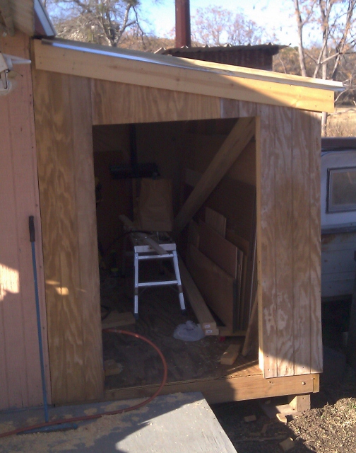

            Didn't get as far as I wanted but did make some progress.
            The lumber rack is in but I have to clean most of the conduit better. It was cut from some I had that has been laying around outside for a long time. The sheet goods storage was already in place.
            Except for 1x facia, some 2x framing, and plastic for the vapor barrier, everything was stuff I had on hand so the cost is negligible.
            The 3' opening will get double frame and panel doors.
Name:	Extersion Front (504x640).jpg

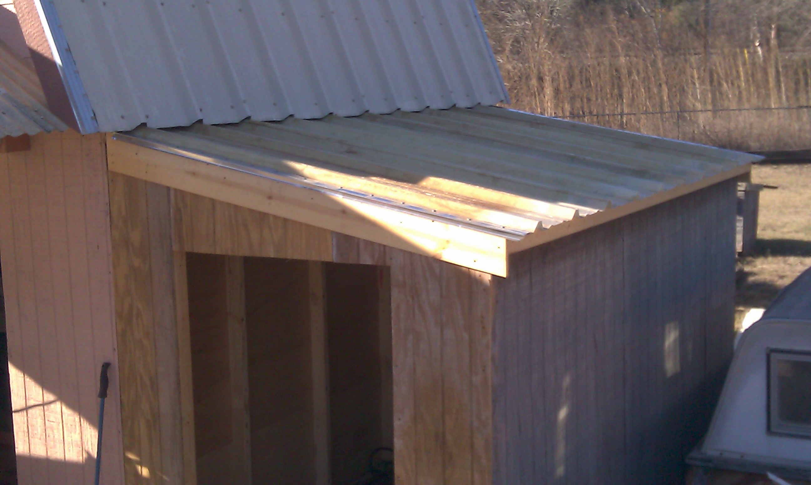

            The roof is fiberglass R panel I got from a neighbor to let some light it.

            Thinking I need either a strap band or maybe a joist hangar at the bottom to strengthen the wood under the bottom supports.

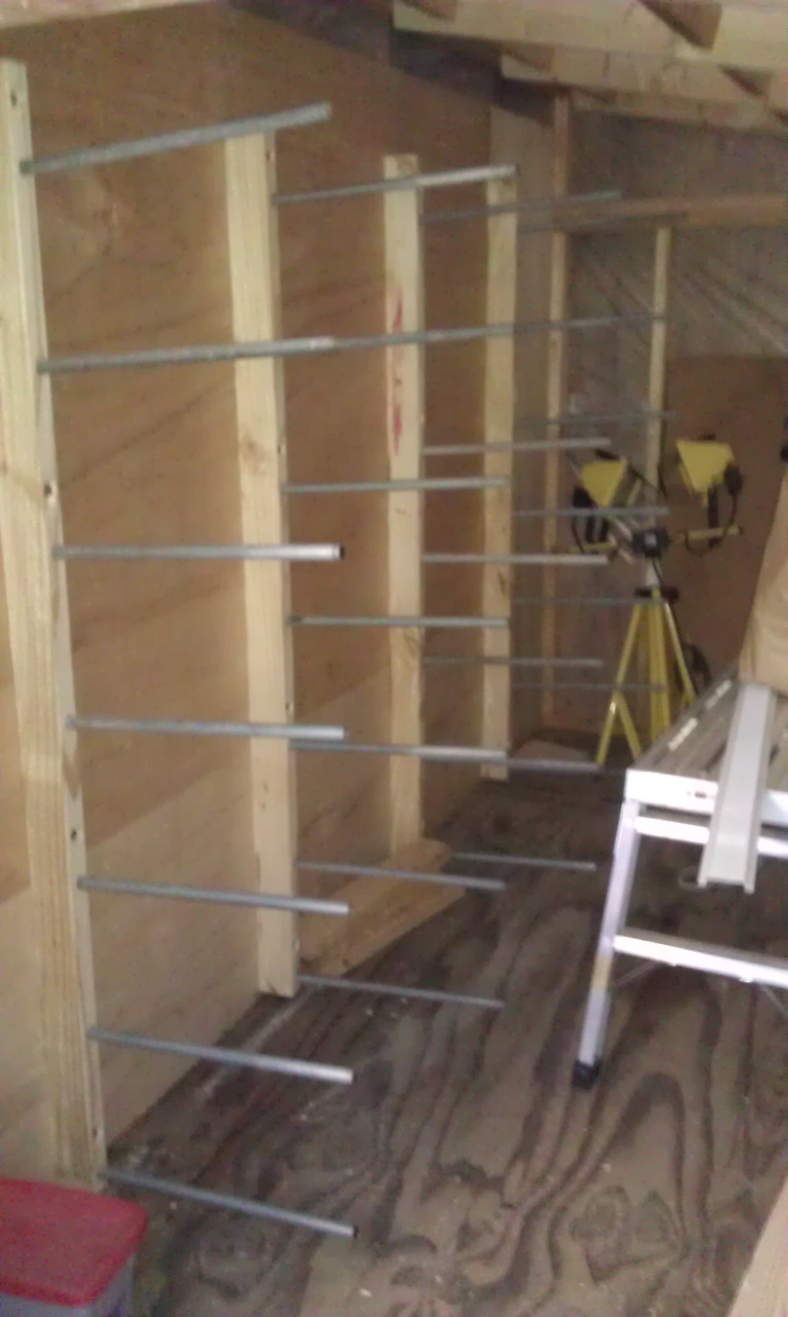

            With the 16" conduit installed I still have a 2' walk area.

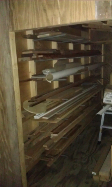

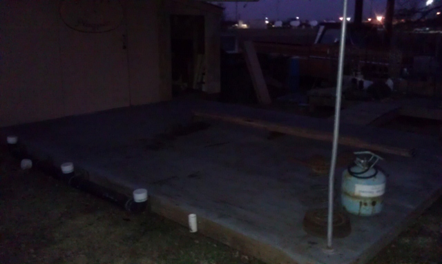

                          As much as I would have liked to spent the afternoon watching football, I got some time on the shop today. Finished cleaning the conduit and reinforced the bottom of the uprights.
                          For the reinforcement, I cut the flanges off 2x10 joist hangers, wedged them tight against the bottom with a piece of ply and a shim, and attached them with 2 screws on each side.
                          I have to modify some brackets to hang my work lights and some storage tubes, but I got the wood off the work deck before I called it quits for the day. I can get the BT out now to build the doors, work on the brackets, and make some safety caps for the exposed ends of the conduit.
                          Sorry about the poor quality of the pics. They were done with my phone and taken after dark as an afterthought. I will take some better pics once the job is complete.

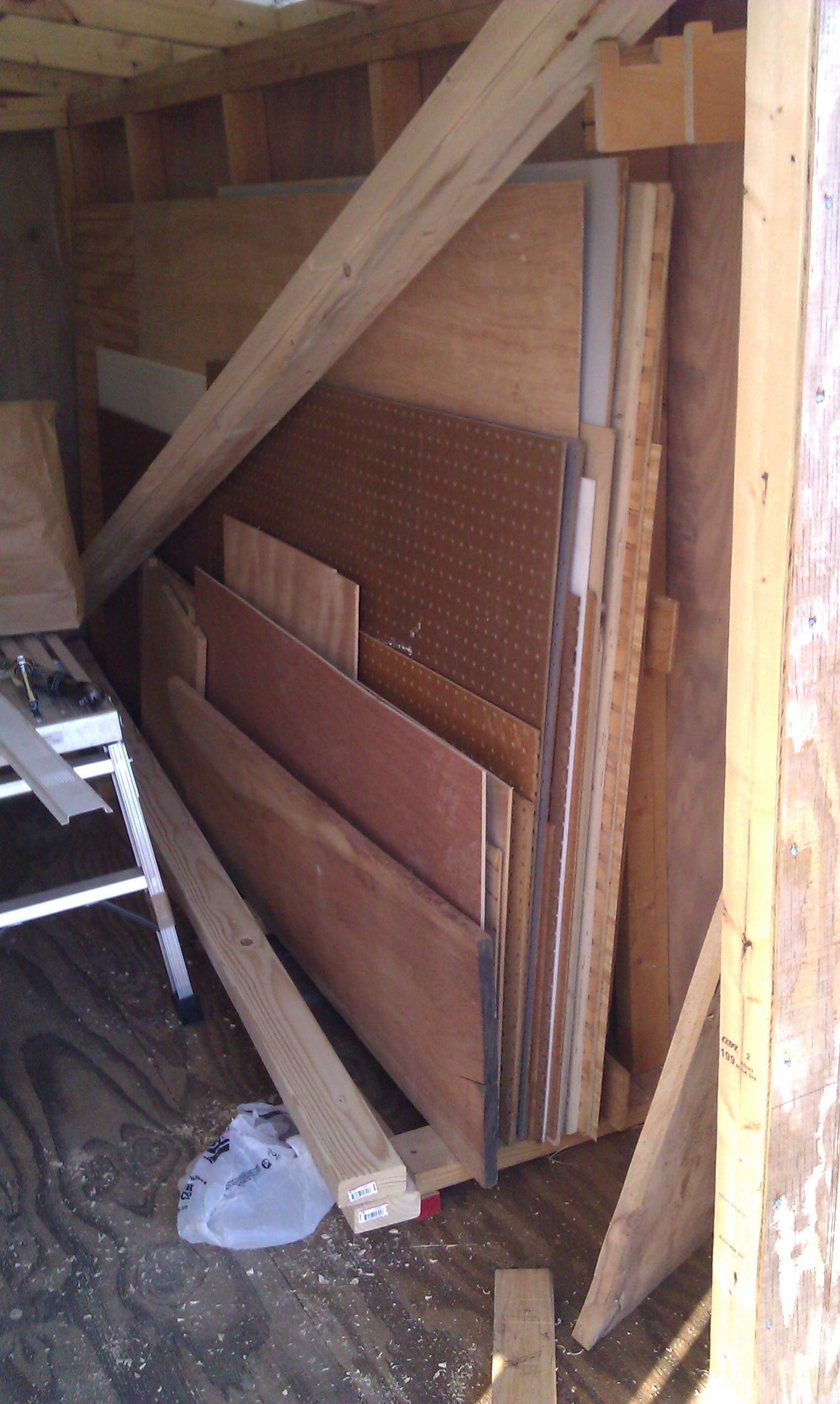

                          The remaining wood is Cedar that is too long to go inside.
Name:	IMAG0323 (640x383).jpg
                          Still need to do some rearranging and clean up.
Name:	Filled rack (383x640).jpg
