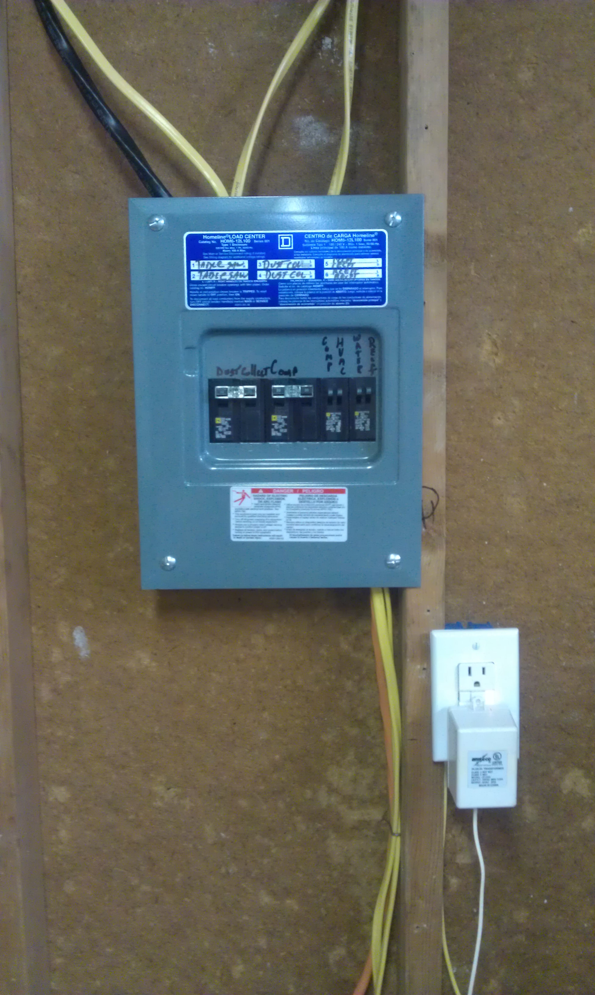

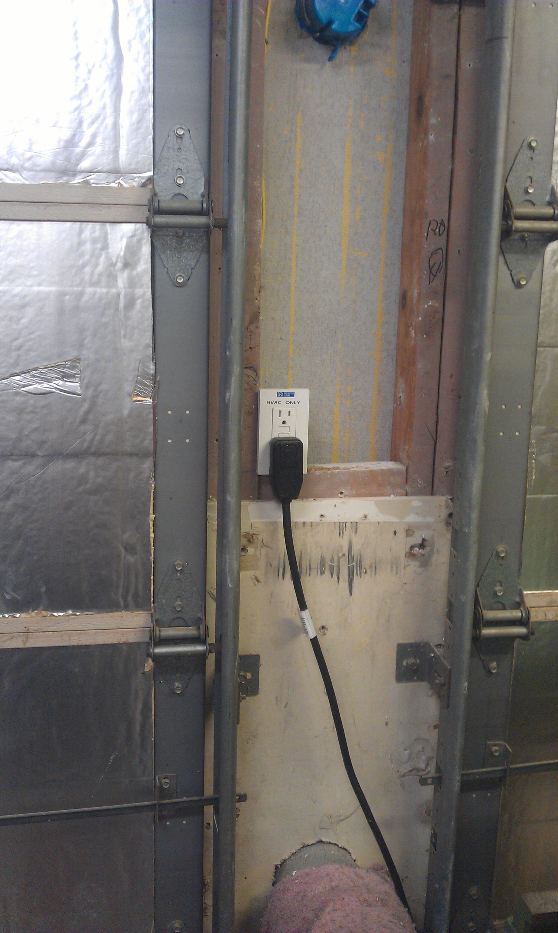

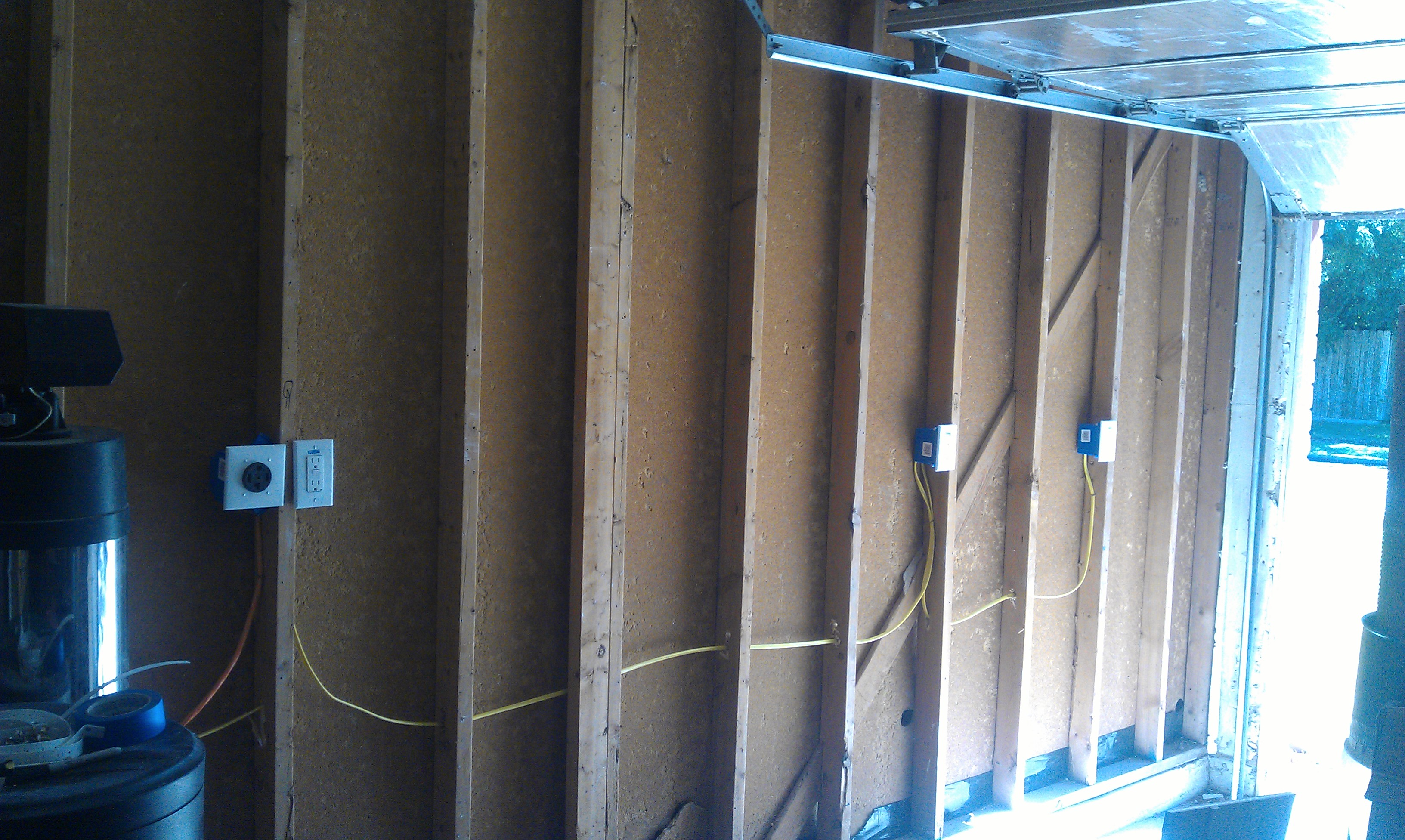

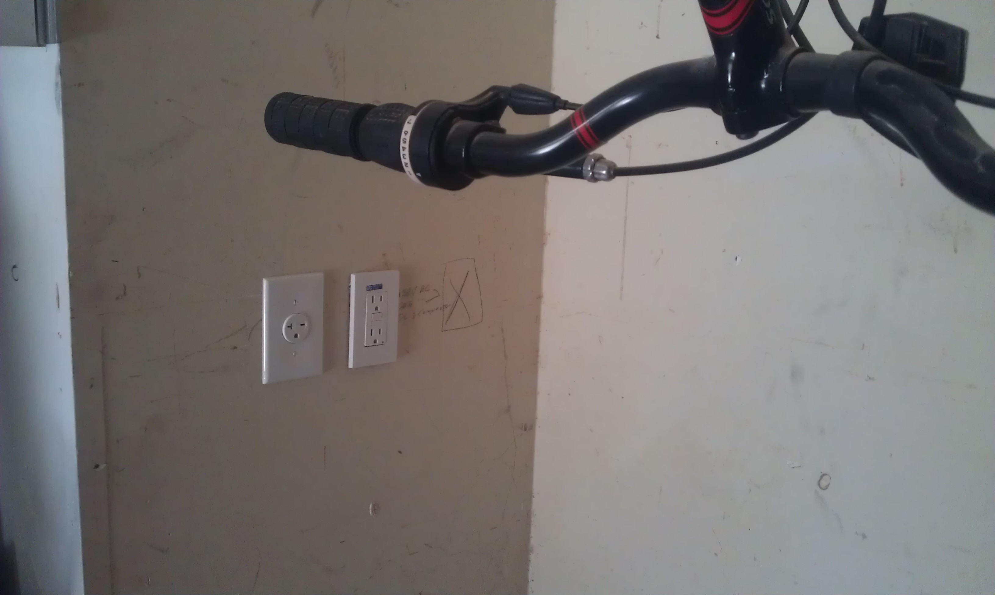

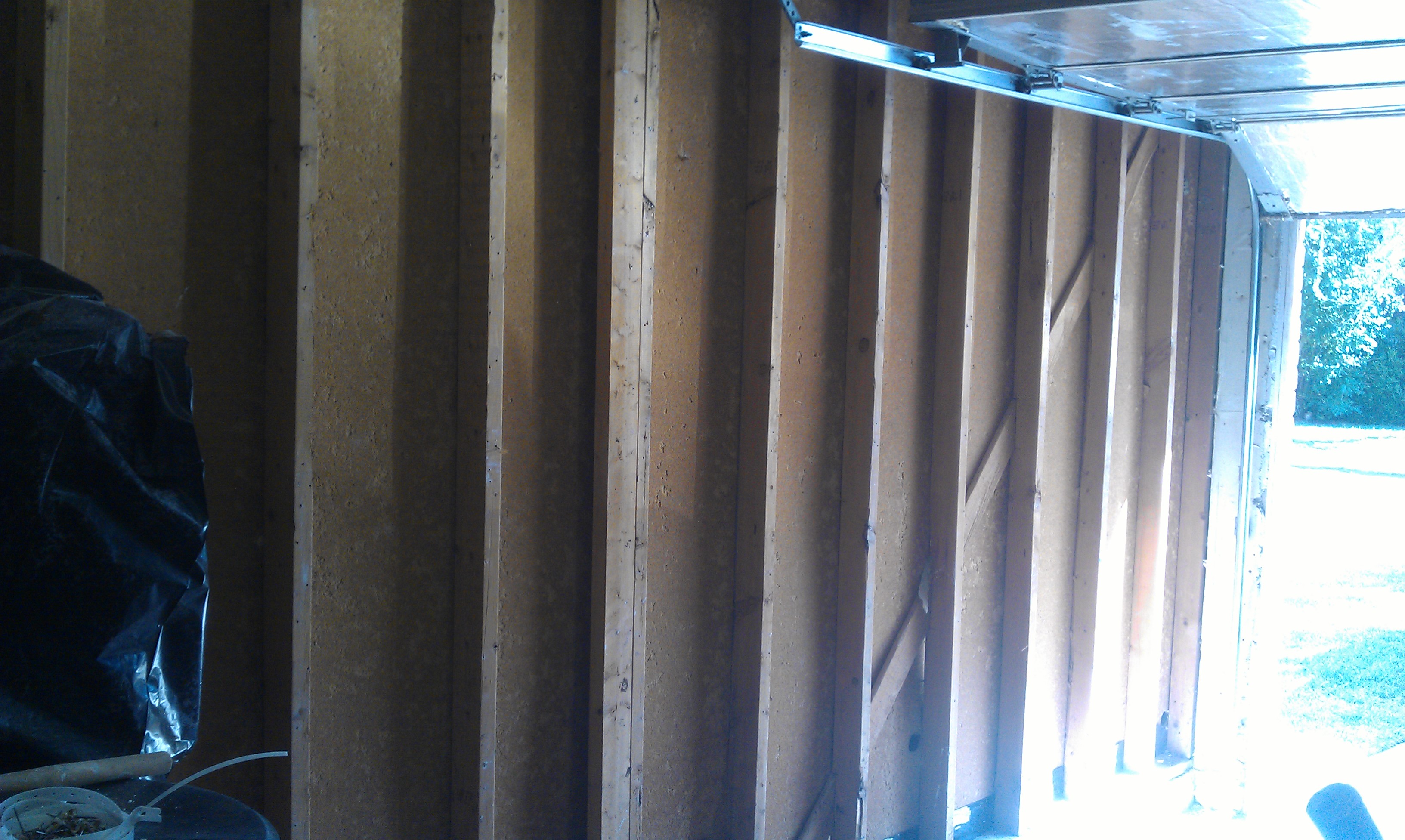

                            First pic is the wall stripped and ready to go, second pic is same view of wall with the outlets installed, then the wall with the 110V and 220V outlets for compressor, dust collector, and future cyclone. This can be upgraded to 30 amp by swapping an outlet and a breaker. Next photo is the HVAC outlet. 110V. For what it's worth, the AC works so MUCH better on a dedicated circuit. Even without the insulation or sheetrock the garage got down to temp is less than an hour and nothing electrical got warm.. The last photo is the sub panel itself, the outlet shown is a dedicated circuit (hmm, I guess that makes 4 110V circuits...), that feeds the water softener R.O. system...
                            The outlets are well off the floor, but are far enough down to fit easily under the clam shell cabinets...
