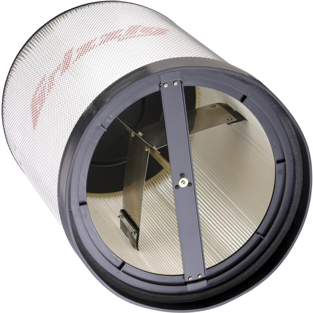

                I got tired of needing to clean my Wynn filter so I made the flapper cleaner according to the instructions on the Wynn website. I had to order a few of the parts from McMaster Carr but it was pretty inexpensive. It also seems to work well. I am about to fill the bottom bag for the second time without needing to do anything other than rotate the flapper piece every once in awhile.
                  My Jet has the flapper cleaner and a couple turns of it and all is clean.
                    • 22044
                    i put a 20" grizzly H5783 canister on a HF 2HP DC and it has a flapper too. Seems to work well.
                    See black handle below:
                      I gotta see a picture of that installation! You got one?
