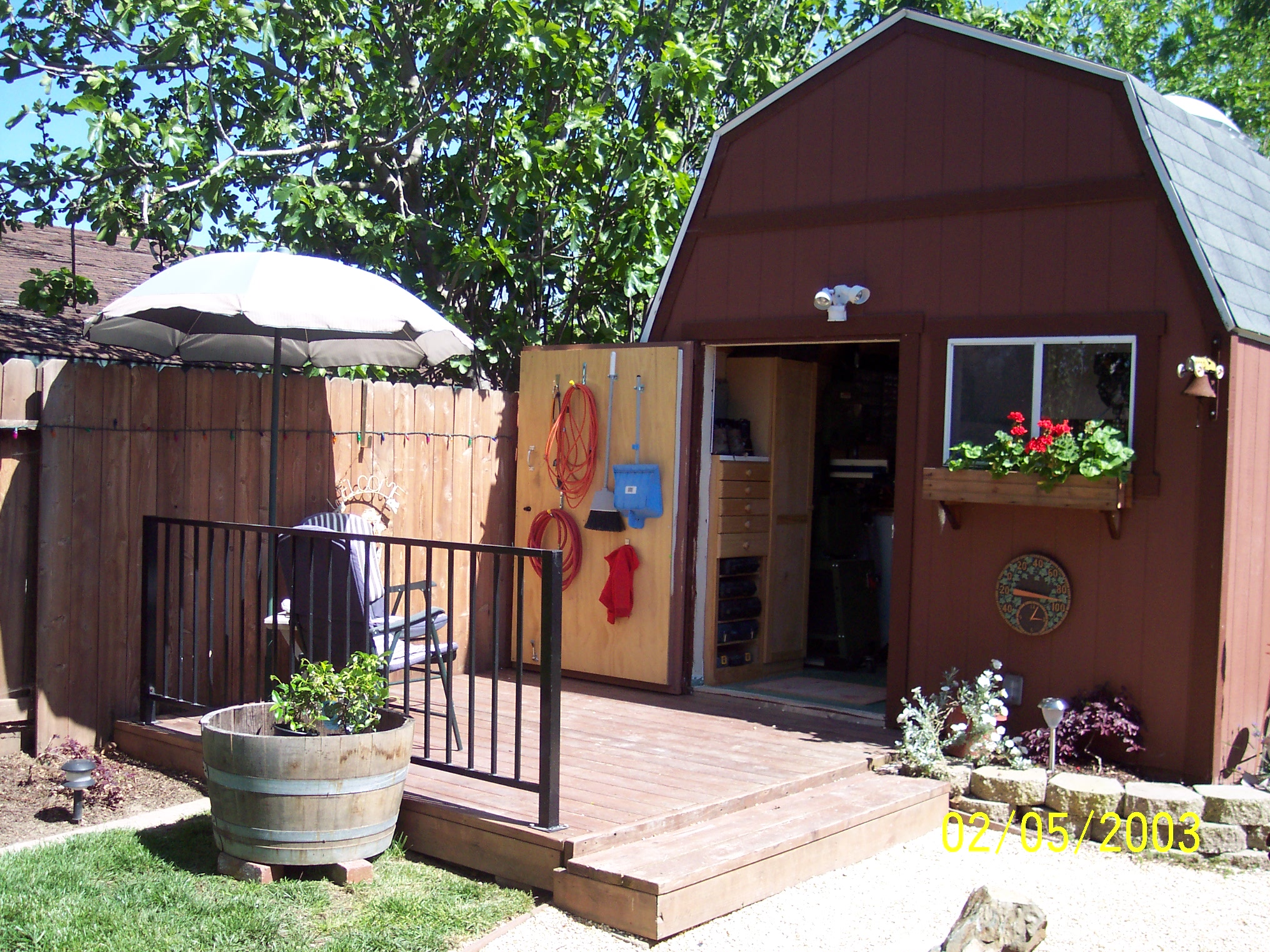

          My shop is 10 X 12 barn type shed (Tuff Shed) the wall and ceiling are insulated. There is dry wall on the wall which now has been covered with 1/2" plywood. I have a small electric radiator style heater I bought at HD a few years ago, work fine and can keep the shop at 65 or high even on the coldest day. I have small window AC unit I put in during summer. The shop has 3 window so I take the glass out of one and put the AC unit in with a painted plywood filler panel. It can keep the shop at 74 on a 108F day here in Sacramento. We don't have the humidity they have in other stated so the small AC is fine. I have 80amp box in the shop which in the back corner of our lot (small city lot) Be sure and insulate you doors, that will make a big difference.
