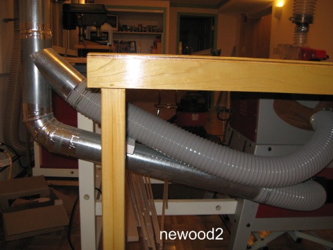

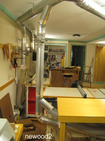

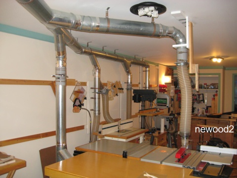

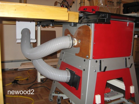

            Some pictures of my ceiling drop. Another idea to draw from I guess.
            Howie
