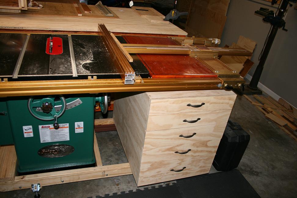

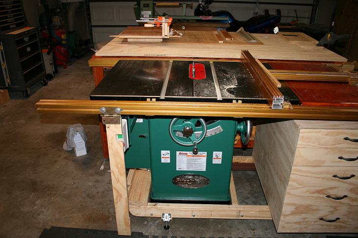

                            if it works right u should see the grizzly 1023sl i got an incra ls really cheap and built the mobile base for it and a nice lil set of drawers for some extra tool storage.

                              Oooh...nice setup! Now we are talking!
                              Great drawers - are those also mobile?
