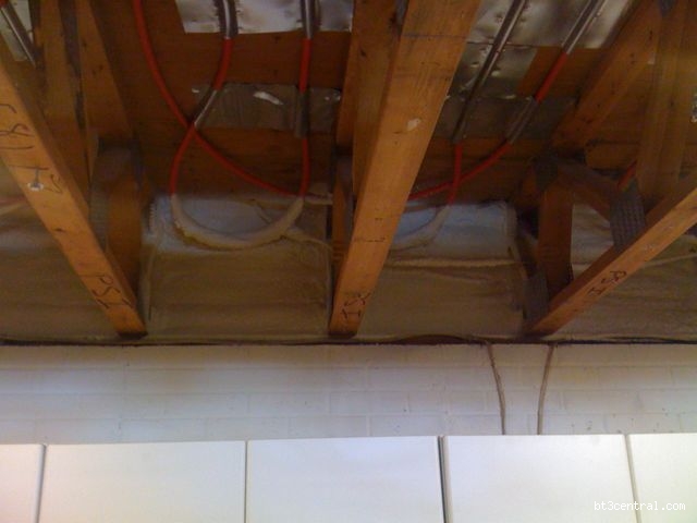

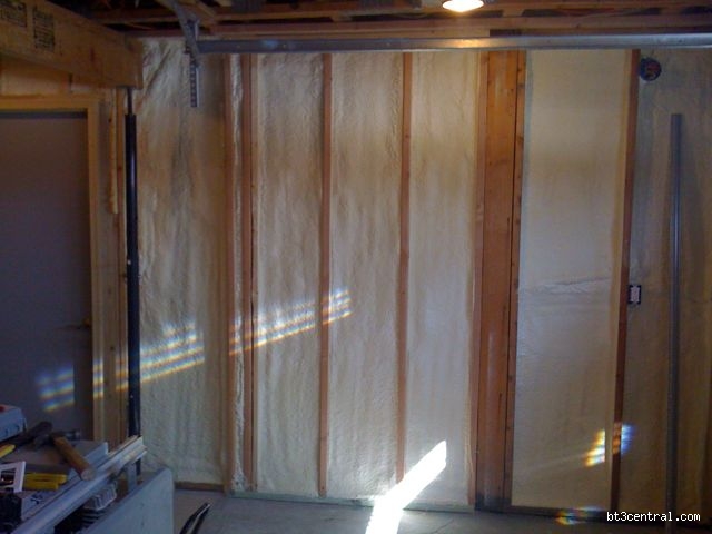

              And less than four hours later ...
              They're done and my 28x28 garage is fully insulated
              A couple of photos
              Along the rim cavity
                Looks good. What is the cost per sqft to install? Thinkinng about it for the new room I am building.
                    They charged 2.65 a square foot at 3" thick which is what they did for all the exterior walls and the rim joists.
                    They charged 2.20 a square foot for 2.5" thick in the 2x4 wall between the house and the garage.
                    This company only sprays the closed cell insulation. The closed cell is more expensive but is air and vapor tight so no vapor barrier is needed. Closed cell is R7 per inch and open cell is R3.5 per inch. With open cell they fill the cavity full and then trim off the excess. Closed cell they fill the cavity about 2/3 full.
