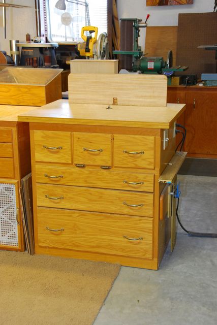

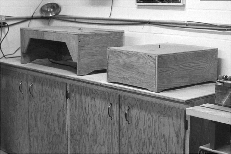

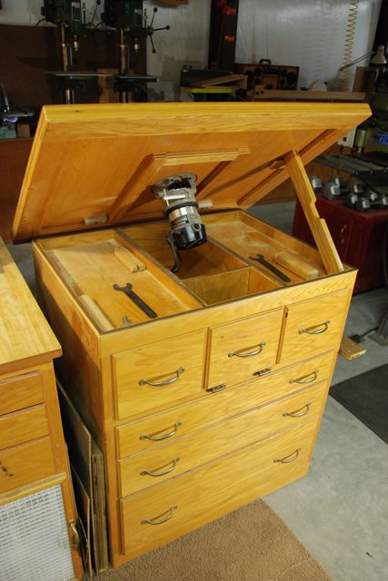

              No plans needed. Just build a box and mount your router under it. Forget the plastic insert. Not needed.
              Here is my first table, built in an hour or two when I needed one quick to rout a lot of parts I was making. It wasn't too hard to change bits. I just tilted the table up on an angle to get the wrench in the right place.
              That gave me the idea for the second table. It is nearly 20 years old now, and I wouldn't change a thing. The second one has an enclosed router to hold the noise down, dust collection thru the 1.6 diameter hole, and still no plastic plate - and no lift mechanism. I am happy with the way it is without it…
                a table-mounted router is an important shop tool and is to a hand held router as a table saw is to a hand-held circular saw - much easier to guide accurately.
                Two things are essential for a good table-mounted router for all-around use, and that is a flat top so you get consistent depth on edgings and moldings on longer items and a sturdy base to you can push the wood hand-over hand without having to support the router yourself.
                For the flat top you need a plan with 1.5" thick or more table lamination or buy one. A sturdy base you should be able figure out yourself or be included in the plans.
                  The "flat top" mania can be taken to extremes. Three quarter sheet stock can be used that is well braced from beneath. Doubling up tops doesn't mean they cannot warp.
                  It pays to have an extra base left mounted in the table, so that router can be also used hand held. Some members may not have the budget for multiple routers.

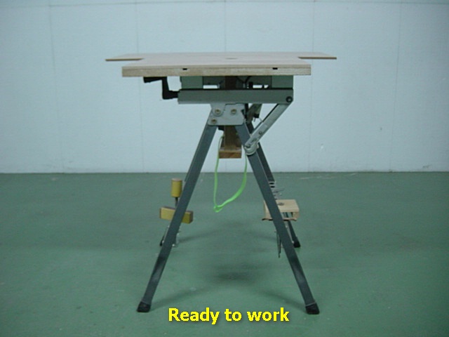

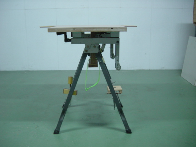

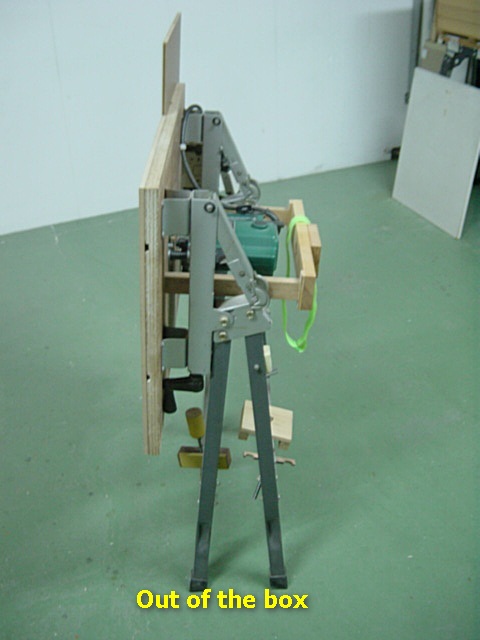

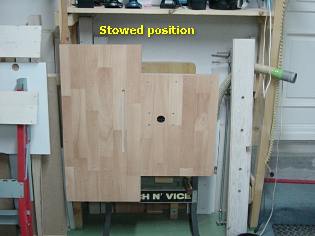

                    As for me, I'm using the "Workmate" as a base...the router is bolted directly to the "floor panels"...no insert, just a 1¼" hole (my biggest bit dia)...
