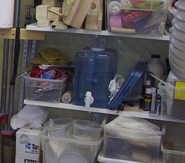

                    Running water?
                    Here's my running water, complete with spigot:
Name:	Running Water.jpg
                    Haven't really felt like I need much more than that, and I go months on a fill. I have a little covered waste bucket on the floor.
                    Regards,
                    p.s. water temperature perfectly controlled to room temp.
