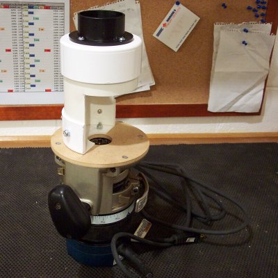

    In Rich P's thread (here), I posted a few pics of something I made. I also promised more details, which I've finally gotten around to providing. Sorry for the delay.
    My 6” benchtop jointer is ill-suited for edge jointing heavy or long stock, so I often use a pattern bit and straight edge to accomplish the task. Unfortunately, cleanup of the dust and chips makes doing so a chore. I had received as a gift the Rockler edge routing dust collection attachment (mentioned in Rich P's thread), but I had little success with using it. The ABS neck of the Porter Cable-style bushing connection was fragile, the nut loosend, it fell apart during use, and broke. They gave me a refund. Conceptually, the product has merit, but its fragility leaves much to be desired.
    I devised a simple, cheap, easy to fabricate, and much stouter and safer (in my opinion) router attachment that makes cleanup a non-issue.

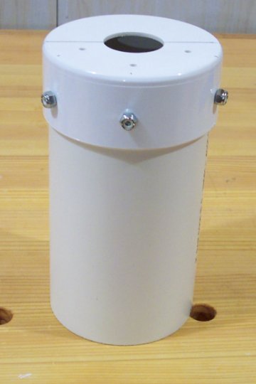

    Next, remove the end cap from the subbase, and attach the end cap to the length of 4" sewer and drain. I fastened the endcap to the pipe by using screws and nylon lock nuts. I didn't have PVC cement on hand, but I probably still would use mechanical fasteners just to feel safer.

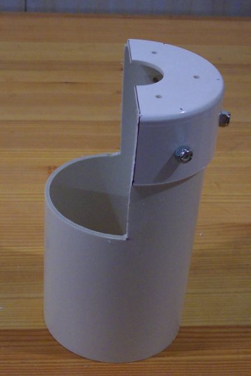

    Extend the centering lines on the sides of the end cap down the sides of the pipe approximately 3½". I chose that length to accomodate the longest pattern bit I own (2½” long), with an extra margin. Then use a hacksaw, bandsaw, or PVC handsaw to remove the back half.

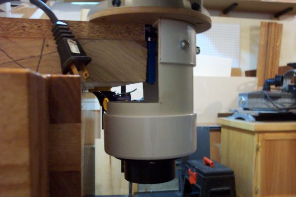

    I designed the attachment so that most of the bit was surrounded by the pipe, and so that the Shop Vac hose would hang straight down, out of the way of my feet.

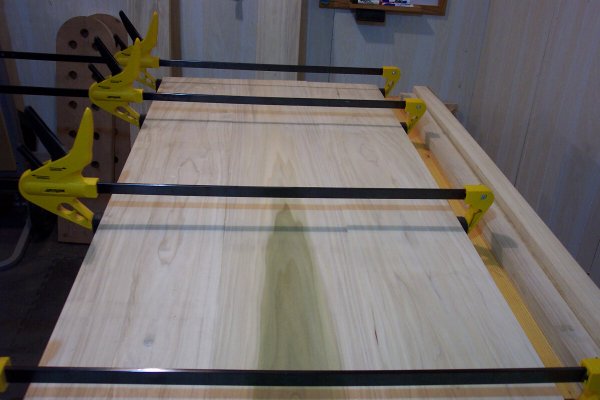

    How well does it work? This photo shows my shop floor before I flush trimmed 5' of 8/4 poplar.

    A pattern bit and effective dust collection can help you edge joint tight joints in thick, heavy stock.
