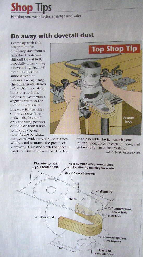

              The issue of Wood Magazine that is on the shelves now has an interesting solution. Kind of a repacement baseplate for your router, with a suction chamber I am thinking maybe something sort of similar to screw onto an edge guide might be interesting...

                this is probably the tip you are referring to (attached pic)...cool idea,yep,i'd rather use my edge guide or the rockler thing than have to mess with unscrewing baseplates and all that ,seems it'd be more of a hassle,although his solution directed toward use with dovetail jig,so makes sense,rockler or edge guide wouldnt work there.

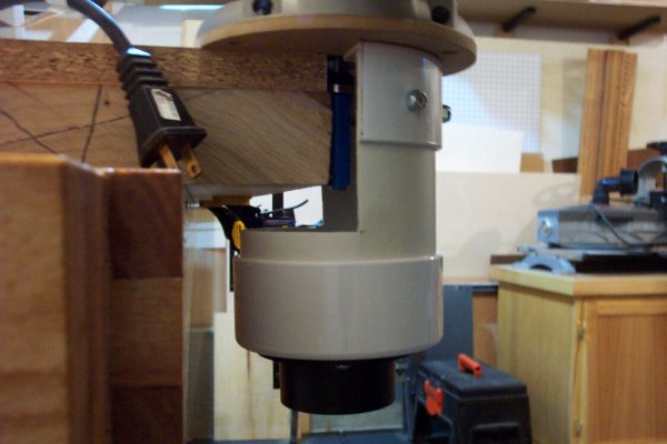

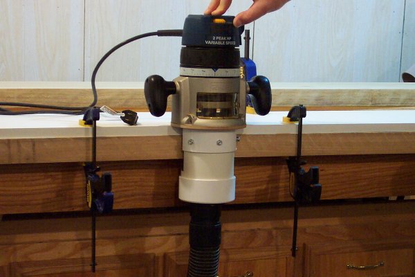

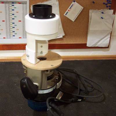

                      Here's an idea.
                      I'm short on time, so this is short on details. I'll put a thread together later this week with more details, if there is interest.
                      It works well.
                      Brian

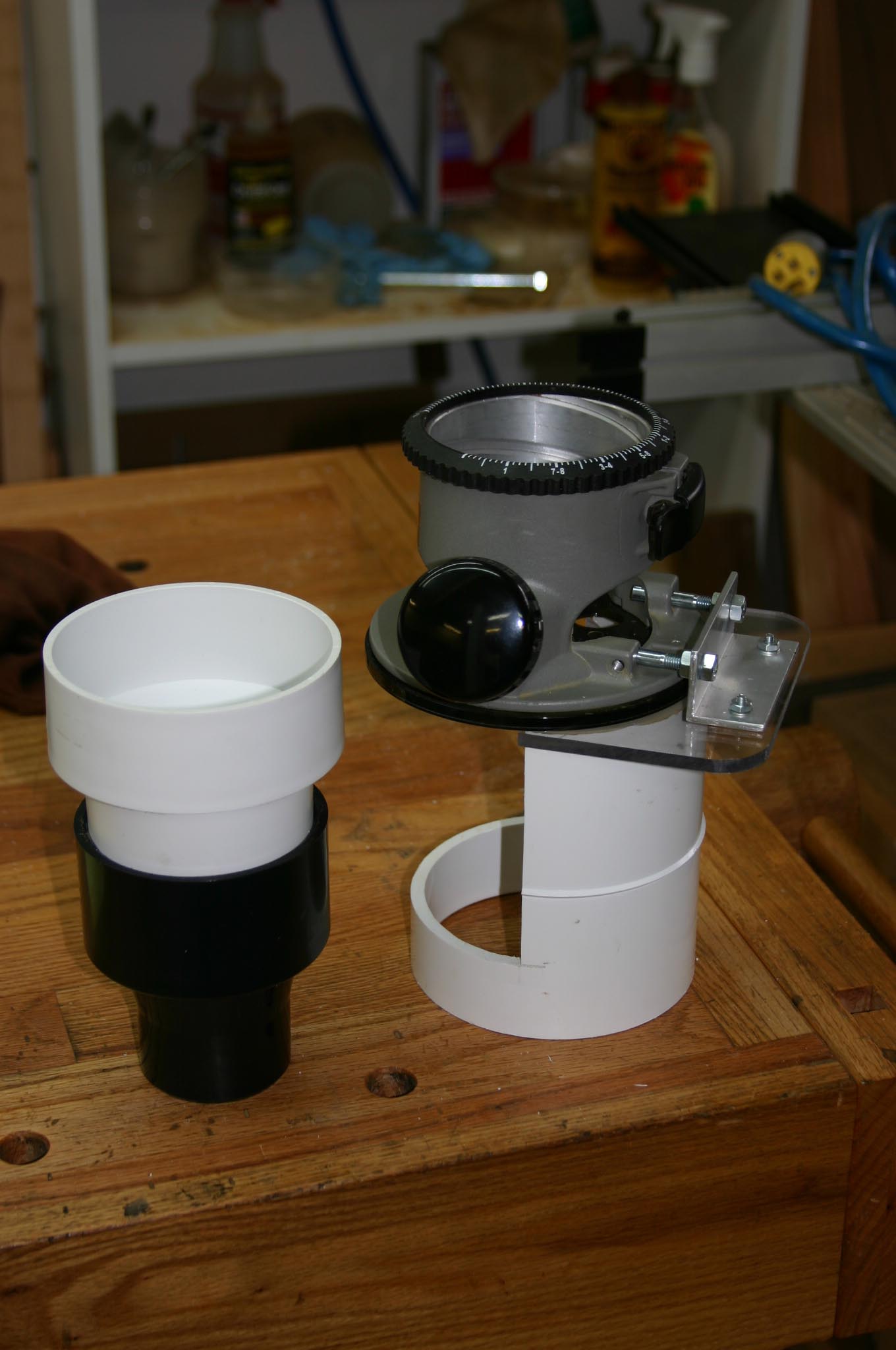

                              Since I wanted to use a different approach to attaching the DC fixture to the router I went ahead with my first shot. Since I didn't have any 4" pvc handy, I used a standard 4" coupling and cut it out as you did with your pipe. I then used plastic epoxy to attach the coupling to a small scrap piece of polycarb and then added a small piece of aluminum angle with two cutoff hex head cap screws which slide into the fence mounting holes on the PC base. This eliminates the need for a base change.
                              Because I also wanted a fixture that would work with the edge fence, I found that a 4x3 S&D reducer would friction fit nicely into the 4" pvc coupling, so I used a circle cutter to cut a hole in a 3" ABS cap to accept the Woodstock 3 x 2-1/2 adapter, epoxyed the adapter into that hole and then the cap/adapter assembly onto the reducer.
                              I still need to cobble together the same thing for use with the edge guide fence and I'll post that when I get it done. Problem with the PC edge guide is there is a 1/4" or so gap between the bottom of the router base and where the DC fitting would be attached. I imaging there would be a fair bit of debris getting thru this gap. I have an idea on how to close this up but still need to make it so.
                              Thanks for the inspiration on the pvc approach. I hope mine works as well as yours.
