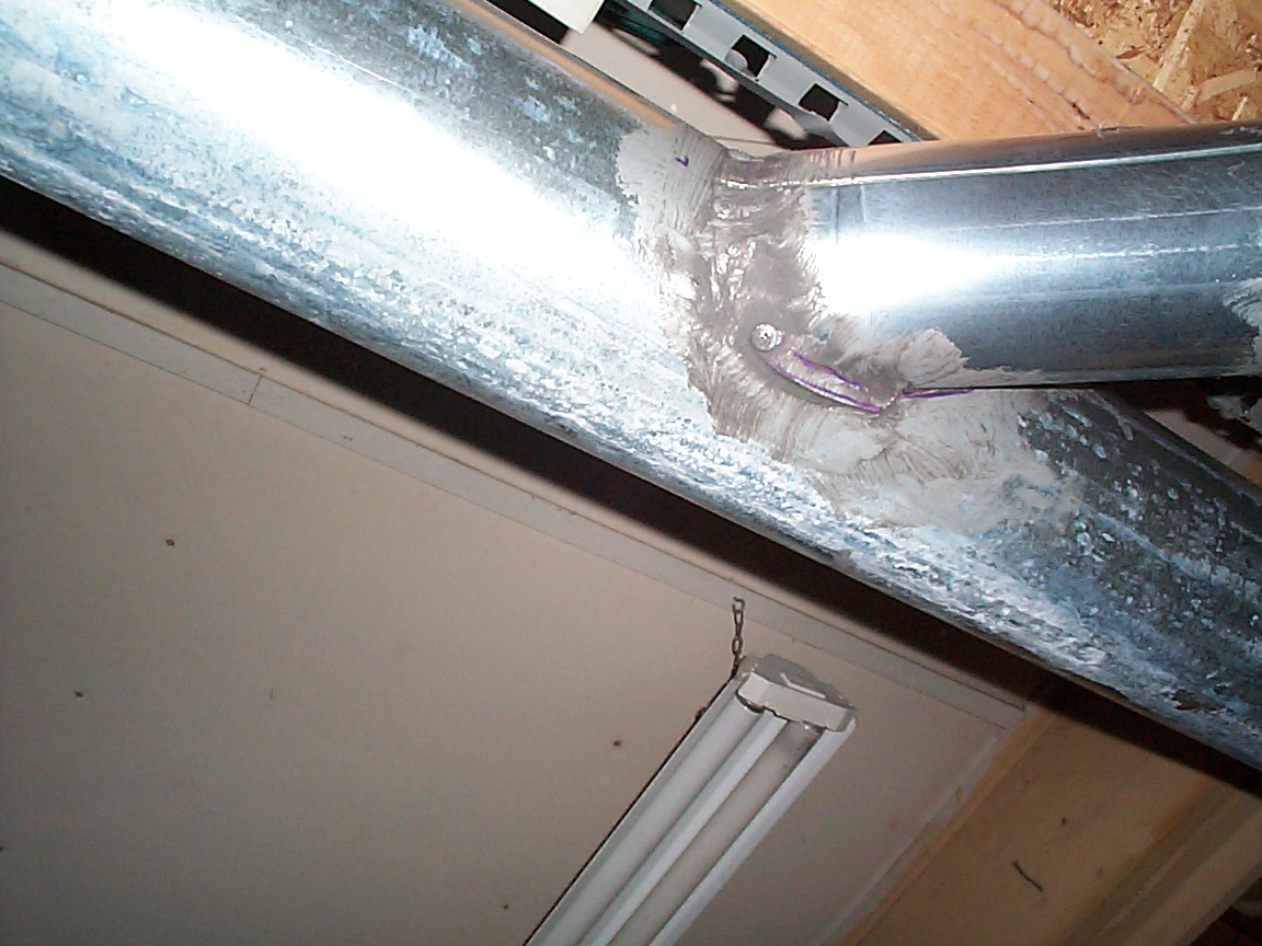

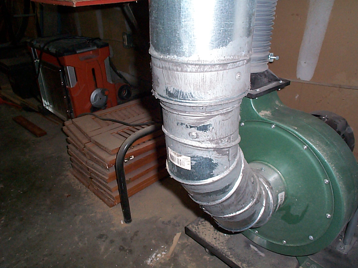

                    Leaks on the positive pressure side of the DC don't reduce air flow only those on the negative pressure side of the fan reduce air flow. Leaks on the positive pressure side of the fan do put unfiltered air into the room.
                    The best material to seal duct work is shown in the pictures below. This is used in commercial duct systems and won't peal off after time as the RTV and tape will.
                    The duct seal is available from Lowes for about $12.00 per bucket which should do any duct system in a residential shop. It is a gray paste and is put on with a paint brush

                        Art, the gray goop is good to know about when I get ready to run duct work. For now the unit must be mobile so I'm stuck with hoses.
