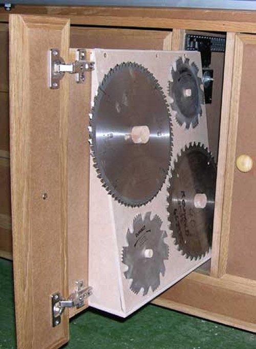

            I use an a-frame pull-out. Keeps four blades convenient and out of harm's way (for HarmsWay).

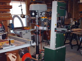

              This isn't a very good picture but you can see my table saw storage in the lower right. Bandsaw blades are just rolled and stored inside the bandsaw.

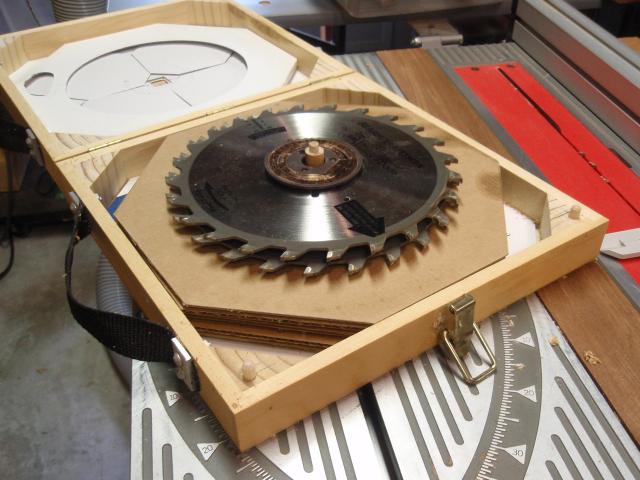

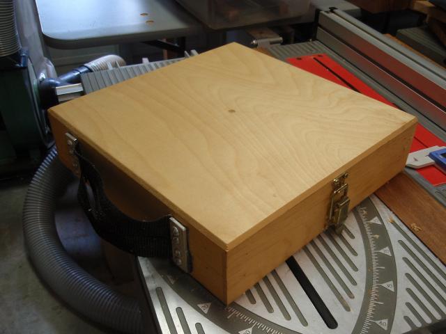

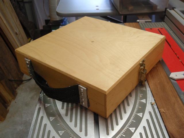

                    My Blade storage box
                    I made this to store blades:

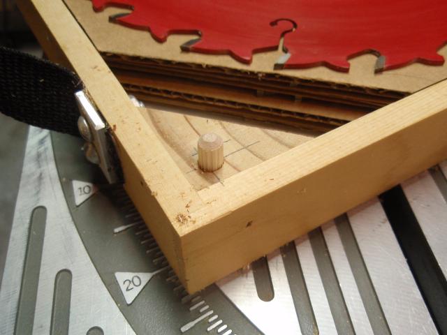

                    Since blades and the full box are heavy I reinforced the corners, I pegged the cover in two corners to make sure the box did not distort when cosed
                    I hang the blades on a 1/2" dowel thats supported on both ends when cerrying the box... you can see the open end of the dowel has a peg that fits in a hole in the top cover.
                    I cut cardboard sheets to fit between the blades to prtect them from each other. The box is large enough that the blades fit comfortably and slide on an off the post easily (1/16" clearance around the post) but the blade tips don't hit the outer walls of the box.
                    And yeah, that's a twin-blade wobble dado.

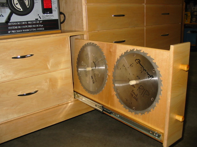

                        My idea is very similar to that of HarmsWay - a pull-out caddy in my mobile table:

                          Really nice case, Loring. I like the slide outs on drawer guides too. Seems like a good way to use a bit of lost space. Nice work, folks!

                            I'll say, you guys for the most part are seriously embarassing... So far I have my TS and CMS blades in a 11x11 sqaure of ply, with a 1/2" dowel in at about 95 degrees, so that there is just an ever so slight angle upward, in the center. This hangs from the pegboard, and the blades are separated with cardboard like Loring did his...
                            The band saw blades, at least for now, are simply rolled the way they came from the factory, taped up, and hung from a couple of nails on the wall behind the band saw...
                            The sliding tray idea I like, but I am using the space under the extended rails for other storage (heater / A/C units). I might just build a box similar to Loring's. I like the idea of being able to slide them on a shelf...
