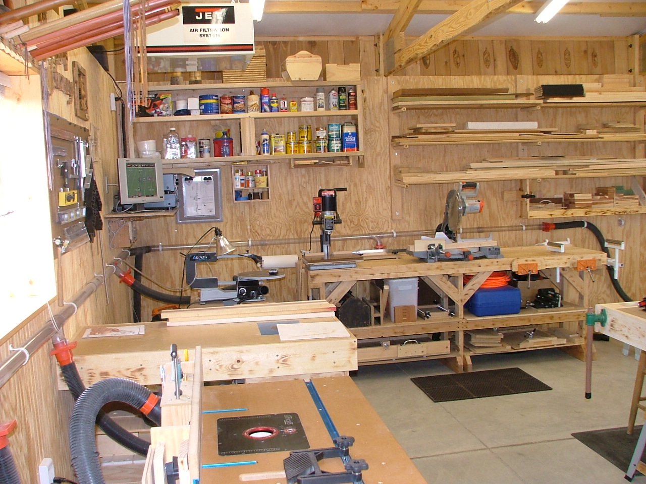

          I am using the same thing that Steve is using with a blast gate at each machine. Works great for me. If you look against the wall in the photo you can see how it is hooked up to my machines and the blast gates.
            Hey Larry,
            I've seen your shop pics now for I guess a year at the other site... I always wondered. Do you have someone that comes in and cleans up for your photo shoots? That is ALMOST as neat & tidy as Rod Kriby's shop...
            Actually, your shop was one of the ones that gave me the idea that you could use a shop vac for dust collection... so I guess you are to blame
            Steve, I would think you have seen my DC pics by now. I think the hoses are too long, and have been shortening them up... Getting the ribbed stuff down to a minimum. As much as possible as smooth as possible, with as few bends as possible. So far there is a noticable improvement in suction. DC off the router fence, and CMS is awful, but most everything else is top notch...
