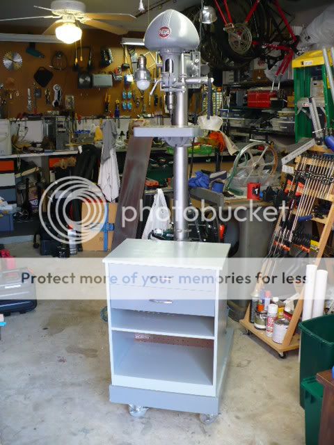

                Here's the base I put together for my 1950 Delta DP. The base is painted OSB and pine 2x4s, with the OSB dado'ed into the 2x4s. The cabinet is painted MDF, with a pegboard back to hang fences and fixtures on. All four casters have locking wheels, it's pretty stable when it's parked.
                Nothing fancy, just functional....

                  #38
                  Originally posted by MikeMcM1956
                  Mike,
                  Very cool stuff there. Your shop looks a LOT like mine, okay so you got further with the reflectix on the doors... I am only 2/3 of the way down on the first door yet... I need to finish this...
                  But that DP, WOW! That looks like something from War Of The Worlds! Too cool!
