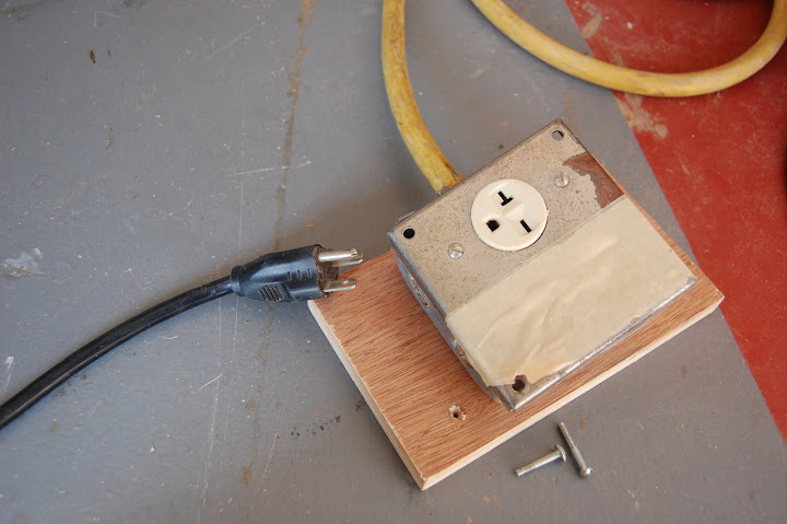

    Along with my Unisaw, the seller also gave me a shop-made extension cord for 240 volt, and not very well made at that :
    Can I do better? I am not sure stores sell any 240volt cord, but even if, do I have to? Maybe fixing this is good enough?
    Looks like somebody took a wall outlet-box and created this. Should I get a regular 'socket' to make it?

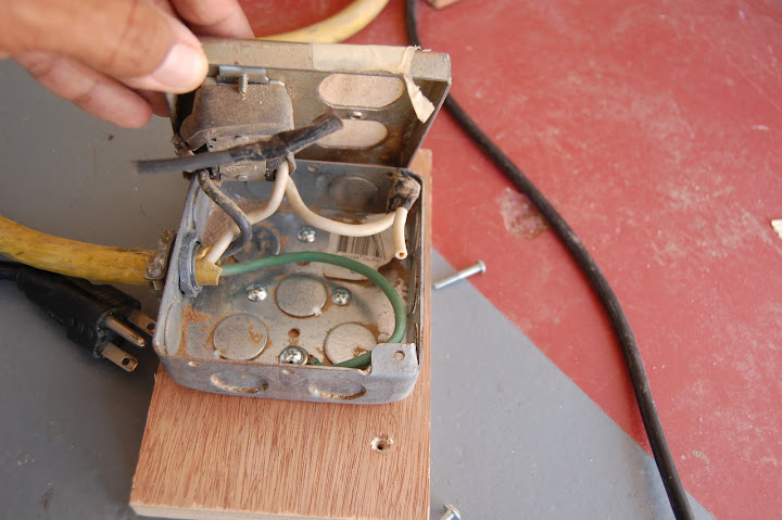

    The cable on the saw is 14/3, so I guess this yellow one is 12 guage?
    And of course they had taped the wire ends; I could cap them. The green is ground, going to the metal on the box?

    Yes, HW stores do have 240V extension cords. But they aren't exactly a common item...
    Check around in store. You should find them pretty easy...

      As long as the yellow cord is sound, you could just rebuild what you have there. Use a single-gang box, or get a cover that has only one opening in the center.
      My first choice would be to replace the power cord on the saw with a longer one. That's what I did on my PM2000. I had to buy the plug anyway, since it came with none.

              I would toss the box and replace it with one of these.

                  Wow, thats really ghetto Radhak. I would first check to make sure that you have good continuity with very low resistance on all your lines. If they appear to be in good shape, simply switch out the cover plate. They sell for double gang boxes like that one, a cover plate for round plugs. If i remember correctly, HD has them for washer and dryers, etc. in the electrical aisle. And def. rewire that properly, twist together your pairs and cap them. If your unsure of your wire gauge, clip some off and check against whats in stock at the store.
                  EDIT - On second thought....I think most area's code require 4 wire now?! Don't they (tomslick?others?) I would check into it Radhak, you should be feeding two hots, with a neutral and ground for safety. The two hots come 1 from each phase, they return on a common neutral and then there is an additional wire for ground - 12-3 + ground.

                    There's no need for a neutral for a 240 Volt load. Two hots and an equipment grounding conductor are all you need. For something like a dryer that uses both 240 and 120 you would need a neutral.

                      There is no neutral/return on a 220v circuit, just the two hot wires and a ground, so 12-2/G is the correct wire, and I agree that a new wire of the correct length right from the saw to the outlet is the best way to go.

                        a 4-wire circuit would be required for 30 amps or above on a newly installed circuit. There is no need for a neutral with a 20a saw.
                        If it were me I'd either install the correct cord end and delete the box or rewire the saw with a longer 12awg cord. 14awg would be acceptable for the saw but the price difference wouldn't be worth it.
                        I prefer twist lock connectors for stuff like this but they are a little hard to find and very $$$.
