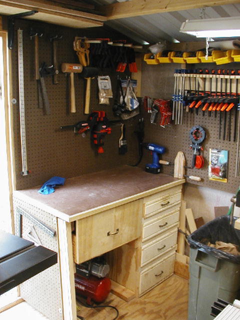

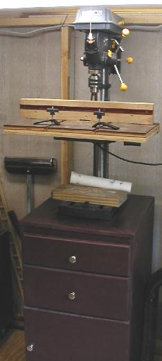

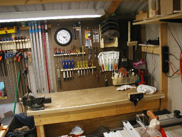

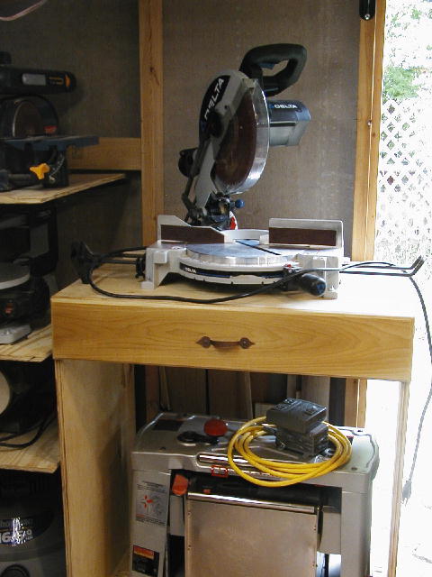

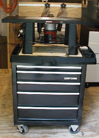

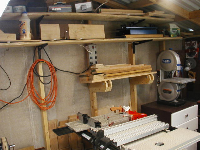

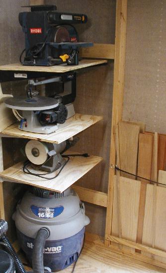

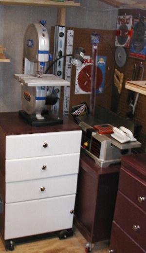

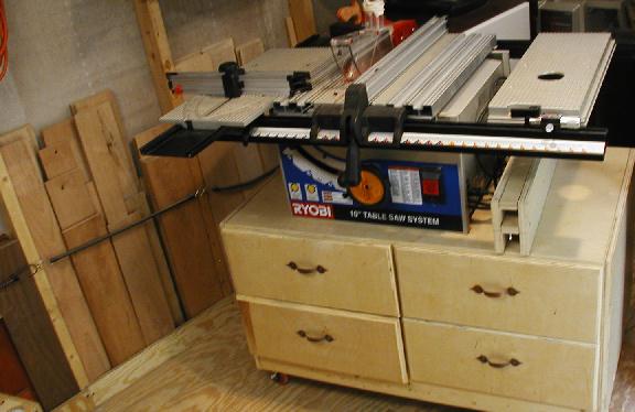

                        My first shop was in a 10'X12' storage shed. It's cramped at best but with good planning and by putting most if not all your tools on mobile carts that include storage it can work. I've since moved my shop into a 12'X14' shed and use the 10X12 for storage and for a few of the larger tools that I don't use all that often.
                        Here are some pics of my old 10' X 12' shop. As you can see, all the tools are on mobile bases with storage(I'd use 4 swivel locking casters under each base as the 4 swivel casters make moving the tools much easier). The 3 tools on plywood bases (over the shop vac) were used with the cart on which the router table is sitting. Kinda my version of a tool dock system.
                        Hope this gives you some ideas.
                        DonHo

                          Don, your pics just made me REAL claustrophobic. Thanks. That kind of cinches it for me. The storage stuff is going in the shed. I go back to the original plan of putting everything on wheels and rolling it all to the left when LOML wants to park her car in the garage. Such as lousy weather days like this one...

                            Don, I keep thinking about your setup, and I keep seeing rolling tool carts come up on Craigslist on the cheap... So let's see if I have the concept down right...
                            Rolling tool cart, provides lots of drawers, and a big flat surface for bencthop tools mounted on plywood panels...
                            The plywood panels in turn nest on shelving standards when not in use, sort of a benchtop tool garage...
                            With my band saw, and floor model drill press the small shed is still too small, but I kind of like the idea for maximizing floor space in the garage...
