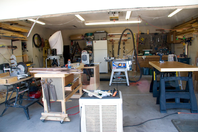

          Just to give you guys an idea of what I am fighting against. I had the shop clean Friday. Now the right bay that was 100% clear now has a 3 foot high stack of boxes 3/4" of the way back, all the way across.
            I would say mine is just a bit bigger than yours. I still have to share it with a small amount of household storage and the outside fridge but thats not such a bad thing as its always stocked with water, soda and BEER!
            I got rid of all the gardening stuff and the like into the shed and that really helped. I now have room for all my tools and probably have at least 400/bdft of lumber and sheet goods at hand. While it would be great to have the whole space dedicated to me it works pretty well.
