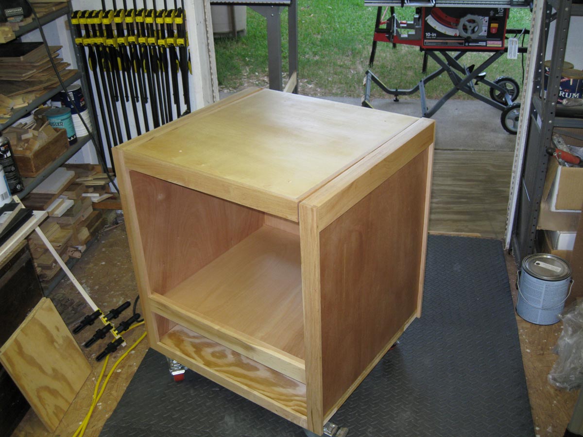

    I designed and built it to use materials I had on hand, save for the casters & pins. The materials are maple (recycled flooring strips), 2x4 3/4 birch ply, a 2x4 lowes handi ply (whatever it is), 2x4 1/2" birch ply, a couple pieces of 3/4" red oak, pine 3/4" ply bottom, pine 1x4s, 1/2" steel rod, Woodcraft 3" double locking casters, 1/8" thick nylon washers, two hitch pins, a bunch of Tightbond III, and some waterbased poly.
    I intended on laminating another piece of 1/2" birch ply to the 3/4" handi ply sides. After I got the hardwood sides and top rails glued on it seemed pretty stable without the additional 1/2" sides. Most all the joints are dados or rabbits. I used some 1-1/4" lag bolts to fasten the casters.

      I debated quite a bit on how to lock down the top. One of the plans I looked used some pivoting eye bolts and knobs. I really didn't want something sticking out the sides too far, like turn knobs. I had some brass slide bolts, but there was a little play in them.
      I finally went with a couple 1/4" hitch pins. One on opposing corners.

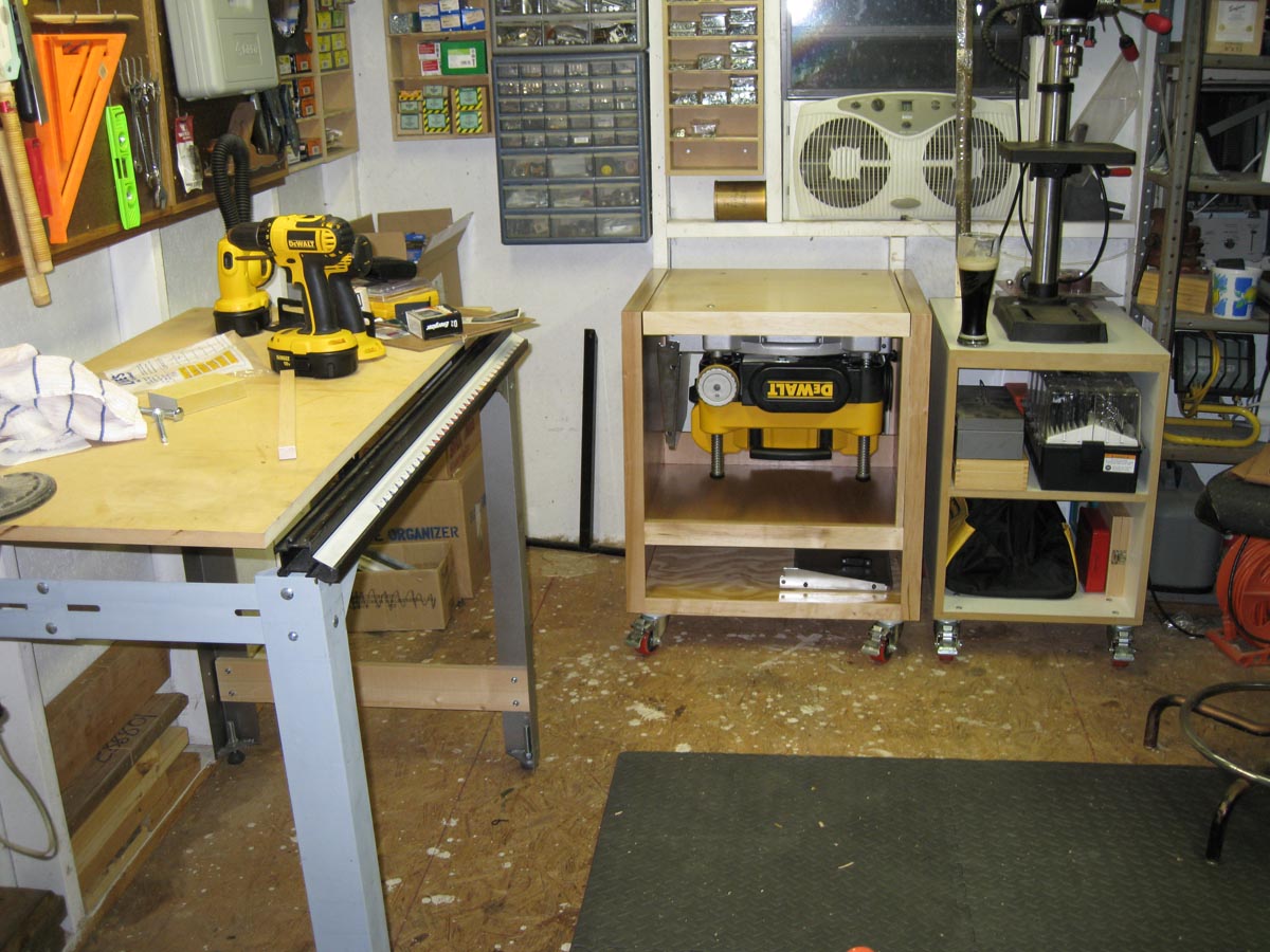

        Very nice indeedy.. Pelligrini. The hitch pins should be fine to lock. Do you get any vibration running stock through with the casters? I suspect not as the over-all weight should counter that, but just curious.
        Looking good...
          Thanks!
          I haven't run the planer yet. I just got the hitch pins in the night before last. Those casters are pretty solid, and if I get three locked in different directions there is no wiggle when forcing it by hand. It would still be a step up from sitting it on my workmate.
          I wanted to give it a try, but it's about 25' from my neighbor's bedroom window. It was 10:00PM and they go to bed at 8:00 sharp. I hate it when I make their bedroom light come back on.
          I was suprised on how easily it is to flip. The handles on the planer are located in good places.
            Very nice! I like that you can park it beneath the bench.

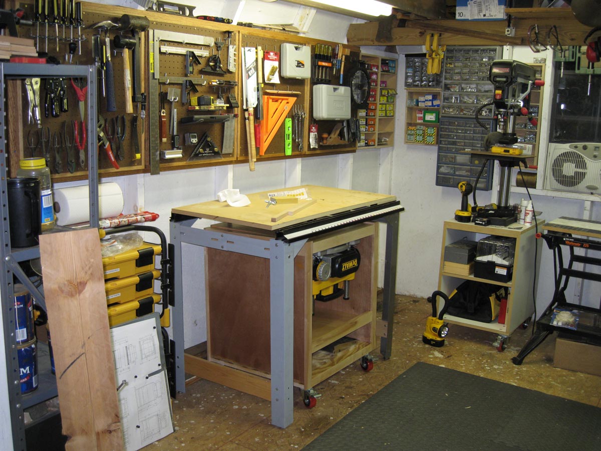

                very nice. Is that a bt3 rail attached to your workbench?
                Time flies like an arrow, Fruit flies like a banana.
                  Yea, it is. Actually, it's two Bt3 leg kits and a MDF top.
                  I plan on turning it into a router table, still keeping it fairly light so I can move it onto my 21929 if I need the extra rail length. It's pretty light for a good workbench. I had to keep moving back and forth to each end when I was planing on the planer stand top. The thiing kept lifting up if I was planing towards the end I was on.

                      The furniture screws and inserts were just one of my ideas for fixing the top. I was exploring something that wouldn't stick out from the sides very far. I think it would have been a PIA to have to fasten it with a hex key, but I was thinking about using them in conjunction with the slide bolts.
                      It's rotating on a solid 1/2" steel rod. The rod bears down on a 1/2" maple board and a 3/4" oak board, another 1/2" maple board covers the holes and holds the rod in place. That makes up the top side rails. The top itself is two pieces of 3/4" birch glued to a 1/2" maple grid. the rod goes through a 1/2" gap in the middle of the grid. The maple grid sticks out an 1/8" beyond the ply to go into 1/8" deep dados for the edge banding, and to give it a little more strength.
                      I did a similar dado for the vertical banding on the 3/4" ply sides. The style pieces also receive the top rails. That ended up being pretty sturdy.
