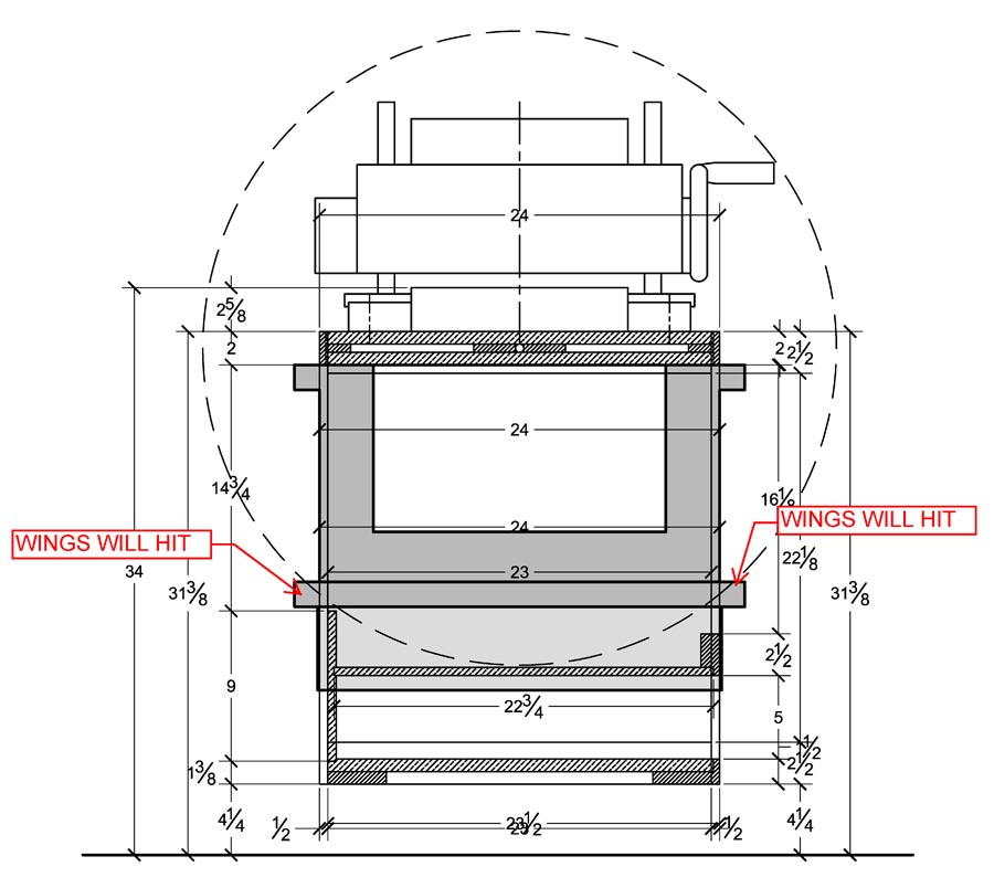

      When I proposed putting the router table on the opposite side, I was thinking of the Skil RAS900 or the Bosch RA1181. I have the Skil table and I don't see any problems whether the router is in place, or not. What am I missing?

          Attached is a section of the cart design with a roughly drawn and shaded RA1181 indicating some possible problems. The skill might fit, but the Bosch won't, especially with the fence in place. The height and size of it won't let it rotate. The cart could be customized to work. You will end up with a small surface area for the router table.
          *edit - The router table could be turned 90 degreed and the cart widened, but your work area will be farther behind than where you could stand.
          I have to lower my 735 to at least 2" for it to rotate. If I leave it up too tall there are clearance problems.

            Thanks for the extra time, Pelligrini. I measured the Skil table. It's very close to the same table height, and the fence would be a problem. The bigger problem is the width. The Skil RA900 is 26 1/2 wide. That means I'd need to turn it, and expand the flip table width by 6 inches. Assuming I would need to remove the fence, I wouldn't need to mount the router table in the center. I could have it closer on the front side.
            I'll need to do a little more thinking and calculating before I commit to this modification to your working design.
