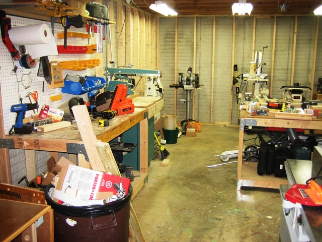

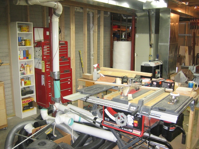

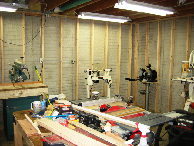

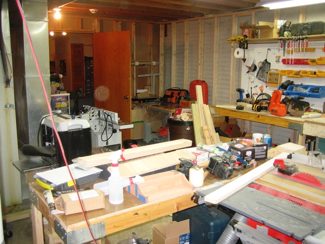

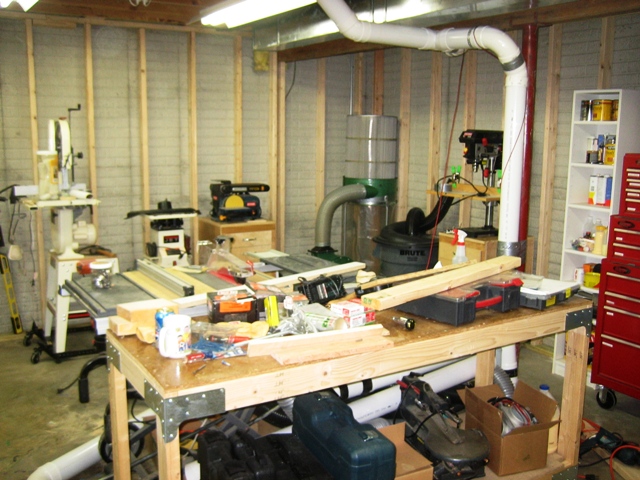

                            Ok, I've spent the last few days framing the walls (still have one section to do behind water heater and furnace.
                            Anyway, here are some pics of roughly how I was planning to set it up (pardon the mess).
                            Points of interest and things to remember:
                            - In its current layout, I have about 7.5' of infeed to the TS when I roll the BS out of the way.
                            - I plan to build a dedicated router table to go between lathe and RAS. The RAS and RT will be at the same height to provide outfeed support for each other
                            - I plan to build new workbench but it will be the same dimensions as the one that is currently there.
                            - I plan on putting the grinder on a cabinet like the DP and Belt/Disk sander so I can tuck it in the corner when I'm not using it.
                            - I need to add lights over by the assembly table
                            - The back and pegboard are coming off the workbench by the RAS this will be replaced with lumber storage racks and new tool storage
                            - I have several places where small cabinets/drawers can be built in or hung. I will do this as time and $$ allow.
                            -When I finish the last two walls and get the old DC piping out of the shop, I will do some experimenting with DC proximity to Jointer, Planer and RT, as others have suggested . Just for reference, all these tools are currently within 15 feet of the DC as the crow flies. I didn't take into consideration the vertical rises/drops.
                            Again thanks for looking

                              • 9503
                              I see from your photos that I am not the only one on this forum that has done workbench construction with Simpson Strong Tie connectors...
                              Makes utility joinery FAST and very strong. But you got to admit it is funky looking...
