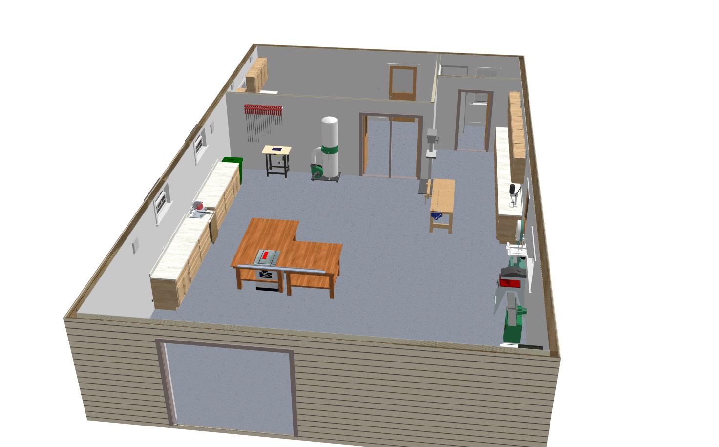

    Shop daydreams... what would you change?
    And then I wake up in my current shop -- with hardly room to walk around the TS.
    One of these days, one of these days.......

    I wasn't EVEN going to the pipe dream territory. That model is FAR from done..

      That looks like a good start.
      Double the lights

        I'd add more task specific lighting and less general lighting. I'd also have more large assembly benches.
          For me just getting a dedicated space that I dont have to share with our cars would be a daydream. I would love to be able to have my BT3 permanently setup with extension tables or heaven forbid one day a 3hp cabinet saw!!
          Also like tom a nice flat assembly table.

            I assume the empty space is office space with computer, drafting dable and all. I would add a finishing area with proper dust control and ventilation.
            As for tools as long as we are day deaming:
            Big lathe
            CNC machine
            Shaper
            Router tables
            More wood storage
            so much for now

              My dream shop will have a floating floor, with 10"-12" of space below the shop floor. This will be MUCH easier on my legs and back, and allow for all DC and electrical to be run in the floor.
              As long as I'm dreaming, it will be on a beach somewhere in the tropics, with very large windows.

                  You should put the bathroom nearer the main entrance. Because you're going to crap every time you walk into that place.
                  Agree on more large assembly tables. And either more tools, or group them closer together, or -- gasp! -- consider reducing the square footage a bit. With the size you have now, and the tooling spread out as shown, you'll walk yourself to death.
                  (This is SketchUp, right? I think I recognize some of the models, like the jointer and Grizzly band saw ... did you draw the others yourself?)

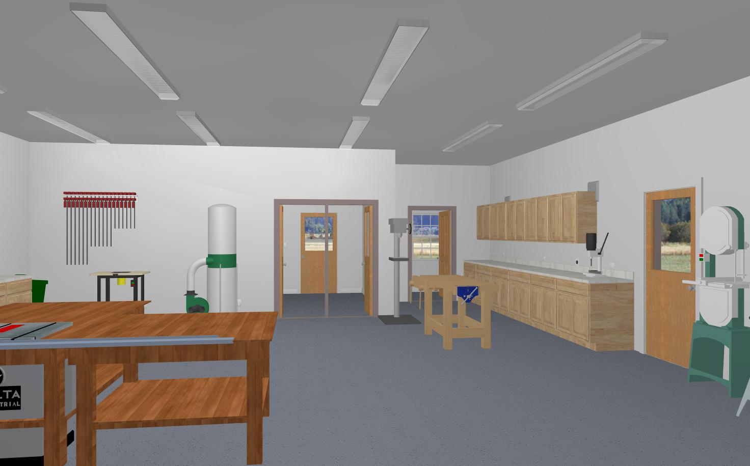

                    Uhhh... 12 each 8-foot long flourescents wouldn't be enough?????
                    There would be raking lights set up in the finishing room also.
                    Nope, it's a finishing area.
                      It is a Better Homes and Gardens software package that allows importing SketchUp 3D models. I jumped on the 3D Warehouse site and grabbed a number of woodworking related items.
                      And no.... I did not draw any of them myself.

                        Seriously, a couple of things come to mind. One is the floating floor, so power can be put under the floor, some one else came up with that. The other thing this would let you do is run dust collection under the floor to things like a cabient saw.
                        Rubber mats in front of everytool would be nice. Our warehouse guys have some that are very very soft, and cumfy on the feet.
                        I would Build a small closet around the dust collector, to remove as much noise as possible from the shop. If I really wanted to go crazy, the closet would have a door to the outside for emptying it, that way the dust stays outside.
                        If you are builing this from scratch, then I would put in tall ceilings. If I had a buck for every scrap in my garage ceiling from flipping long wood, I could buy a powermatic saw. Also Taller ceilings = taller shelves = more storage.
                        How about some sky lights, and a good filtering system on the heating and cooling system.
                        John
                          That's interesting. I'm thinking of going to fewer large benches. Of course my space is about 1/3 the size of Stan's.
