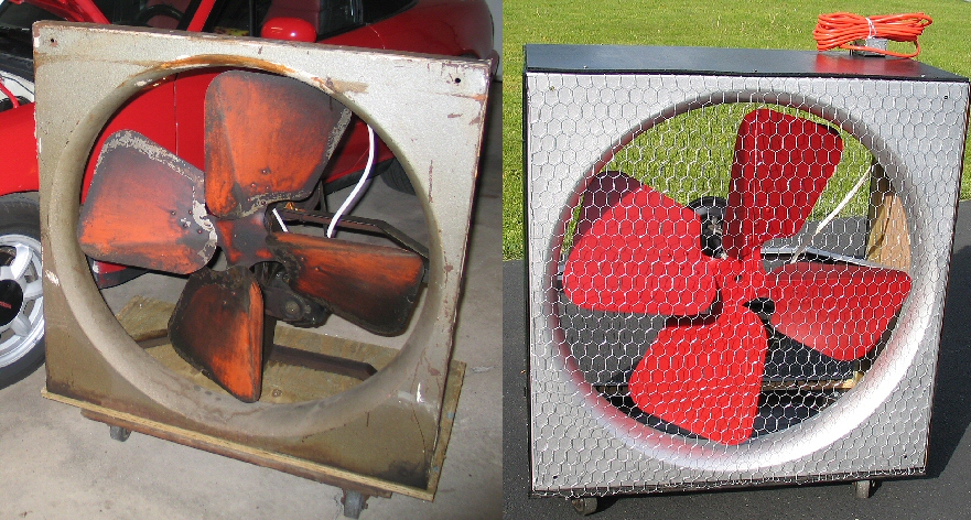

            How about a fan like this......
            I junked it after two years. It was fun to fix it up but not very practical for woodworking or space considerations.
