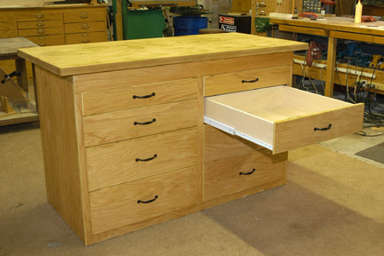

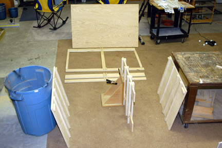

    The cabinet shown below has a minimum of parts, uses a minimum of wood, and goes together very fast. Some of the cabinets shown in the shop tour thread have 500 or more pounds on them, and all are built the same way. I no longer build shelves/doors below the height of the workbench top. Doors and shelves at eye level are fine, but below the top of workbench height holds only drawers. I find that drawers hold twice as much as shelves, and they are easier to find things in. It’s just a personal preference.

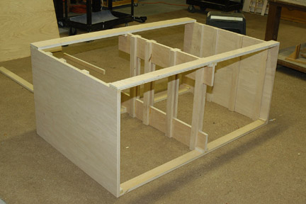

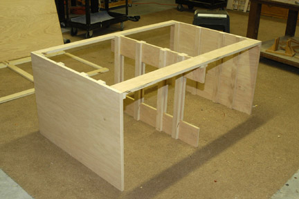

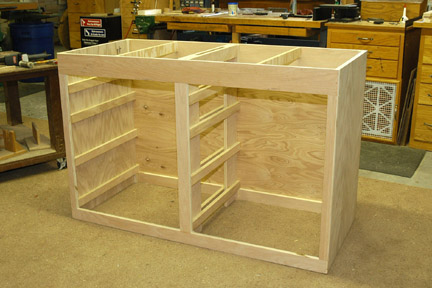

    The construction photos are self explanatory. Just notice the small blocks already mounted to the face frames to center the center drawer supports. Additional small blocks are in place to help hold the horizontal back boards. You can build these cabinets any size you choose, and no drawings are necessary. I use a simple sketch to write sizes on, and start cutting out the parts.

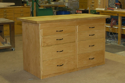

    The first photo shows a finished cabinet, and it does not look too simple to build until you see just the basic parts assembled.
    The back of the cabinet is flush, with small notches in the middle so the horizontal boards can be flat. The plywood face frame parts are added to the front, and then the back is stapled in place flush to the edges and top and bottom. Adding the precut back will square everything up. Stand the cabinet up, use a carpenter square to see that the sides are square to the back before all the glue joints dry.

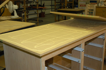

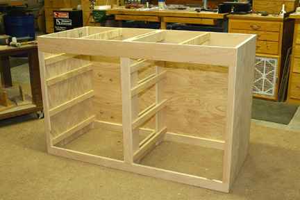

    Part Two
    Notice the extra top supports added to help keep the top from sagging. Normally I have already added the drawer slides before assembly starts except when using full extension slides. (The full extension slides keep sliding out and getting in the way when rolling the carcass over.)

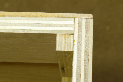

    Photo 2 shows the way the small blocks are nailed/glued in place first to help hold the horizontal stringers. Notice how the back comes right to the edge and top and bottom. The edges of the 1/4” back are are routed over with a 1/4” round-over bit, and the edge of the back seems to disappear. You will never notice it. You could hardly call this joinery, but it is very strong and easy. The first layer of the top is glued and nailed with 2” nails all the way around the edges and middle. The second layer was glued and clamped. The edges are trimmed after the glue dries.
    Simple 1/2" plywood drawers use butt joints and the 1/4” bottom is glued and stapled flush to the bottom. This really keeps the drawers very square and very quick to build. I always use slides that mount on the bottom corners of the drawers because they are so easy to mount. The false fronts are added last. The last photo shows another cabinet built in the same way except that it was mounted on 5” casters to make it easy to move around.

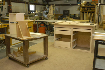

          I wondered why there was no toe-kick until I saw the unit up on its casters. Very nice and beautifully simple. I also like your squring jig for the drawer assembly.
            Ironhat:
            I leave out a toe kick to keep the construction as simple as possible. Having the top overhang 3-4 inches accomplishes the same thing, The one with the casters is a separate workbench. The first one did not need to be portable due to its location.

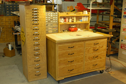

            There are a dozen other cabinets in the photos from my shop tour to demonstrate the how the cabinets can use the same simple construction to build in many variations.
            The "squaring jig" is called an "angle plate" in the machinist trade. It is very useful as a third hand when in the shop.

              As an abject newbie, your posts/pics are absolutely helpful, thanks. The closeups help a lot, eg photo 2 of the 2nd set. Any close-ups of the squaring jig?

                            ]jking: Can you explain what holds the extra top supports. From the picture, it appears these are just butt jointed with maybe some brads or nails. I'm assuming there's something else I'm missing.
                            J: If you are like me you have to read the directions a couple of times before they all make sense. From the first part of the post: I use a 16 gage nail gun with 1.25 -2” nails, and fill the holes with Famowood putty. The only other fasteners used are 1/4" crown x 3/4" long staples to hold the 1/4" plywood back on.
