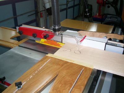

                I always guide the stock on the fence with my hands (wearing leather gloves) till the end of stock reaches about 12" from the blade. Then a push stick is always used.. Always on a rip cut.
                But... it would be impossible to control all rip cuts with a puch stick from beginning to end. The picture I post below will be a prime example. &#37;80 of my rip cuts are with stock more than 6' - 12" long and if you want long stock to get out of control quick, try using a push stick from the beginning on those lenghts that extend beyond the table. And I use supports which is another "ya better" on that lenght cut.
                The key IMO is never get your hands closer than 12" to the blade. But.. but.. even after the push stick is picked up with the right hand still keeping pressue to the stock on the fence to maintain control as you pick it up. And the cut is then completed with the push stick. That requires using a hand to hold the push-stick.
                I persoanlly never move that hand with the push stick in it till the blade stops spinning as I stand left of blade. My saw gets turned of with my left knee to avoid any detraction or taking my eyes off the blade.
                Here's pic that shows why a push stick is not practical until the stock tail reaches the proximity of the blade. This was taken to show a new front table extention I built. If it had been a live cut.. the door would be open and their would be Rigid flip top stands to support the stock beyond the rear extention on this particular rip. You will see why in the pic!
