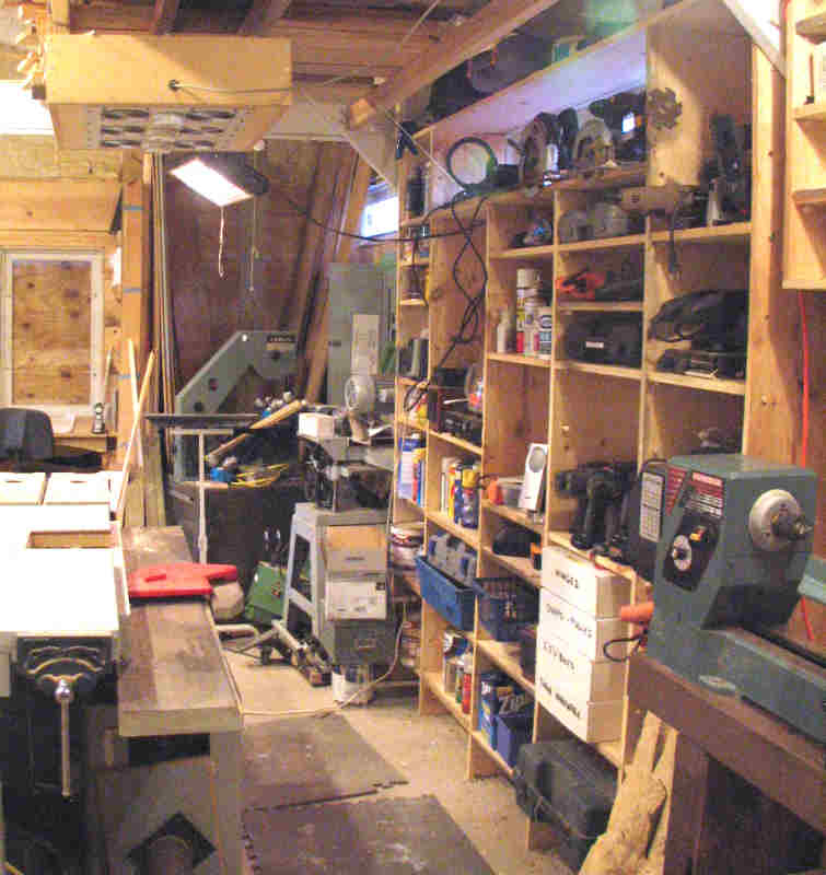

      I'm a bit OCD, but I actually use both. I have enclosed cabinets hung in the shop, and keep most of my tools there, in their cases, if available. Those that I use most often around the shop are kept out of their cases, but I do still transport my tools in their respective cases when I go off-site. I also use a silver Sharpie to mark the cases with what's inside, as many of them otherwise look the same.
        Mine vary. Infrequently used tool are in their cases. Drills are in storage built into the drill press cabinet, routers are in drawers in the router station. Sanders, jig saw, circular saw are on a cabinet shelf.
        If you go with the cubbies llike in the link, either put them behind doors or make sure the inlet to air tools are capped to keep sawdust out.

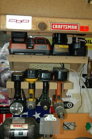

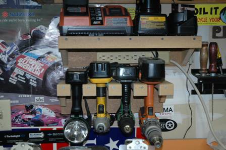

                      Another Option
                      I don't have much space. This option allows me to easily pull them from the holder. The chargers are on a shelf above the the drills, below a cabinet. Made from some scraps in my shop (garage). Pete

                            I think I may just have to steal Pete's idea.
                            Phil
