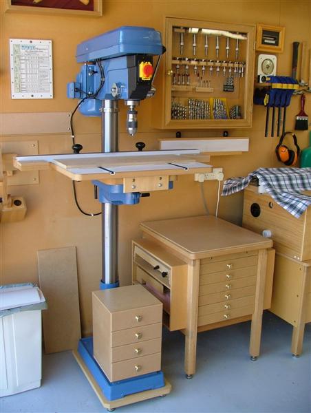

    This is actually my latest acquisition – it replaces my 17 year venerable Bench DP which sat on the stand now on the right of the DP. I was lucky I had enough room to do this – there weren’t any other options. I’m finding the flat top of the stand useful for working on both the DP and Router table.
    I always add drawers, if I can, when I’m locating any new tool – all that empty space (for me), at the bottom of the column… Most of my drawers are lined with corrugated cardboard (ridges across the drawer), helps to stop the contents moving around. I got the cardboard from my local "Pack & Send" store.
    The DP table was also used on the old DP and I discovered the only easy way to attach it was to drill/tap ¼”-20 holes into the front of the OEM table (no holes!), and use a connecting piece of plywood from the 1-1/4” MDF spacer under the table. The spacer is there to allow clearance for the handle which raises/lowers the table.

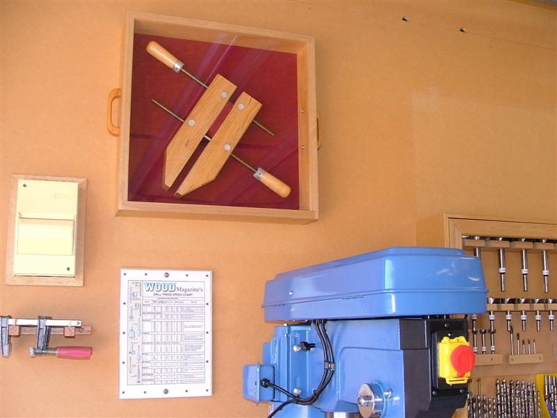

    The large clamp is in the case because it began its life in my old garage where rust was a REAL problem. I’ve only needed it twice in 18 years so it’s easy to leave it there. Not obvious, but I had to move the case up 2” to allow the DP top to open (grrrr).
    The box on the left is my mini powerboard. And of course, WOOD’s excellent speed chart.

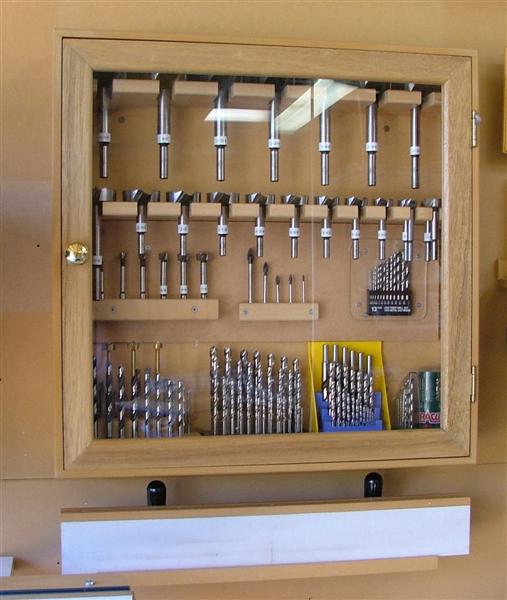

    My Drill bit cabinet contains what you would expect – inch and metric bits, forstners, “spade” bits for glass/ceramics. The “stacked” forstners on the right have an 18mm and 30mm in front of the inch ones. My tall DP fence lives under the cabinet.

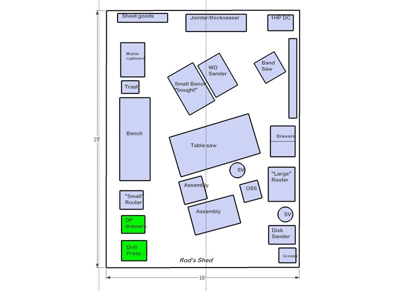

    Edit - Added floor plan - suggestion from Loring - thanks

        Couple of questions about the DP station. Do you have the DP itself on wheels or is that just a simple wood frame with feet you can use to level it?
        Is the small set of drawers on the base easily removable in case you need to work on a tall piece?

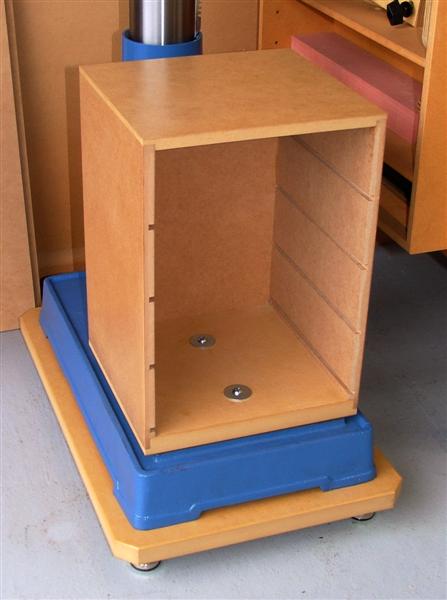

                The OEM base is bolted (2 x 1/2" x 4-1/2" hex head) to my 1" MDF base - 4 x 3/8" levelling feet. NOT designed to roll around, but can be moved readily if needed - the weight stops it from sliding around.
                The drawer cabinet is attached with 2 x 1/4-20 pan head bolts - holes drilled/tapped into the OEM base. 30 seconds to remove it.
                All my wall cabinets are attached with screws.

                      All MDF: The base happens to be 1" - left over from the DP base.
                      Carcase and drawers 1/2", back and drawer bottoms 1/4". And yes, the drawer bottoms are the slides.
                      Note: I had to "lift" the bottom drawer dados to clear the mounting bolts...

                        I think the drawers have bottoms which overhang the sides by 1/4 inch or so (metric equivalent) so the drawer bottom can slide in the dados in the cabinet.
