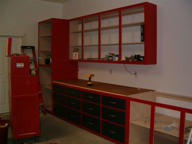

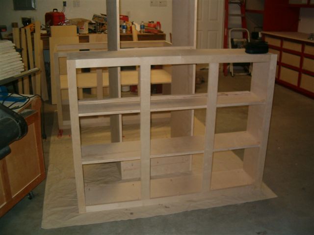

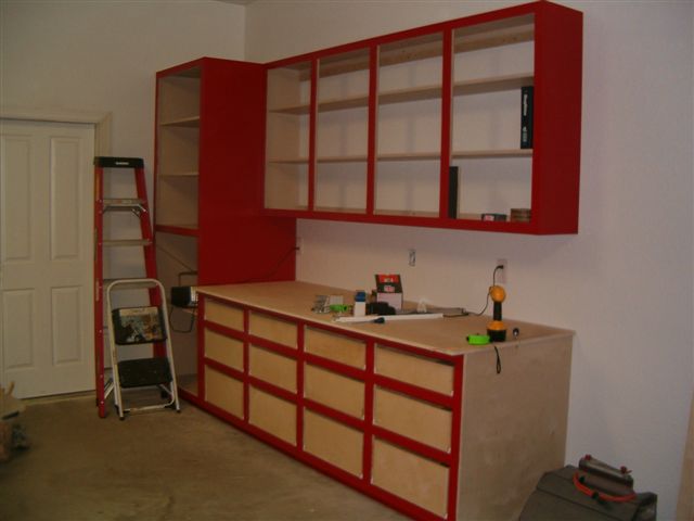

    I recently build my house, it had a three car garage that I will be transforming into the workshop. Here are some of the pics of the cabinets that my wife and I are building for the shop. They are made out of paint grade birch. I will post the progress as it happens. Any suggestions will be greatly appreciated and considered. Thank You

            Loads of storage, which is a very good thing. And it looks like it's nice and bright in there. I do have a couple of suggestions, if you haven't thought of them already.
            Make sure your bench surface comes forward of the drawers by a few inches. This will give you some clamping surface.
            You might want to find a way to add a woodworking vise to the bench. It can be very handy.
            You might want to consider a little shelf at the back of the benchtop. Just a few inches high and maybe six inches deep. This will make a great place for screw bins, parts boxes, battery charger, etc.
            Get more power! You'll want to have access to at least three or four 15/20 amp circuits.
            Good luck and keep the pics coming!
