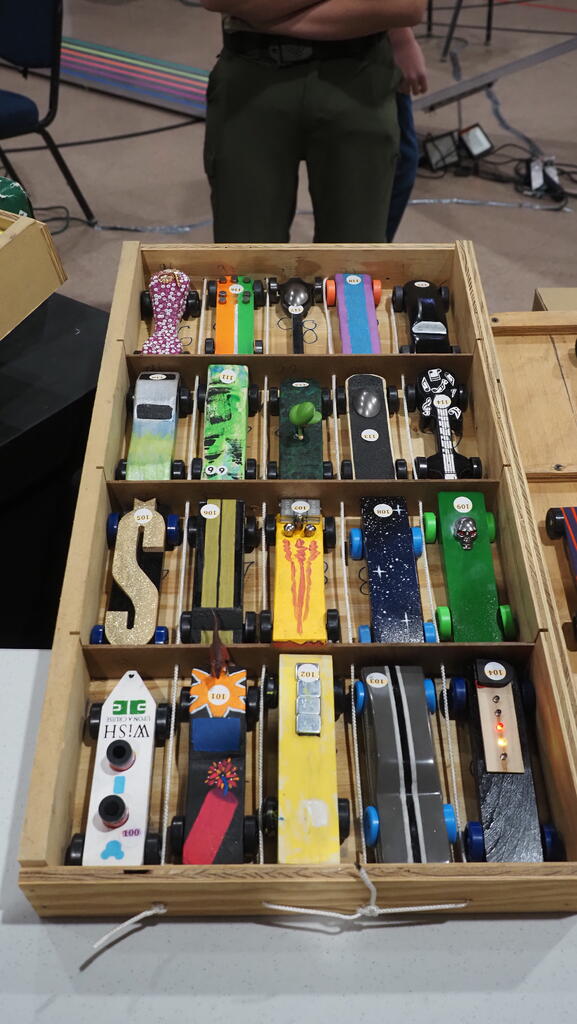

      Here were the "family" entries, you could view them:
      But they were more or less sequestered after checkin (weighing and checking dimensions) which makes sense so that they can't be altered or tampered with.
      So no, I didn't handle or inspect the other cars.
      There are rules but except for the weight and dimensions, I don't think they were strictly checked.
      Specifically, concerning wheels and axles, you are supposed to use the provided wheels and nails from the BSA kits. With no modifications other than mild sanding smoothing and polishing.
      no bearings. Only dry lube like graphite.

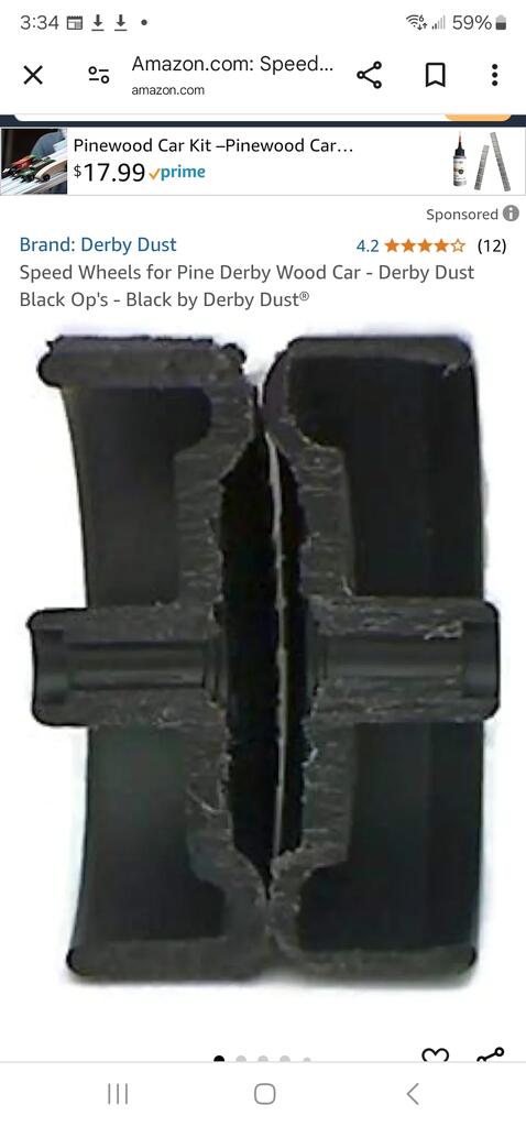

      a lot of people sneak in prepolished grooved axles but as I noted of three I tried, all three looked much worse than the ones I polished in years before. A speed trick is to lathe the official wheels taking off material on the inside leaving the outside unattended but losing half the rotating mass. Expensive to buy. I haven't tried that. Then there's magical lubes, I haven't tried. So someone is beating my legal cars i don't know what they are using.

              I found an experimental result of effect of wheel weight on car performance.
              Click image for larger version  Name:	image.png Views:	0 Size:	106.0 KB ID:	860532
              They took lathed wheels which normally weigh 2.6 grams. lathed down to 1.0 grams.
              Then they added O-rings inside the wheels to weight them back up to 1.9 and 2.9 grams without removing or otherwise messing with the cars.
              Made a consistent difference of 25 and 45 ms..
              I only lost by 6 ms on the last race.
              For those just tuning in, wheel weight makes a theoretical difference because it robs energy to spin the mass of the wheels up to the running speed, that would otherwise go into making the car higher linear velocity.
              PotentialEnergy (start) = Linear kinetic energy + Rotational Kinetic energy + Energy lost to friction
              PE = mgh (mass times height x gravity)
              LKE = 1/2 mV^2
              RKE = f(mass of wheel, rpm, diameter)
              so if PE is fixed (ramp height and mass of car) and friction is fixed,
              then LKE can be increased if RKE is reduced, which gives bigger V.
              The Diameter is prescribed and the RPM is basically based on the speed of the car, so only the mass is under control of the user to lower the RKE
