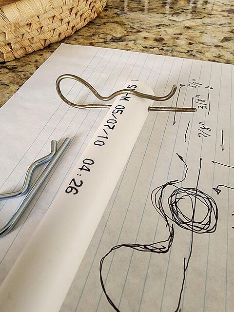

    Wanted a simple clip to hold the 1/4" PVC pipe roller that held the roll of paper.
    Thought of a hitch pin clip mechanical guys use kind of like a spring cotter pin, only more temporary. They are kind of stiff and meant for smaller rods. Thought I would bend one on my wire bending jig. Bigger and not so stiff. Spent 45 minutes and the result was very marginal!
    not one of my better ideas. The small one is from the store, 71 cents. But too small and stiff.
    mine is coathanger wire, stiff enough to be a challenge to bend but not stiff enough for the job. loose, ill fitting, rattles.
    Well, I tried.
    I'm sure they have a machine that stamps these out by the hundreds per minute.

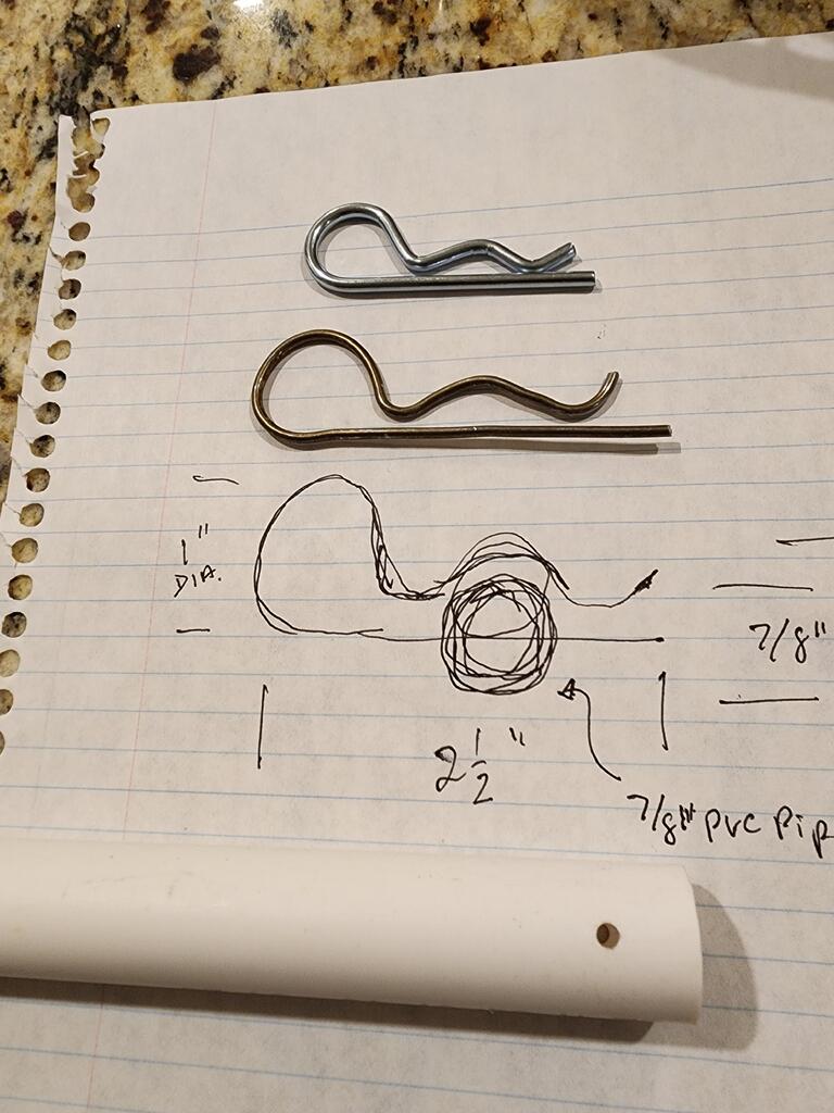

    2nd try.
    Click image for larger version  Name:	20241223_001148.jpg Views:	69 Size:	60.9 KB ID:	860108

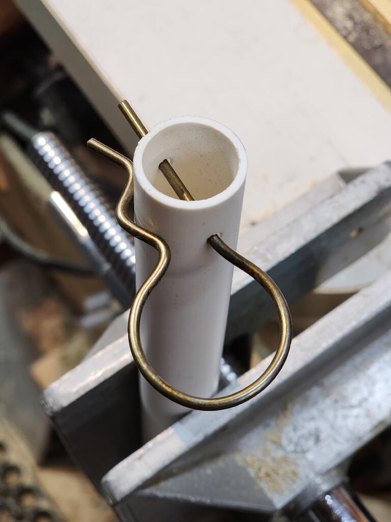

    Fit and spring tension just what I wanted. Not rattling. I needed a 1" diameter cylinder to bend the curve that I could place in a block of wood for leverage... turns out those darn deep 12 point metric sockets are good for something... a 19mm socket OD is 0.995".

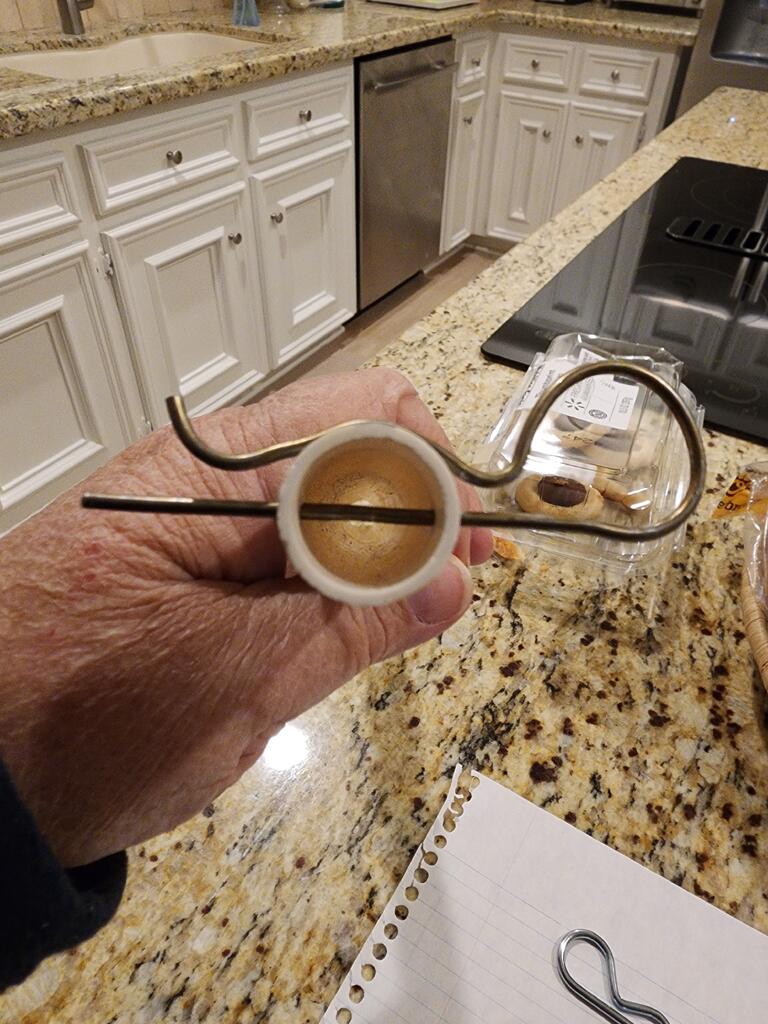

      • 22025
      3rd try only took less than five minutes, after I made a bending jig of the right diameter, and learned to bend the little sawtooth bend first.

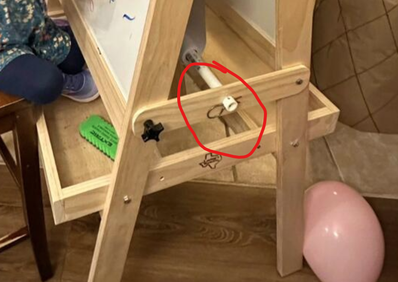

            Here in use.
