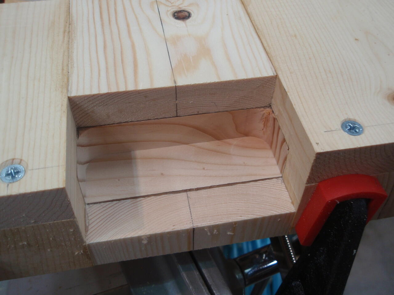

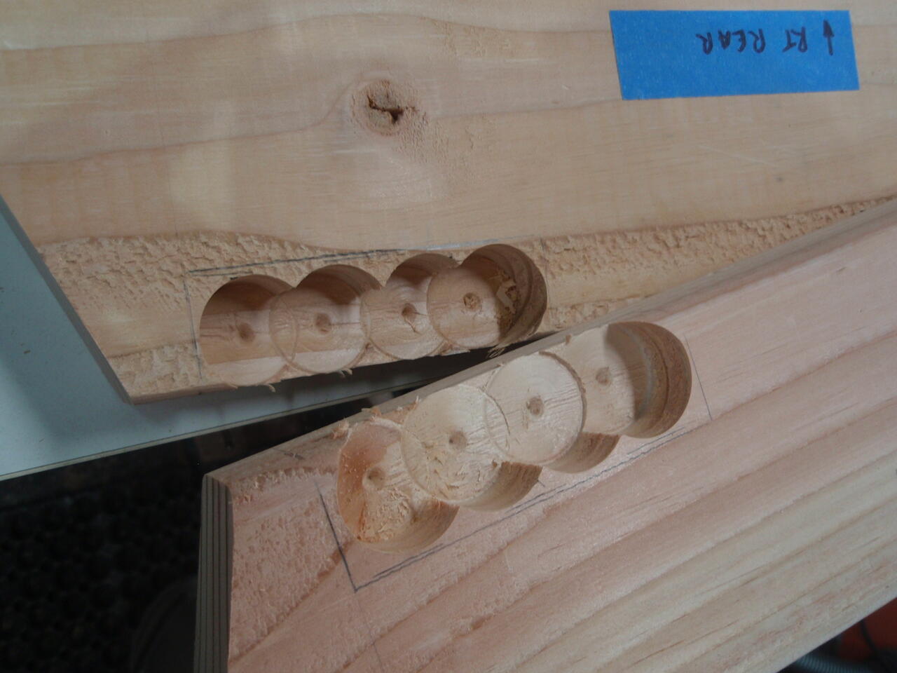

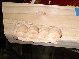

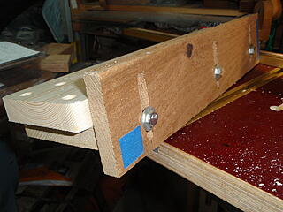

      Needed some 1" x 3/4" x 3.5" notches for half of half-lap mortise - don't know what you call them
      I guess its called a "stopped rabbet". It's really a big version of what you use for door hinge mortises.

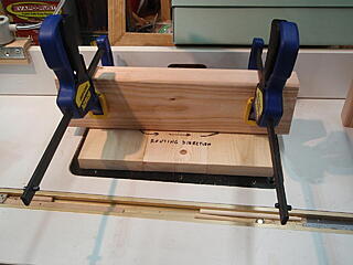

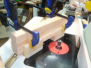

      Made a jig for the router to clean up material removed roughly by drill press.
      Hint, make the center piece of the jig from the same stock you are going to fit in the rabbet and it will fit perfectly.

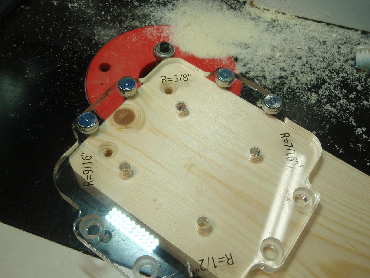

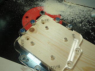

      Use my router corner radius jig and flush trim router bit to put a 3/8" radius corner on it to match the 3/4" diameter corner of the router used to make the stopped rabbet..

        Looks like you have a new corner jig now. I vaguely remember you had made those radius templates earlier.
        LCHIEN commented
        I was going to use my own corner jig but I had not make 3/8" radius corners that I needed to match my 3/4" dia. router bit. So I looked in my bag of tricks and found this one... There's several things I do not like about it after this use... it has two drop in posts on each side but the posts are longer than 3/4" so they don't drop fully into place and don't provide good support to keep the template in place. And worse when the posts drop into and hang up on various holes in my router mounting plate (that never gave me trouble before). I really don't like this jig kit altho it looked good on paper, I regret buying it. Mine's better but I didn't want to spend the time making another sized one at that point.
