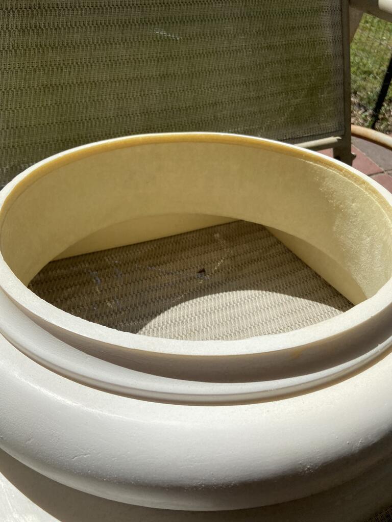

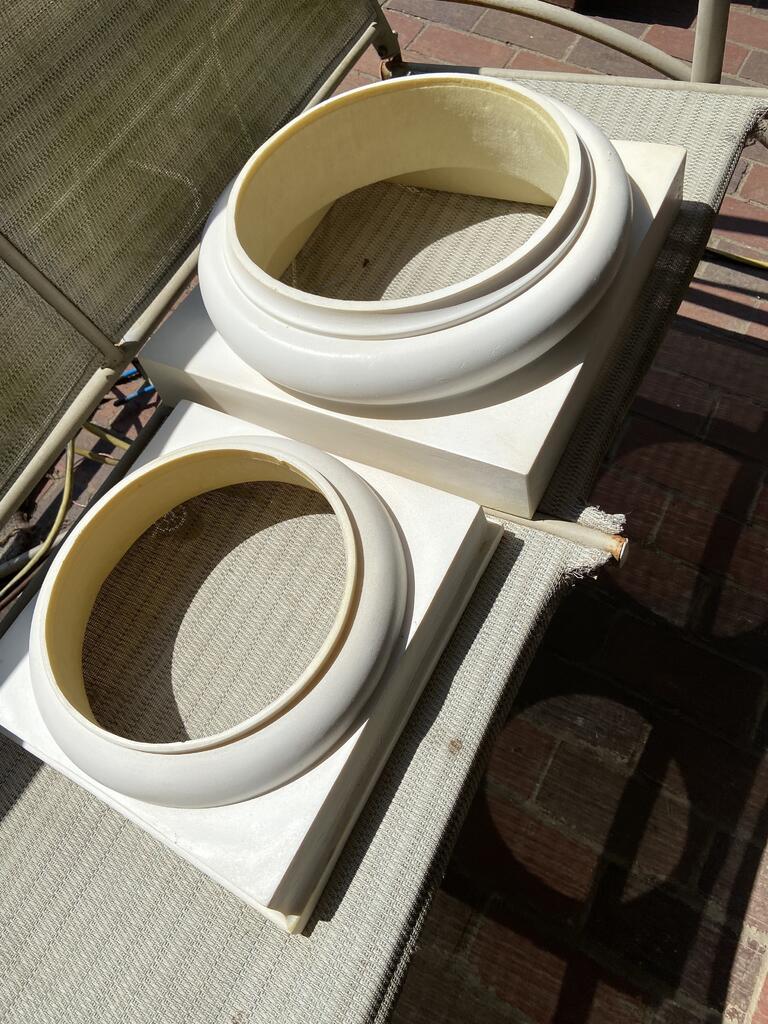

    So 2 months ago, we ordered two more columns with same dimensions as the original 2. The new ones came with bases and with tops. So here are pictures of them (Below the pictures I have questions for you):
    Click image for larger version  Name:	Column Base.jpg Views:	0 Size:	92.4 KB ID:	851608 Click image for larger version  Name:	Column T&B base.jpg Views:	0 Size:	144.5 KB ID:	851609
    We are not able to order replacement appointments for the first two columns. I started to make copies out of wood but figured it would be too heavy, and I was afraid to turn something that large out of wood on my lathe. The large one is 16" square, the small one is 14" square. The small one is 5 inches high, the large one is 8" high. The holes in the center are 12" and 10"
    MY SECOND thoughts was /is to make them out of some kind of styrofoam. This is where I need your help. The above is a dense styrofoam covered with a hard shell of some kind of paint or epoxy paint. I need a Styrofoam without open pores, if that makes sense. If it is dense enough styrofoam, I can turn it on my Grizzly lathe, as I "can" turn 18" if needed. I can slow the lathe down to just under 600 RPM.
    1. WHAT Kind of foam do I look for and where can I find it?
    2. What kind of hard finish can I put on it that won't eat up the styrofoam, AND be weather proof?
    Any help would be appreciated. I don't want to make 2 of each out of wood.

      Order two more sets? No, I asked if I could and was told they come only with the columns. Two new fiberglass columns with bases and tops like those shown would run $900.00.
      I considered making a cast but did not want to get into plaster casts that have to be made in two parts. But I may have to do that. I will check HD tomorrow while I'm there for the EPS.
      If I had some dense foam, I could turn it easily. Shaping it to specs is not a problem for me. Just need to spray some kind of hardener on the outside or fiberglass it.

        As far as foam, not sure what you could use, XPS, Styrofoam, take your pick, XPS would probably be more stable over the long run. As far as surface coating, it really should be fiberglassed using epoxy resin. The regular polyester resin will simply eat styrofoam, XPS, etc...
        The problem with that foam is it WILL degrade over time, especially when exposed to heating / cooling cycles. If you can manage it, I would still consider making the capital (the topper of the column) from wood. Too bad there isn't a local rent a monster lathe shop...
          leehljp commented
          Thanks for the suggestion. I may have to do that. I have pressure treated wood for it because it will be used outside. I had planned on doing that then decided to look for foam.
          dbhost
          commented
          I get it, if it is a base, not a capitol, you might be able to use the foam to create a sand mod for concrete casting?
          Thinking out loud here and all....
        • 3791
        Use one of the bases to create a mold, fill the mold with reinforced concrete, make as many as you need.
