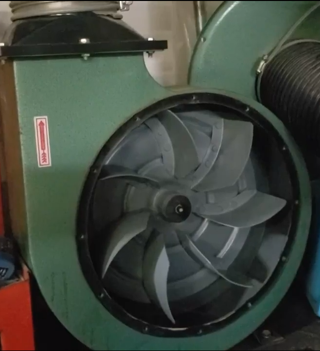

      So I figure a pictoral representation of hte work that has been done in the shop since I started this thread, I will try to compress pics for multiple proejcts if possible...
      I know I have shown the Wynn filter and the neutral vane is going to be VERY hard to photograph, but here is teh Wen impeller during the install process. The install went super easy and was well worth the few bucks and little bit of time it took. What a HUGE difference in dust collector performance. No it is not in ClearVue territory but it picks up where the prior setup left a lot behind...

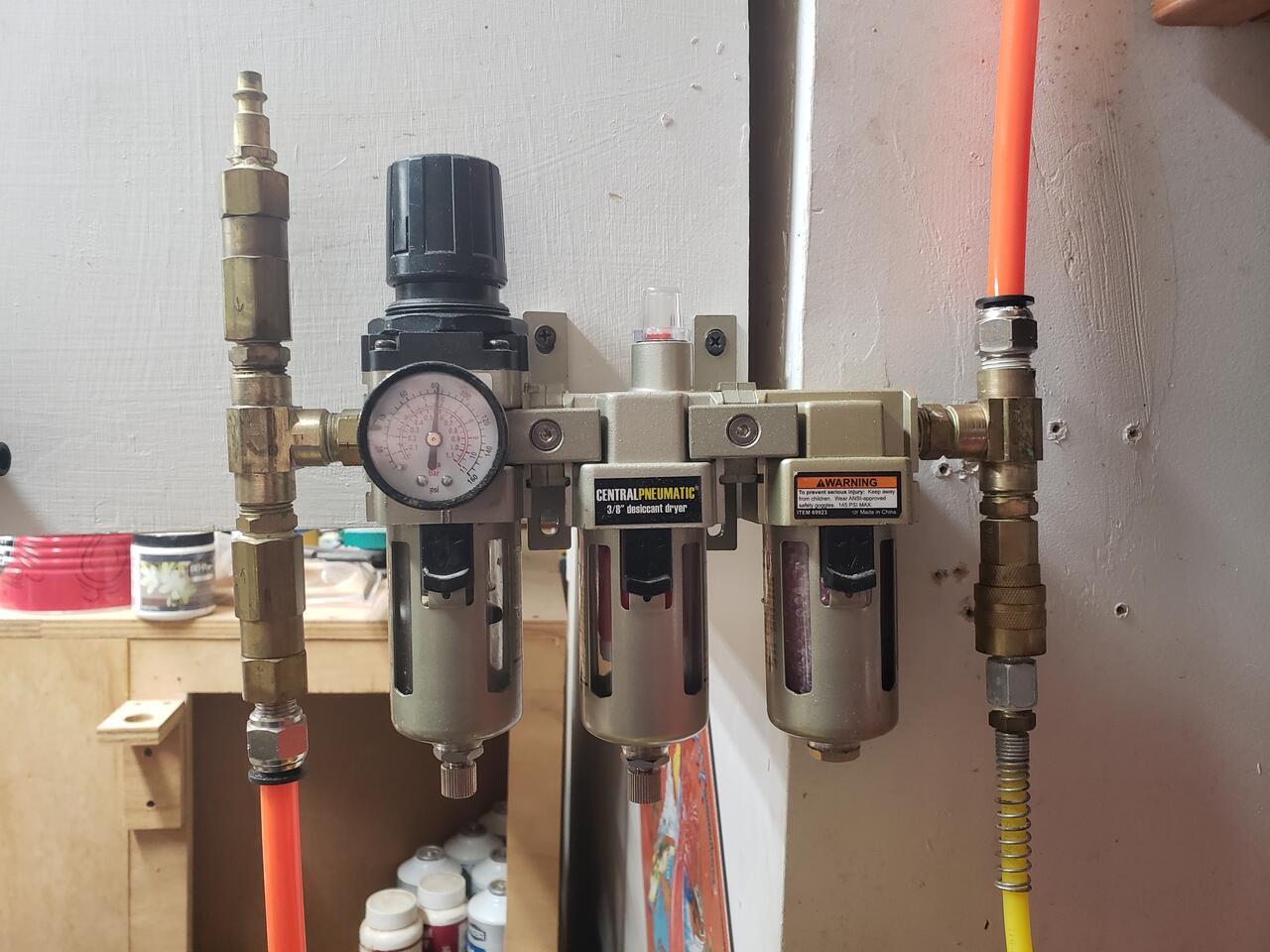

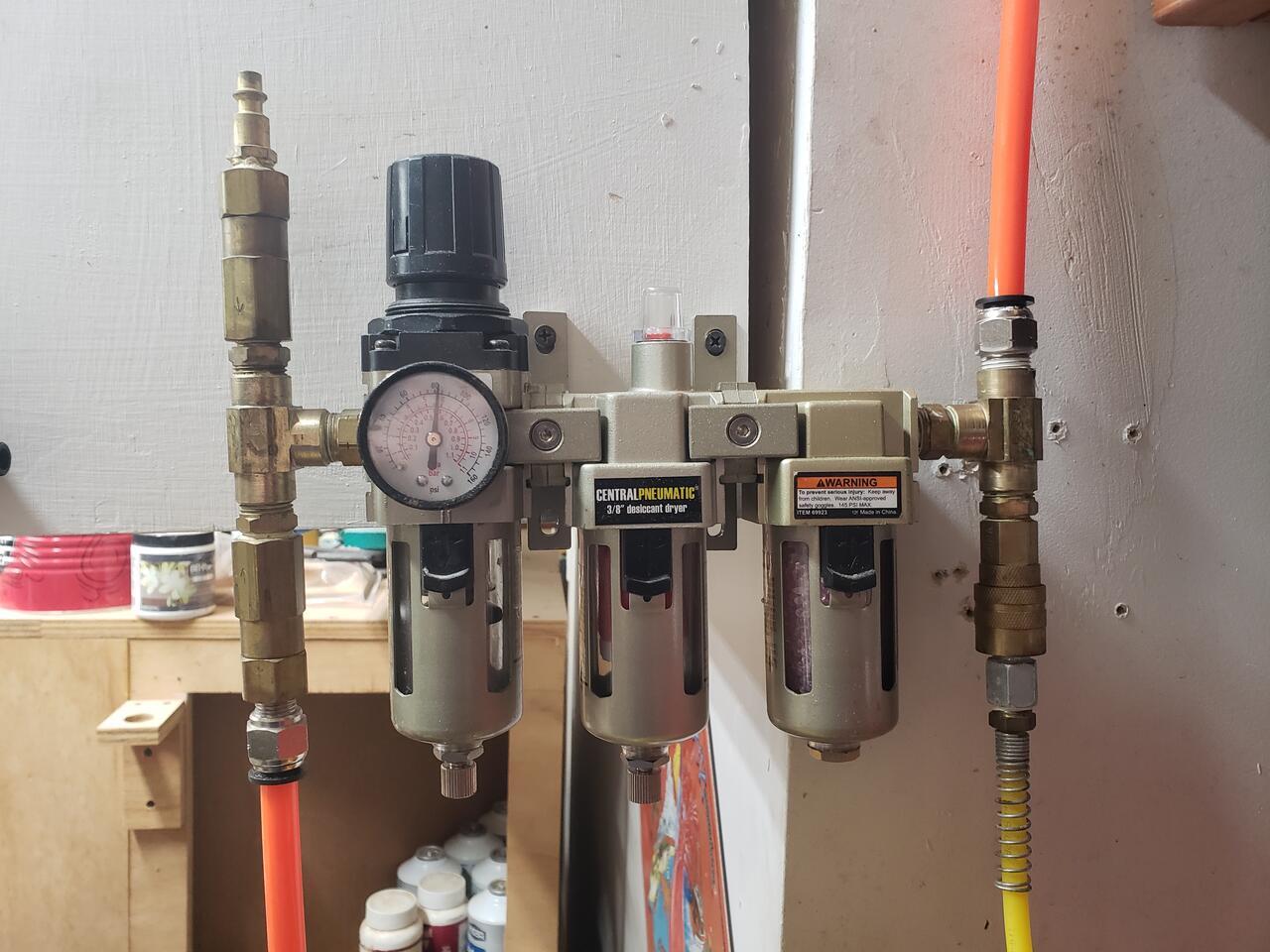

      The compressed air system piping, 3/8" ID fitting upgrade and repair to the Central Pneumatic filter / regulator This was a well worth it upgrade.

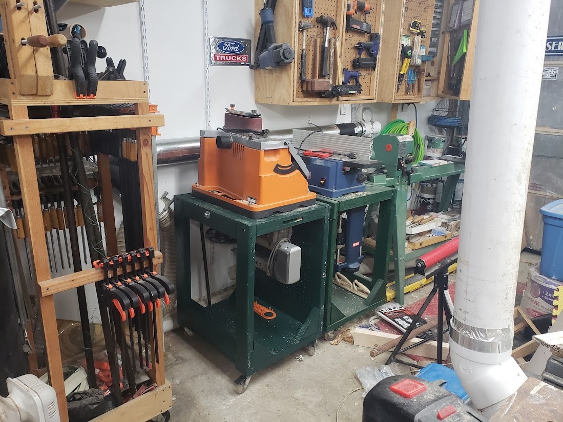

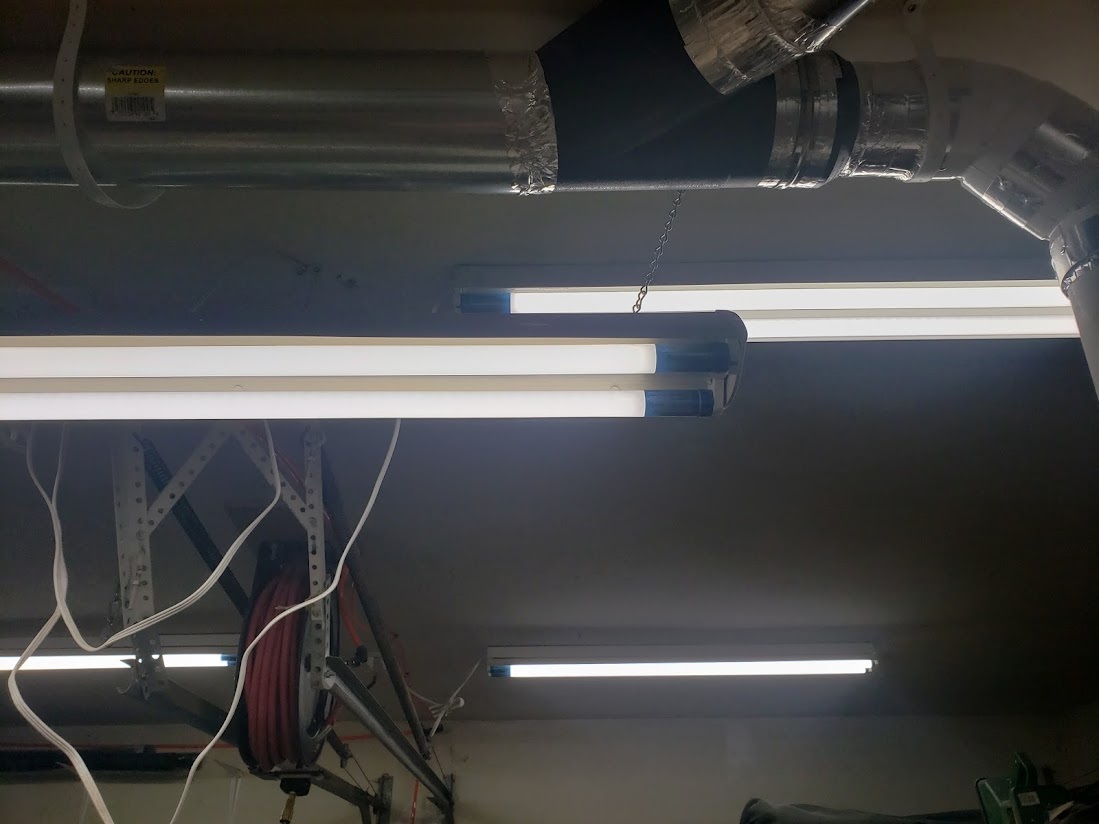

      I also converted all of the formerly T12 flourescent fixtures to LED ballast bypass tubes.
      Also a larger project was the conversion from 4" dual runs to a single 5" main and 4" drops, this is resulting in a much better running system. Not sure how much of that is due to the Wen impeller or removal of the 55 gallon side inlet Thien separator though..

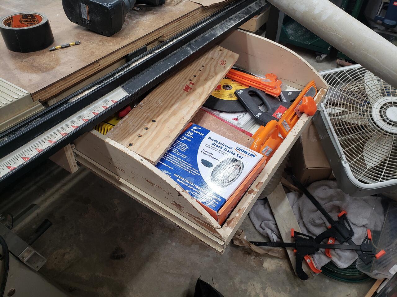

      I resized to fit one of my sister in laws pullout spice drawers after she had to redo her kitchen due to Hurricane Harvey, this went under the extension wing of the BT3100 and serves to house my table saw accessories, jigs, and safety items like push blocks etc...

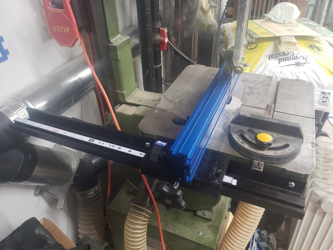

      The band saw recieved its long awaited upgrades. out went the Cool Blocks, in went the Accura roller bearing guides for a MUCH smoother and more stable operation. The upper guide holder for the Accura that houses the micro adjuster for the thrust bearing did NOT fit the Central Machinery band saw, but the yoke that holds the side bearings is a direct fit replacement for the yoke that holds the blocks, so that is how I handled the upper guide. Lower was a direct drop in. The MLCS safety power switch was installed and located on the post, which happened to be drilled perfectly for the mounting screws. I sacrificed an outdoor extension cord to get a sufficient cord for the task at hand. The lower factory dust port was replaced with a larger Jet 2.5" port, and an additional 2.5" port was added to the lower shroud, urethane tires were added but not pictured here, and of course the Kreg Precision Fence has been installed and tested...
      Of course the previous mods of the G0555 tensioner, riser block, wheel brush etc... are still there...

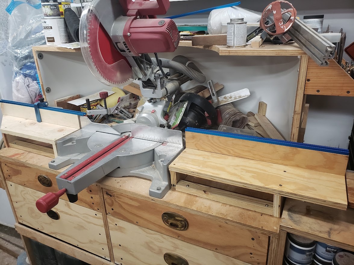

      The drawers and support tables / production stop rig for the miter saw bench / mortiser bench has been done, and now in use...
