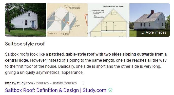

    I had to lookup saltbox style roof:
Name:	salybox style roof.JPG
      • 9560
      Saltbox is the best definition I can come up with. Figure the roof of the short side is extended so that it creates a covered outdoor area next to the building...
      The idea is to stay within the 200sq / ft limit for not needing permits, and providing weather protected space for the DC and Air Compressor...
      Saltbox might not be the right word exactly, but it is as close as I can come up with..
