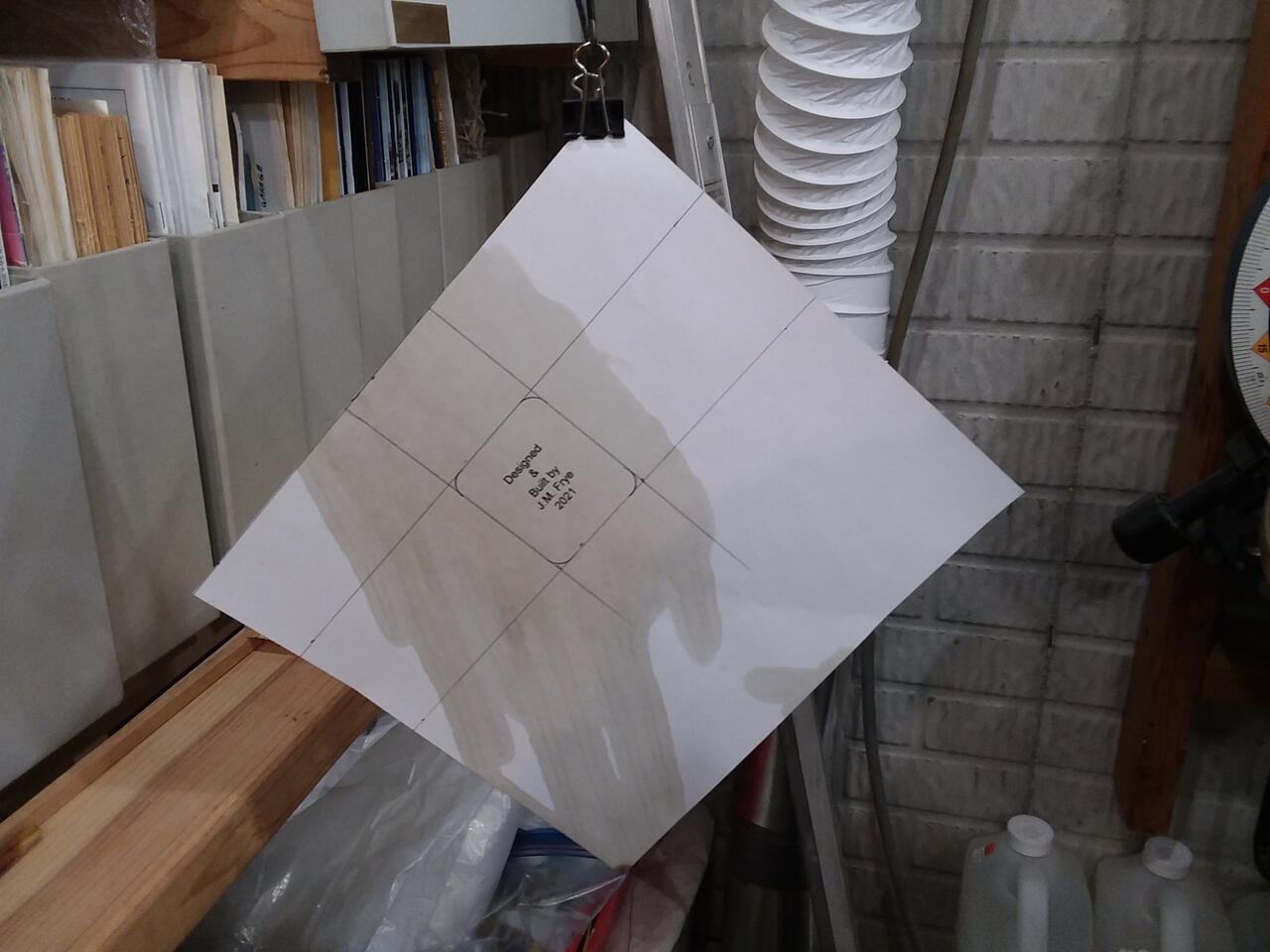

    Not Bourbon, but label. Awhile back a question was asked how I mark something I make. I described the way I label things now and thought I'd post a couple of pictures of the process. I print the label using the ink jet printer on our computer and then soak both sides of the sheet of paper with thinned varnish. It then gets hung up to cure. I do just text, but you could add artwork, or images if you wanted. When dry, the paper is like very thin plastic (I use 20# paper). The varnish turns the paper somewhat translucent, yellowed, and you could spray the back side with some white paint to make the label opaque if you wanted. I cut the label out and glue it onto the inside, bottom, or back of the piece. Then the label gets finished over with the regular varnish finish. The result is a permanent label to identify who is responsible for the piece. The one in the pictures is about 1 1/2"x2" and is affixed to the inside rear of the side table I'm making for our living room. Click image for larger version

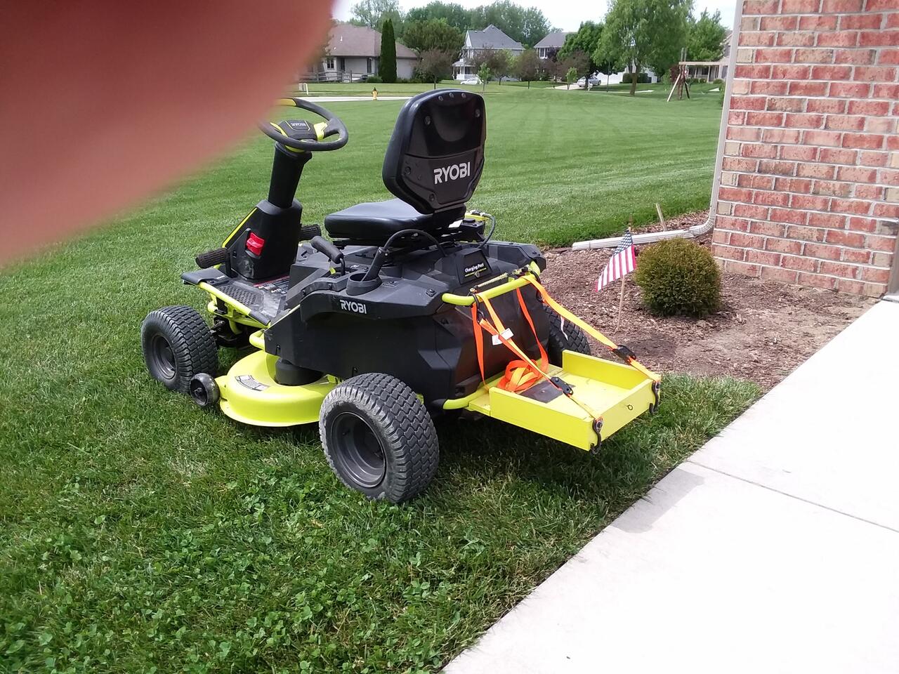

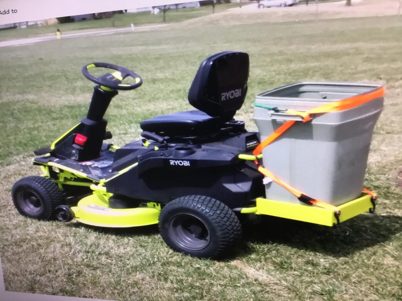

            Here's another example of this method. I made a folding tailgate for my riding lawn mower and decided it needed some labeling like a pickup truck tailgate. I copied the taillights from a Toyota Tundra truck off of a Google search and the logo from the front of the mower. After sizing the images and printing them out, I applied the varnish and painted the backs with white spray paint. I then glued the logo and fake taillights onto the back of the tailgate and sprayed everything with clear coat. Just a bit of whimsy from my twisted mind.
