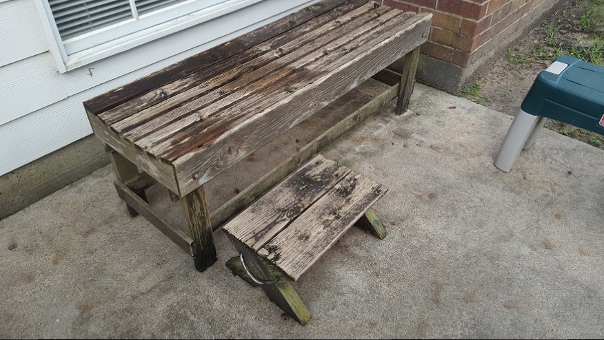

                    Originally posted by dbhost
                    Not a bad idea. I need bench slats. I can do 3/4 I believe, but I figured Cedar wouldn't be up to supporting multiple people on a bench. Particularly if they are heavy...
                    I used them for bench slats (and fence boards are down to 5/8" or even 9/16" now) - supported every 12-18" they hold me (210 lbs) fine.
                    It was made in 2012 I think.
                    Stool has 5/8" top, also, supported by a single 2x4 running crosswise..2013.
